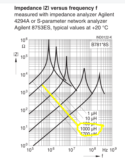

the standard practice for rating Inductance is where L drops 10% at max rated current. So permeability and current saturation effects are included. But I agree they can be more lossy with rising F at high current.
In this question, the current limits were not at risk until you suggest using a smaller load resistor.
~fini~
https://www.digikey.com/product-detail/en/B78108S1105J/495-5550-2-ND/652579
Epcos example with 1mH, DSR=20
Every part has expected Series Resonant Frequency (SRF) which rises with lower L values.
Standard linear parts.

read post #1. Even he knew
tried with 1 kOhm and 2 kOhm resistors too.
It seems that the gap between theoretical/real frequency narrows as R gets bigger.

Hello there,
In short, a simulation will never match real world measurements unless a more accurate inductor model is used in the simulation, and even then it's hard to pin down perfectly.
An air core inductor would be better for use for study here, at least to start.
Here is some more information about this...
This is a simple problem when the inductor is linear, for example with an additional series resistor R1 and calling the inductors internal series resistance Rs, the voltages across R1 and the physical inductor are equal when the following equality is satisfied:
w^2*L^2+Rs^2=R1^2
