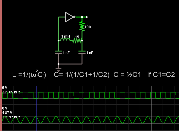

I calculate LC of 10uH 10nF to match my sim output of 712kHz
and reduced linear amp gain to 0.9 to prevent saturation near ground.
I simulated this in LTSpice, L=10uF C1=C2=10nF using 74HCU04 as inverter, frequency ~ 225kHz and the second harmonic measured from input pin was about 0.3% and from output pin about 3%
I see your problem , no big deal, you said 10uF but meant 100uH which yields 225kHz
You incorrectly identified the classic design as an electronic multi-vibrator
I said it looked like a multi-vibrator. I never insisted it absolutely was a multi-vibrator. I later corrected myself and called it a switching oscillator which both oscillators are. But that begs the question. How can you say the caps are in series when I showed that they are energized in parallel by the gate, and only connected to one point (ground)? Why are not the caps separated by a inductor in a power supply considered in series also.
The sine wave is very clean but the Simulation time sampling gives quantization effects which can be reduced by reducing the sample time.
in Options > other options but then unlike digital scope this has less memory. For better slew rate , I edited the gate to be faster below.
I changed one cap to pullup and one to ground to speed up the startup DC bias.. Same f results as Vcc to ground ~0 Ohms impedance
Good to know it has a nice sine wave.

The correct analysis for the Kirchoff KCL equations for loop current are that the two caps are in series which together form a parallel LC resonant circuit. ( high impedance)
This also correctly predicts the frequency exactly as shown in both the Falstad and Vspice sim.

This LC parallel resonant oscillator uses the PI (shaped) filter (as you know) with an equiv value of two series caps with Ceq= 1/2C when both C's are equal. The phase is inverted 180deg twice ( once by 2nd order filter and once by inverting amplifier (CMOS logic)) making a positive feedback loop also with excess gain to square up sine feedback input.
All Logic IC's have analog properties in this discussion, so we do NOT refer to them as "switches" as you have done, which might be relevant for a more logical discussion on logic.
Your mention of this as a Switched Oscillator is illogical. It reminds me of an old TV guy who once had 500m$ in public stock on his company Del Secur based on his "analogic" understanding of electronics and 2D fingerprints. When I reviewed his design and theory, I found it fundamentally flawed. Within a year his company stock was worthless as stock traders discovered the same thing that his pretense was incorrect and he had no un-hackable security solution. there is no such thing as "analogic" as he used it.
Why argue against fundamental oscillator theory when you know you are wrong by deflecting the issue with irrelevant info . this is fallacious.

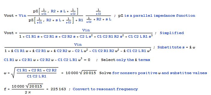

When you suggest 2 parallel caps rather than the correct perspective of 2 in series you imply results must be wrong.
Your calculations include choke DCR term C2R2 where R2 =15, which can obviously be neglected from the beginning using R1=10k in this LC high Q impedance.
your results reduce to
which is identical to mine ( ah the one with the series cap formula ) which you denied several times
Actually your results now prove I was correct all along. Thank you.
Not the results, the wrong perspective. If the caps were in series, then you could combine them into one cap. You can't, so they are not.
The calculated frequencies for choke resistance values of 0,15,73 ohms are 225079, 225163, and 225518.
which is identical to mine ( ah the one with the series cap formula ) which you denied several times.
Actually my results do nothing of the kind. Where would you put the combined series cap Cs? Those caps are distributed in parallel and cannot be thought of as being in series.

Ratchit. If R1 ( I assume it is 10k ) is zero, the circuit still works in LTSpice, but your formula gives infinite frequency.
A choke with DCR=0 also implies infinite current into a Cap with ESR=0 with a driver with ESR=RdsOn=0 which is impossible.
Since this design is fairly intolerance to R2 for low DCR values but in order to maintain a high Q, R1 must also be high then the DCR is easily neglected and R1 has insignificant effect as the R1 terms cancel out. as I indicated .
It is the ESR of the driver that makes your Simulator and actual hardware work if R1=0, but this is not recommended design.
No problem, the formula is correct. The simulator probably includes the output resistance of the inverter, whereas I do not. Therefore, even if you set R1=0 in the simulator, the output resistance is still there. Find the resonant frequency with R1 = 0, and you can calculate what value the simulator uses for the output resistance of the inverter. If I set R1=2 in the formula, I get 490548 hz for the frequency.
