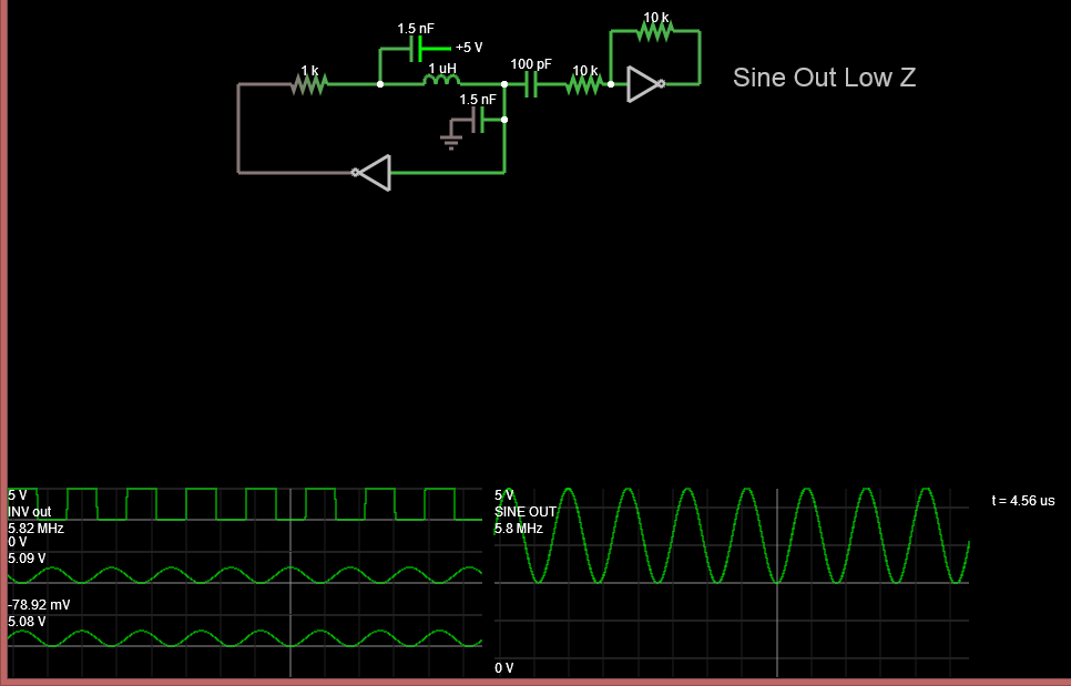

I see I need to correct your false assumptions.
1) it is not an Op Amp, rather a logic gate
2) it is not a series resonant circuit.
It is a parallel resonant circuit with series caps.
Thanks for pointing out my typo
ω²=1 / (LC)
L = 1 / (ω²C)
L = 1 / {(2πf)²C}

1. OP Amp ? Not , never
as Op Amp as I had shown at that f.
Op Amps are integrators (1/f response) and not broadband linear CMOS amplifiers with high gain (10 per stage of 3) at 10Mhz
- thus useless for high f oscillators for measuring LC resonance
2. electronic multi-vibrator ? Not , never
It is not a relaxation oscillator or "multi-vibrator" or "astable".
It is a linear resonant circuit amplifier up the point until output saturates into a square wave since the gain at resonance is >>1 with Barkhousen criteria satisfied for oscillation. So there is a sine wave output feedback after the bandpass parallel filter with 180 phase shift and the logic inverter is 180 phase shift resulting in 360 deg loop phase at resonance. The inductor self biases input DC for 50% duty cycle. this is a "101" oscillator circuit design
3. parallel caps on supply? series? no not never
this is an obvious error in your implied critical comments. They are shorted at each end,
This design has an inductor between each cap. ( which has equal magnitude of impedance at resonance)
Allow me to redraw for you to understand.
https://www.falstad.com/circuit/circuitjs.html?cct=$+16+5.000000000000001e-11+10.20027730826997+50+5+43 r+160+512+288+512+0+1000 w+288+512+288+544+0 c+352+544+288+544+0+1.5e-9+-0.4342750419355297 l+288+512+400+512+0+0.000001+-0.07080797846745183 c+400+544+352+544+0+1.5e-9+4.571412541865394 w+400+512+400+544+0 I+400+592+160+592+0+0.5 g+352+544+352+560+0 w+400+544+400+592+0 w+160+512+160+592+0 o+9+64+0+298+5+0.0015625+0+-1 o+8+64+0+290+5+0.00009765625+1+-1
moreover if you analyze the above link and press RESET, you can see the startup performance for DC self-bias, Step Input broad-band noise, resonant output which is amplified in a linear fashion when Vcc/2 or 2.5V is reached and then operates in pure linear mode until saturation of output.
This is identical with all Pierce Crystal Oscillators
https://en.wikipedia.org/wiki/Pierce_oscillator
capiche?
The linear aspects of a logic gate are easily misunderstood. Gain is fixed below to unity gain by 1:1 R ratio added to above oscillator to make a "sine wave buffer" ,
In LC resonator the feedback gain it is affected by Q ratio. = R/X(f)

Functionally speaking, it is a overdriven inverting amplifier, even if an Op-Amp is not capable of reaching those frequencies.
By any other name, it looks like a pulsed Colpitts oscillator. The output, when using a gate, looks like a rounded triangular wave, not a nice sine wave.

Ratch , your comments are incorrect or irrelevant.
1. Functionally speaking, it is a overdriven inverting amplifier,
This would imply external input.
This is a resonant oscillator not a multi-vibrator
I stand by my comments, No Not never.
Your arguments deflect your errors and conflict with general wisdom of experienced designers.
Fallacious at best.
Again you make fallacious irrelevant comparisons to deflect admitting your errors.
The Colpits Osc. is not what I demonstrated . That design uses non-inverting amplifier.
i.e. 180 phase inverted amplifier is used for Pierce Osc.
When saturated output with high gain, it is also the common uC PIC square wave clock with external reactive element such as LC, crystal or tuning fork.
a Colpitts or a Multi-vibrator
No, not! , never

How does all this relate to the capacitors being in series when the topology shows them to be connected in parallel.
How come the output does not look like a nice sine wave. Instead it looks like a rounded triangle wave.
What does 5 volts on the 1.5 nf capacitor do for anything?

Dear Hopeless;
-granted there are similarities, but the Colpitts is in-phase and the Pierce is anti-phase.
-big difference
Neither above is called https://en.wikipedia.org/wiki/Multivibrator
There is no rounded triangle in my simulation.
Only a slew rated limited square wave , which can be edited at will.
I will go with that.
I never called a Colpitts a multi-vibrator. I believe I changed the name of your circuit to a switching oscillator in a previous post. A multi-vibrator is a type of switching oscillator.
It just does not look like a good sine wave. Hopefully, the real circuit does.

You incorrectly identified the classic design as an electronic multi-vibrator
The sine wave is very clean but the Simulation time sampling gives quantization effects which can be reduced by reducing the sample time. in Options > other options but then unlike digital scope this has less memory. For better slew rate , I edited the gate to be faster below.
I changed one cap to pullup and one to ground to speed up the startup DC bias.. Same f results as Vcc to ground ~0 Ohms impedance
Ratch
I simulated this in LTSpice, L=10ouH C1=C2=10nF using 74HCU04 as inverter, frequency ~ 225kHz and the second harmonic measured from input pin was about 0.3% and from output pin about 3%
Edit: corrected the value of L
Not bad, thanks for the confirmation jjw.
I think Q affects harmonic rejection and THD with the values selected.
As stated the design was a starting place for measure L.
For improved THD, Q can be increased and linear gain adjusted.
There are subtle differences with U04 types and Buffered types with spurious potential with overtones, but 3 stages of gain can extend range of operation for low Q inductor tests. U type is recommended for crystals but often Buffered (B) types work well too.
