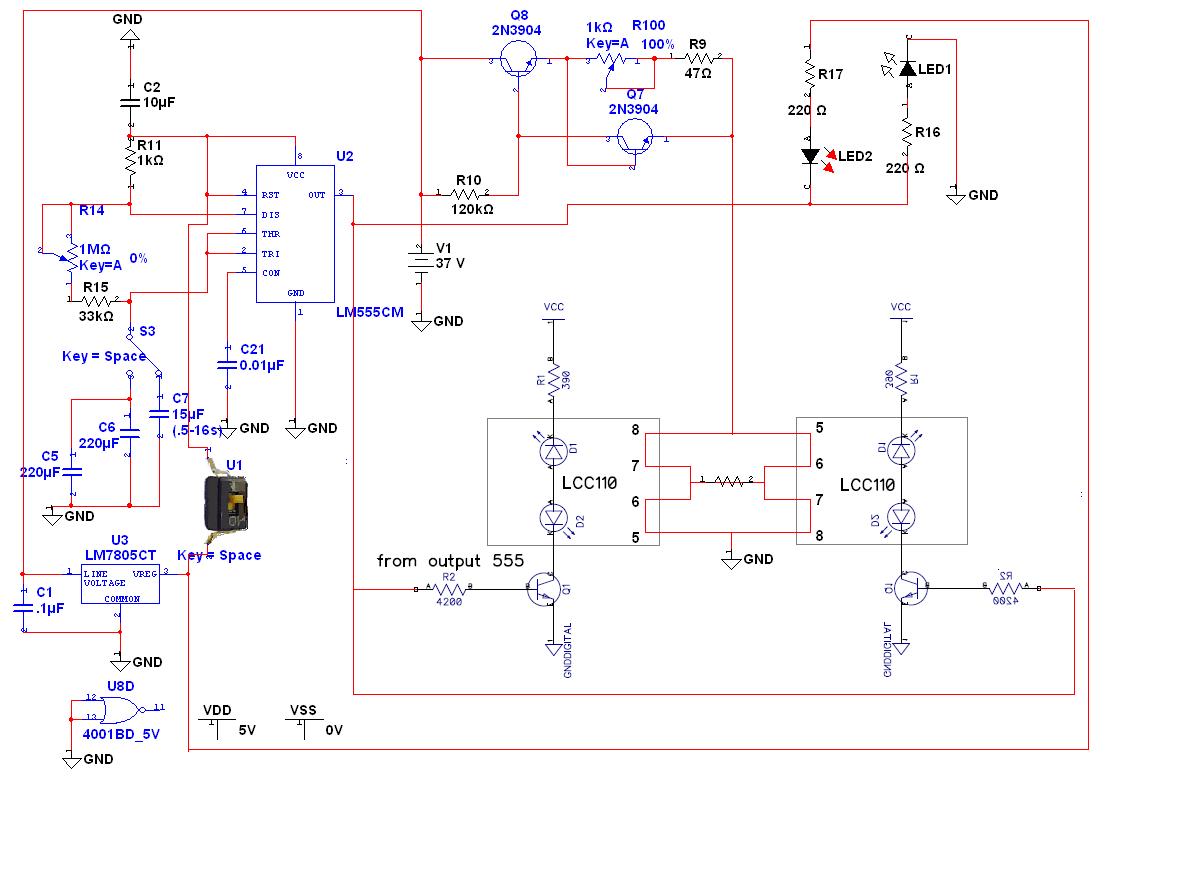

KISS,
I have a couple of Questions:
1. It is correct of me to assume that the Resistor in the middle of the H-Bridge is only for simulation and will be removed in the actuall circuit? (i.e. Resistor comes out and each end becomes the connections to the Silver Electrods.)
2. The Resistor and Potentiomater used to adjust the Current, will still be correct values to adjust simular results when attached to the Silve Electrods. (i.e. Adjust the Current between 1ma and about 10ma or so.)
3. I am not sure that I understod your drawing as you intended, but I attached a mock-up of what I thought you ment. (Please fogive my Ignorance...)
Best Regards,
BHinote

BH,
The resistor represents the resistance of your solution. The current source can only maintain constant current as long as there is enough voltage and low enough resistance for it to maintain the set current. There is a certain amount of overhead in the current source above and below which it can't regulate. The transistors perform the same function as the regulator in your first circuit except the regulator became unstable ( Oscillated) when the current was below it's minimum. I'll run you a simulation of them both.
1. Yes
2. Yes
3. My fault too. Migraine day.
Remove the right hand transistor, one LED and both resistors.
Remove one LED from the left side of your drawing.
LED1 will never turn on. On your other drawings you had an inverter which is needed
To drive LED1.
The idea is to have the LEDs in the LCC110's in series with the bands toward ground.
One LED belongs inside one LCC110 (pins 2 & 3 from memory)
and the other LED in my drawing belongs in the other LCC110.
My schematic is WRONG in the sense D1 needs to be turned
180 degrees.
The 74HCT05 replaced the transistor and 1 resistor.
The added resistor to +5 converted the OPEN drain inverter to. a conventional
Inverter.
We can do the drive and LEDs with a ULN2003 which is a very common part and a resistor.

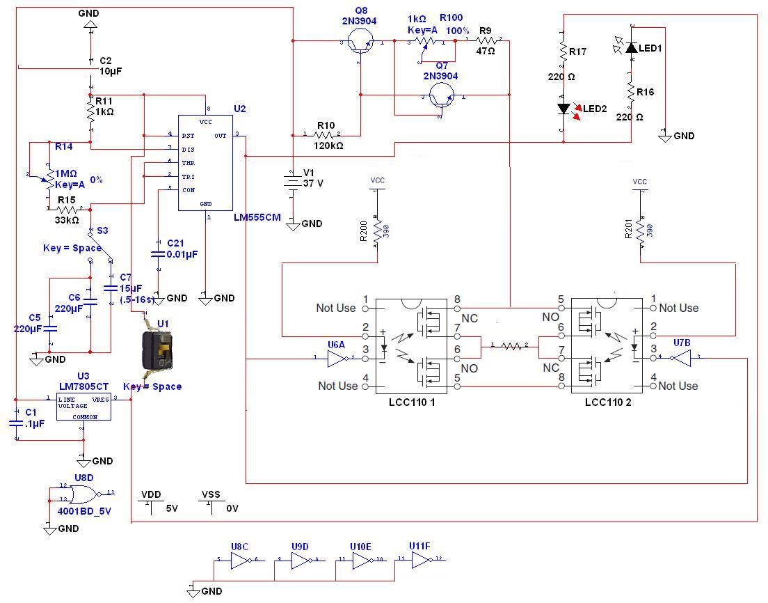

Sorry to hear about the Migraine. Hopefully this does not intensify it... ;)
I understood most of what you were indicating, but not all. Sorry...
1. You indicated the LED arrangement I setup to indicate Left or Right electrode was Positive, would not work. (OK, the simulation seemed to like it, but who am I to contradict this with an expert. Answer: Nobody...)
2. I believe you indicated that the two LEDs in you LCC110 box actually represented to two sides of the H-Bridge, so I believe the attached drawing addresses this.
3. You indicated the 74HCT05 would replace the transistor and 1 resistor, but I did not see these on your latest upload, so I looked back at your prior upload and believe that I changed it accordingly... I Think...
4. Added resistor to +5 converted the OPEN drain inverter to a conventional inverter. (I am not sure what this means, but again I tried to combine both of your drawings into the one I am uploading now.
Please let me know if I am close to what you were saying or simple missed the boat...

BH,

Your close.
Pin 5/8 of the LCC110 has to go to ground.
Usually an IC with multiple gates use U1a, U1b, U1c etc. U1 is the IC # and a-f are the 6 parts.
Gates depending on the family have different characteristics especially asymetric source
And sink current. LED's should not see a reverse voltage although 7 V. is usually OK.
Sink current is usually higher. Circut would be virtually the same except for pin numbers.
There are 7 drivers in the ULN2003 and 6 in the 74HCT05.
Can you upload a pic of the LCC110 that you embedded in your drawing?
If you use a 74HCT05 it HAS to be surface mount. If we use a ULN2003 it can be a DIP
Package. Your choice.
So basically the inverters need to only SINK current rather than source it to drive LEDs and relays.
The ULN20003 is a 7 relay driver with an interesting property. If an input is unconnected, the "relay" is off. I've used this part a lot.
Layout can change a design. E.g It might be easier to route and extra gate and resistor because resistors can jump tracks.
The scanned scribble I did had LED indicator drivers (3 gates and a resistor). It had. 2 gates and 2 resistors for the LCC110 which can be simplified to 1 gate and 1 resistor.

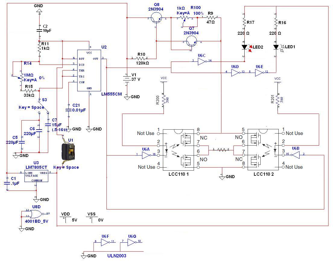

KISS,
If I understood you comments, is this what you were sugesting?
I am unable to sumulate this design with Multisim, so it would be untested.
BHinote
I'm about an hour away from home now.
Your close.
Sorry for the confusion. I tried to download LTSpiceIV today and got an error: This is not a WIN32 application.
I may be back at this in an hour, although it's bedtime.

Ronv,
Please find attached the latest copy of the Schematic.
I probably will at a ON/Off switch for the entire circuit and make adjustments to the Left and Right LEDs. However do you see any other issues.
Best Regards,
BHinote

Looks like it should work.
Good luck!
