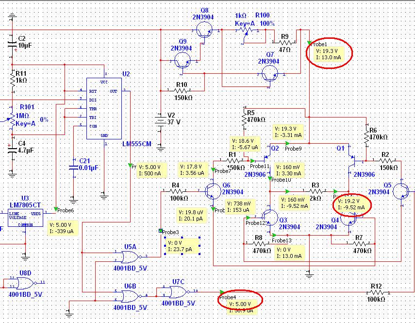

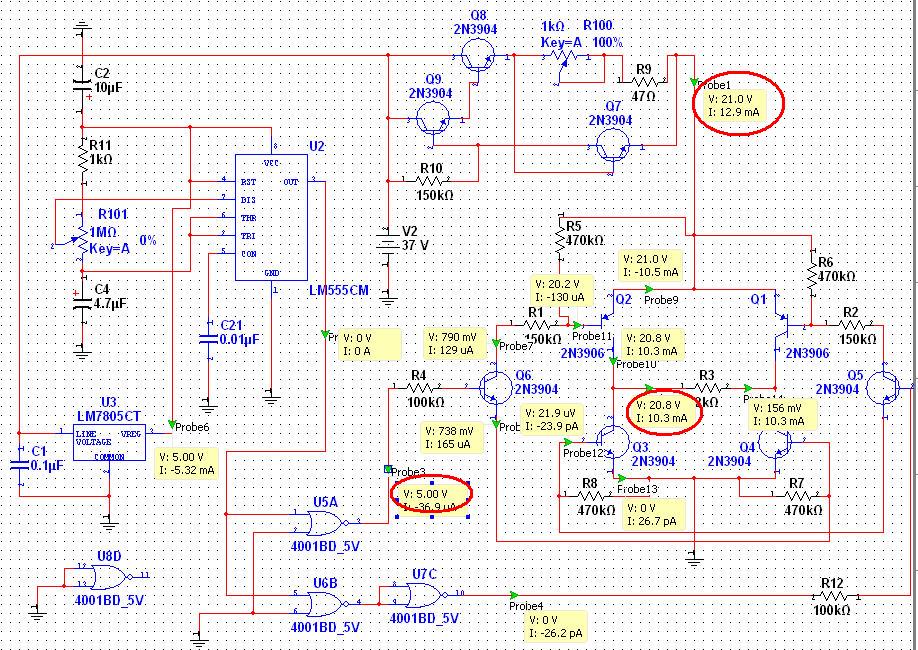

I know you were leaving, but I thought I would post this just in case or for when you get back. :)
I have attached to images of the circuit running at around 13mAs. (One with the left side active and the other with the right.)
Anyway my question is why does the left Show 21V/12.9mA @ the Source and 20.8V/10.3mA near R3, while the Right Show 19.3V/13mA @ the Source and 19.2V/9.52mA near R3? (i.e. Lower Voltage and Current in all cases.) I suspect Real Lift situations are not going to be 100% identical, because of tolerances, but is it truly possible that the simulation is faking this difference yet showing the same results for each side... When I see this I start looking for a incorrect value or some type of weird wiring issue...
Just checking...
BHInote

BH,
I'm sorry, I also tied the left 3904 to the output of the 7895 and the right 3904 to ground instead of to the 4001 IC. this lets you see the values. But when I hooked them back up it looked like the 555 was not running, but I am new with the scope.
Look under simulation, interactive simulation settings. Both minimum time step and stop time are there.
