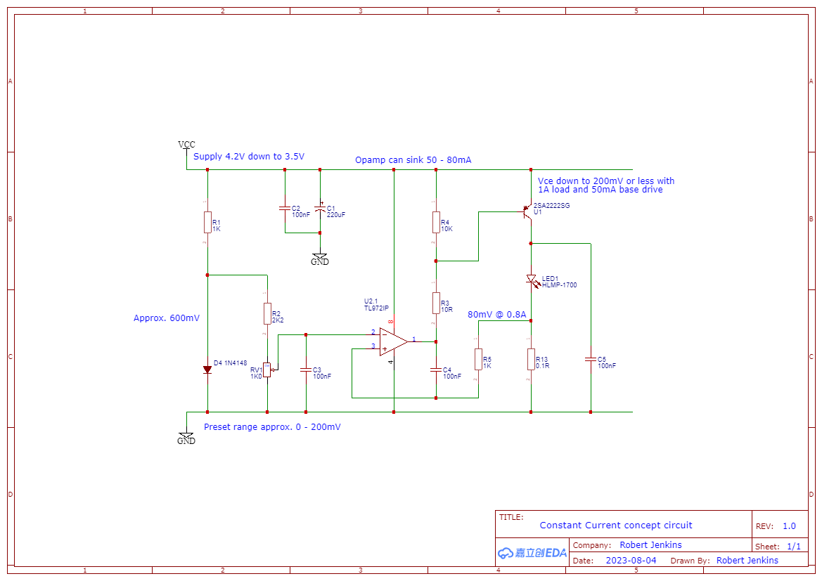

Concept:
PNP transistor, emitter to battery V+, collector to laser diode +.
Laser diode - to low value sense resistor, to 0V.
A low voltage opamp such as a TL9721 comparing the voltage across the sense resistor (+ in) to a preset with series resistor (- in) connected across a diode (biased via another resistor to V+) to give an adjustable low reference, probably in the 0.1 to possibly 0.2V range.
Opamp output to the transistor base via an appropriate limiting resistor, also a base-emitter resistor to guarantee full shut off.
It would likely need filtering or slew rate limiting for stability, but I think with an appropriate sense resistor to get ~100mV at the required current, a very low drop-out voltage should be possible.

This should probably work, looking at the component specs?
C4 & R5 will probably need adjusting for optimum response and stability over the working voltage range. R3 possibly linked out & R4 removed.
Umm. it's interesting.. But i was thinking about a configuration with a TL431 instead an unstable zener diode for temperature changes. And an NPN like D882 instead a Mosfet. Have you tryied it? Is the same configuration??
No zener, it's a 1N4148 signal diode, used to give around 0.6V
If it were thermally connected to the laser heatsink it could give some thermal compensation?
You could use a voltage reference with an appropriately adjusted divider to still give a suitable reference voltage range to the opamp.
I'd go for a 1.25V type or thereabouts, so there is less variation in bias current over the battery voltage range.
A P-channel MOSFET could work provided it's ON resistance is low enough at around 3V gate-source voltage.
They are difficult to find in conventional packages for prototyping, while the device I chose has high gains and is quite cheap, in an easy to use TO-220 package.

The two-transistor version is not capable of giving a really low voltage loss, as the sense resistor must have the lower transistor base-emitter voltage across it to work.
A germanium one would reduce it to possibly 0.3V at that point.
R1 would need to be around 100 Ohms or possibly less, to ensure Q2 conducted sufficiently, with the KSD1691 and a low battery.
