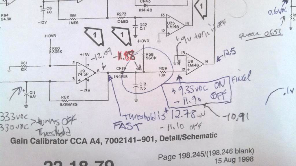

RC time, using a Stop Watch, RC time is longer in time is the capacitor bad?
What would be on channel#1 to trigger off of? the output pin of U9?
The way I did it was
Channel#1 was the Input pin of U8
Channel#2 was the Output pin of U8
External Trigger was the output pin of U9
I used a Digital Storage Scope
Using the external trigger on the output pin of U9, does what? it helps sync what?
Pretty much what I mentioned when I said:
Channel 1 vertical to the junction of your R58 and C13 RC network and Channel 2 to the output of U8 pin 14.
You can look at the junction of R58 & C13 or you can look at pin 12 of U9, same thing. The 10K input resistor matters not.
Using a 2 channel scope I would, as mentioned, use external triggering so I could observe the slope of the capacitor charging and U8 changing output states. Using a 4 channel scope I would do it as I mentioned and just run my trigger signal into channel 1 and use channels 2&3 to see what I have an interest in. Either way the event we want to trigger off of that starts things going is when U9 pin 6 goes high. All of that should be clear in the image I posted.
The output of U9 is where things begin happening. Thus I make it the event that triggers what I want to see. The drawing I attached shows everything including the time intervals. Did you look at the image I attached and do you understand it?

How does the diode Isolate the U9 output? cause when U9 output goes high the diode turns on and how can it be isolated?
No. You are completely wrong.
When the output of U9 goes high then the diode is reverse-biased and is turned OFF for most of the charging of the capacitor.
Yes true, I just don't get it because I would think the when U9 output went HIGH that the diode turns on and the cap get's charged from U9 output High signal right?
No. See answer above.
So the Diode discharges the cap through the U9 output pin to ground? it discharges going inside the output pin to the IC ground?
No again.
The 741S opamp does not have a ground pin. Its output goes high to about +11.5V and it goes low to about -11.5V.
When the 741S output is low then the capacitor is quickly charged by the opamp through the diode to about -10.9V at the capacitor.
When the 741S output is high at about +11.5V then the diode is reverse-biased and does not conduct allowing the 560k of R58 to slowly charge the capacitor to about +12.1V.
The threshold of U8 is not ground or zero volts, unless the RC network starts it's voltage below ground in the negative?
No again.
U8 does not have its power supply shown so we guess it is +13V and -13V.
Its positive and negative threshold voltages are the voltage on its pin 13 (hint: ground).
It's really hard for me to find the threshold voltage because of the charging time of the cap and when the output switches HIGH
I tried using a 2 channel o-scope , channel one on the input and channel two on the output and I stored it
It's hard to fit onto the o scope display using one time sweep for both of these two different waveform shapes to do measurements
The threshold voltage is simple to see on a 'scope that has two channels.
One channel is looking at the voltage on the capacitor and the other channel is looking at the output of the opamp acting like a comparator.
The threshold voltage is where the traces cross each other.
But why are you wasting time looking for the threshold voltage? It is set by the voltage on pin 13 of U8.
But what kind of RC network is this, Since the Timing Resistor is in Parallel , tied to VCC and in parallel with the Cap, both R and C are in parallel with each other, I can't find in my electronic book if this is a lead or lag or what?
I call it a peak detector. The capacitor charges quickly with one polarity and charges slowly with the other polarity.
Audio Guru I has a question for you. In your fine reply you mention:
No again.
My question is on the Bold and Italicized text where you mention the cap charge. This is the cartoon:
They use the 10 Volt VR supply for the RC network so wouldn't the cap start charging towards 10 volts rather than the 12.1 volts you mention? Not that it is a big deal but they seem to have gone through placing their divider circuits and RC circuits at the regulated 10 volt reference supply. Really matters not as U8 does its thing long, long before the cap reaches 10 or 12.1 volts anyway. U8 is going to change states as that sucker comes through 0 volts (GND).
