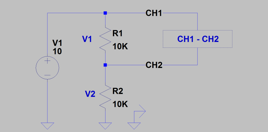

OK, just off the cuff let's think back to something we discussed earlier. Remember when we looked at the vertical channel inputs and how on most scopes they share the same common? We also touched on special pre amp active probes that allow differential (rather than single ended) inputs? Using the Add Mode with an Invert function we can do a differential input trick using two channels. Take a look at the below circuit:
Keeping it simple here my voltage supplied to my divider consisting of R1 & R2 is 10 VDC. Now to measure a floating (off ground) voltage we can use the Add Mode and Invert one channel. As drawn Channel 1 is measuring V1+V2 relative to Common (Ground). Channel 2 is measuring V2 relative to Common (Ground). Now if I Invert Channel 2 I can negate the Channel 2 Voltage. Now I can Add the Channels together (algebraically) using the Add Mode. So now what I have here is really expressed as (V1 + V2) + (-V2) = V1. That would be 5 + 5 = 10 then 10 - 5 = 5. Now let's make R1 6.666 K Ohm and R2 3.333 K Ohm. Try working that out.
Billy, this is just an example of using the Add mode with two channels and inverting one of the channels. This will always go back to what I have been stressing all along. Only once you gain an understanding of all of the features a scope offers will you know how to use and apply them as well as when to use and apply them. Keep in mind in my example I just used some DC levels. They could be other wave forms.
I learned this trick in school, it's better to do differential AC voltages on an O-Scope cause a DVM meter can do the differential DC voltages

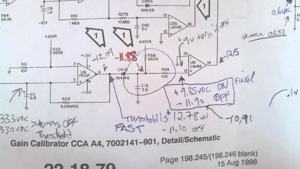

Here is your circuit:

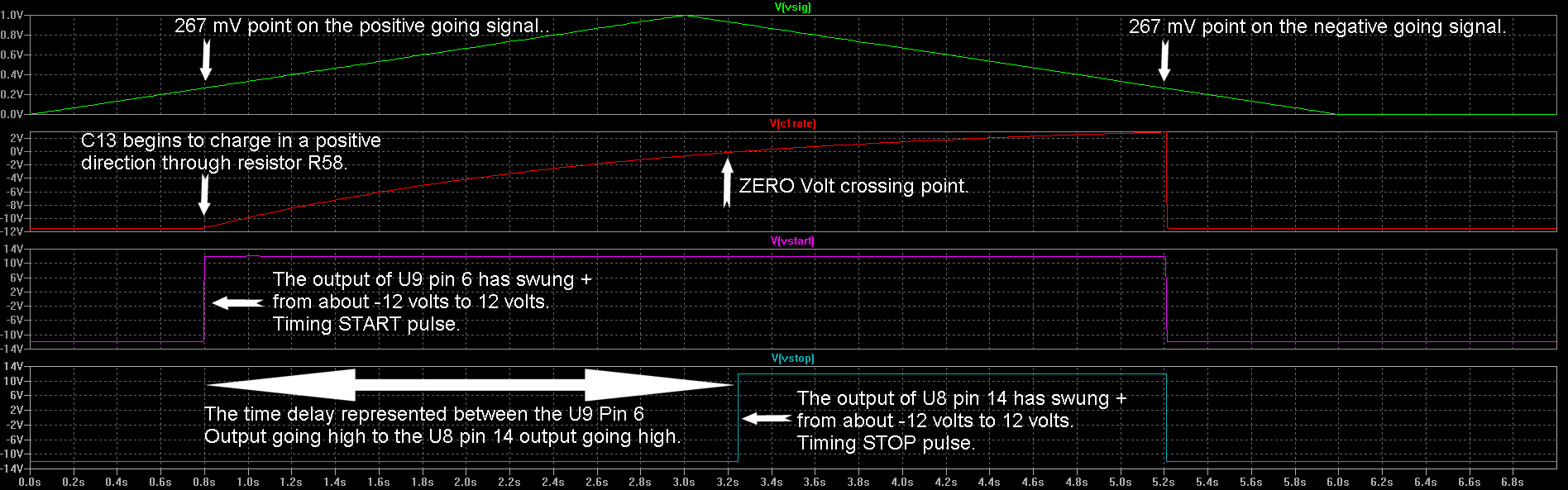

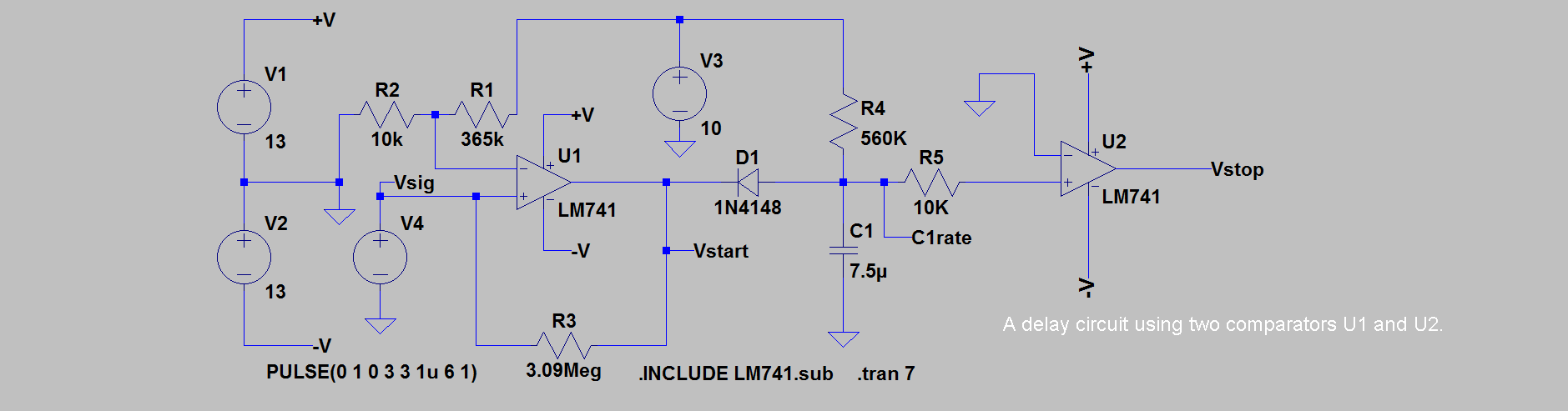

Here is what I modeled based on your circuit:
I could Ext Trigger + Slope and about 0 Level on the output of U9. Using CH1 I could display the junction of C13 & R58 (the R*C timing network) while on CH2 I could display the output of U8. Note the points in time where the signals do things, like where the output of U8 goes positive with respect to the charge of C13.
That was a model of pretty much your circuit. So there is your example again of triggering and using an EXT. trigger signal.
