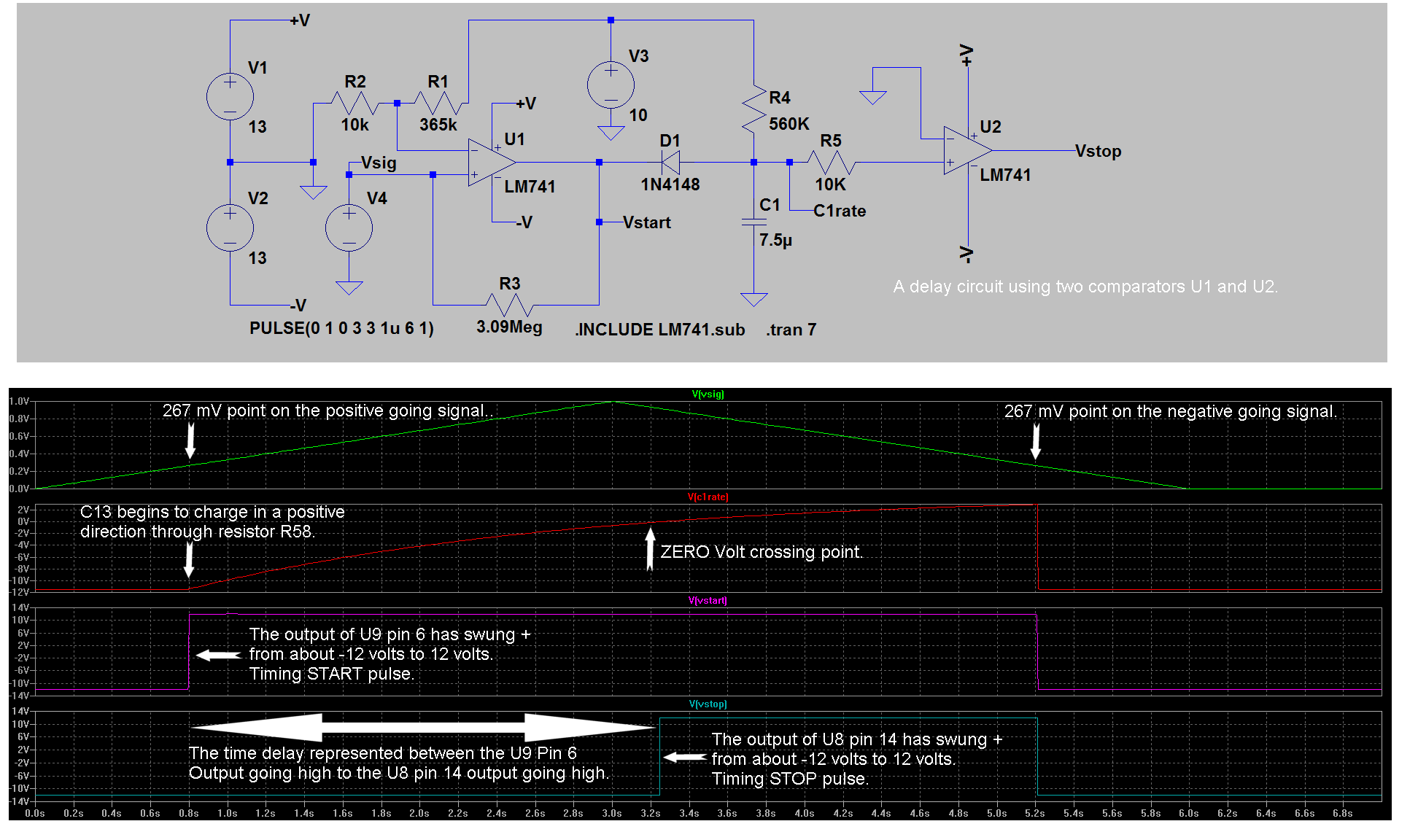

I would set the scope up for two channel operation Using channel 1 I would connect to the junction of R58 and C13. I might use an external trigger and trigger off the output of U9 pin 6. I would set my triggering for Source: External, Level: Midrange, Slope: +, Coupling: DC. I would set my sweep time for maybe around 2 seconds / Division. Channel 1 vertical to the junction of your R58 and C13 RC network and Channel 2 to the output of U8 pin 14. Another option using a 4 channel scope would be to trigger internally off channel 1, channel 2 the RC junction and Channel 3 the output of U8.
Look at the attached image in detail as it is just about what you have in your circuit. My U1 simulates your U9 and my U2 simulates your U8. I use a +/- 13 volt supply as you have (V1 and V2). My V3 is your 10 volt reference supply and finally my V4 simulates the voltage into your U9. The image shows the waveforms as they would look on a scope. Looking at the second trace down (red trace) labeled V[C1Rate] we see the capacitor start charging when the output of U1 swings positive. With the exception of me using a signal I label V4 to simulate a changing voltage input what you see is what you have.

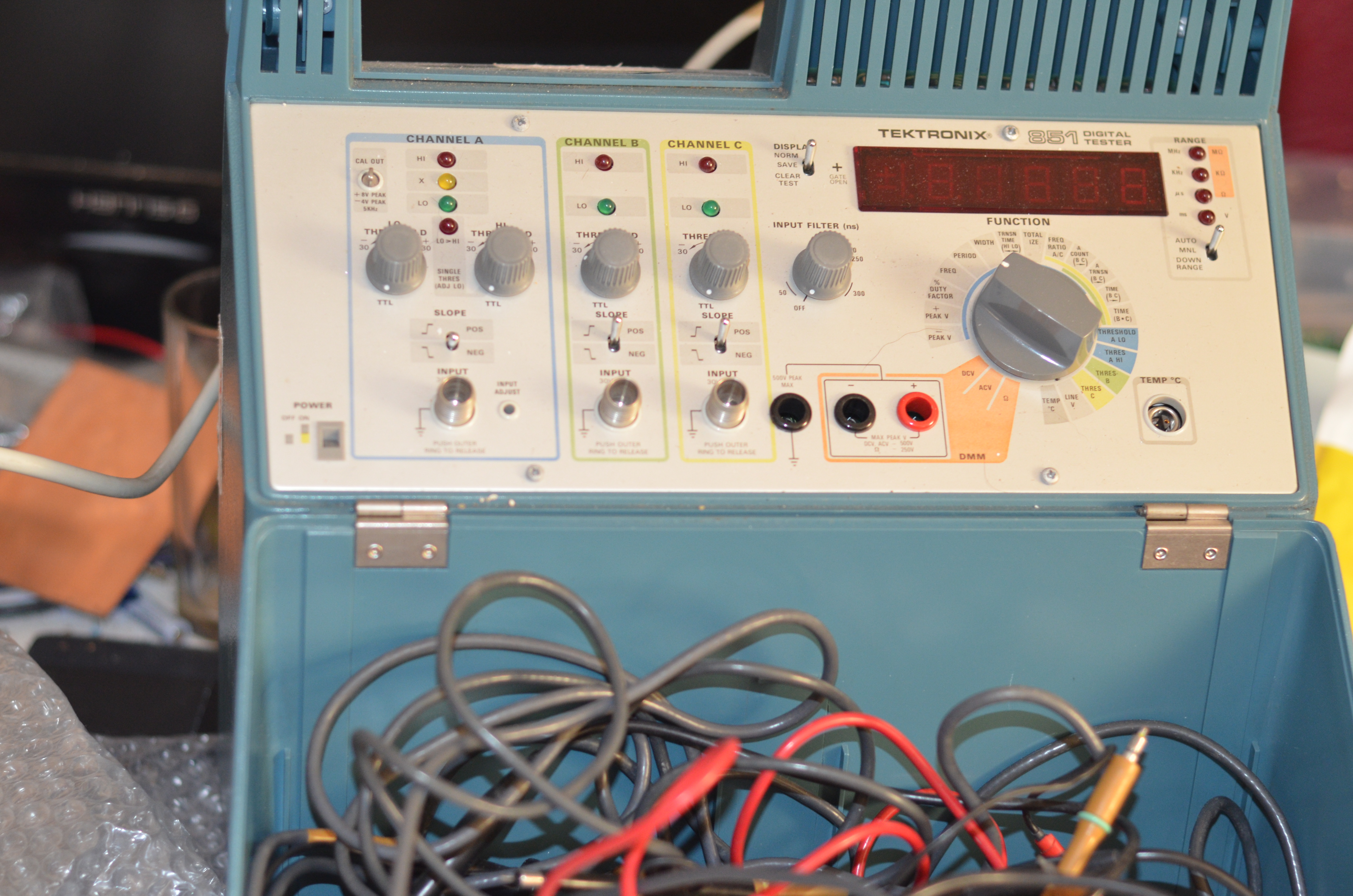

What he needs is something i always have on my bench
It would do everything he needs in one accurate instrument! everything except show a trace that is. but its very accurate, does frequency and counting as well as all normal DVM measurements, Has loads of functions and 5 1/2 digit accuracy

I mentioned using a counter earlier in a time interval mode. However, we can revisit it. Look at my cartoon again. For your drawing we know that when a voltage exceeds .267 Volt (267 mV) into u9s non inverting input that the output of U9 will swing from -13 to 13 volts. That event starts things going and that level is set by the divider of R60 and R61. That transition starts things going with the RC network of R58 and C13 through diode CR19. So C13 starts charging heading for 10 volts. C13 begins charging from about a -12 V where it was sitting. When C13 passes through 0 volts the output of U8 will swing from around -12 to 12 volts. So the output of U9 has a positive going pulse and the output of U8 has a positive going pulse. If I call the first pulse U9 "A" and the second pulse U8 "B" I am measuring a time interval A to B. That is how it would be done using a counter. I labeled the START and STOP pulses on the cartoon I provided in my drawing image.
Now would be yanking my chain? How can it have 5 1/2 digit accuracy? Me thinks it has 5 1/2 digit resolution and in time interval mode it has ranges of 1mS, 10 mS, 100mS, 1S and 10S with an accuracy of +/- 0.005% Rdg +/- 1 Count +/- Trigger Error. Trigger Error is covered in the manual. Me no thinkie that 5 1/2 digits is an accuracy specification but rather a measure of the instruments Resolution. So what you think there LG? :)

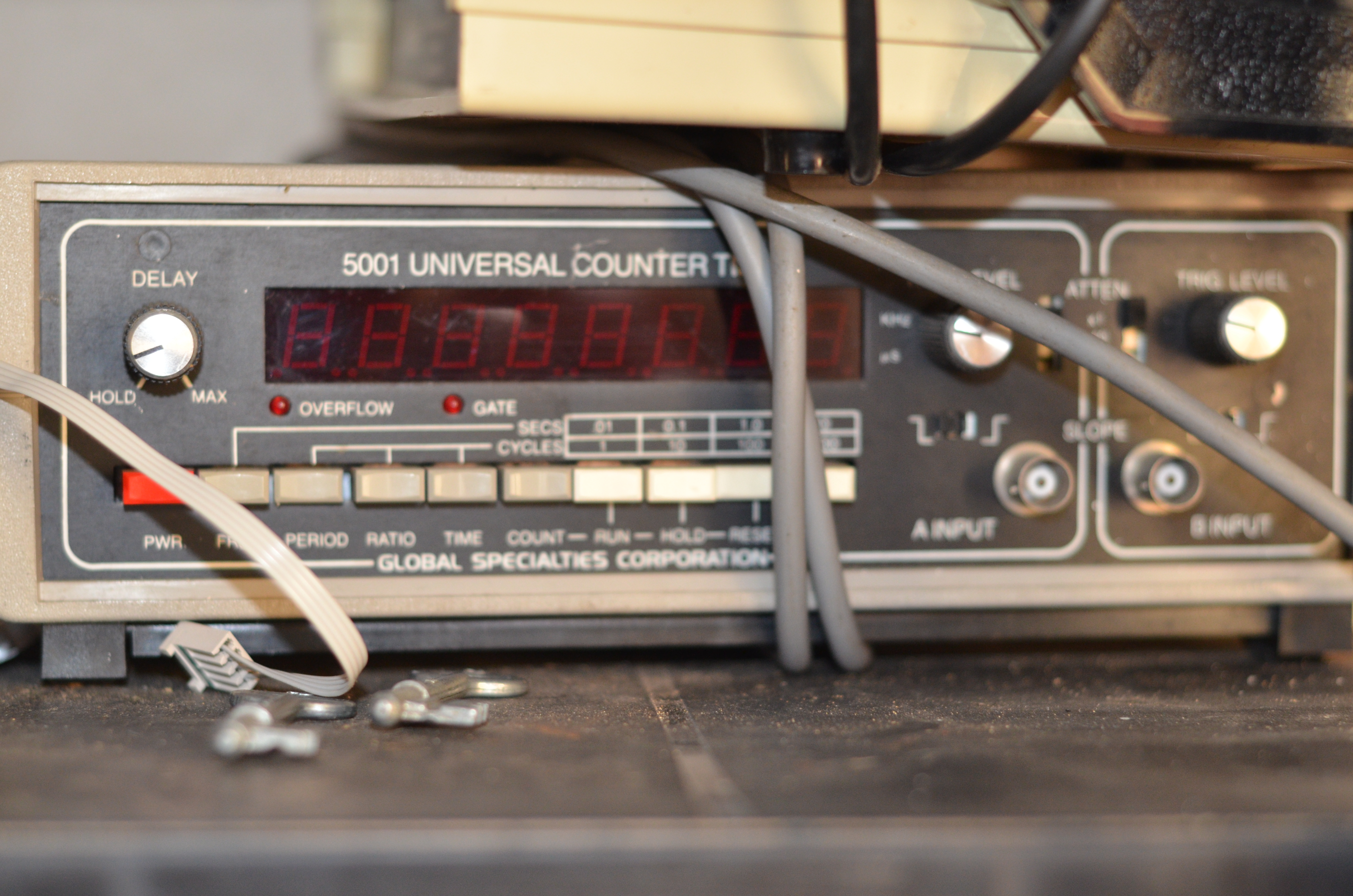

Ermmmm, WELLL I think I should try and proof read a little bit more:oops: as for the time setting's, i have never used the counter on this, so i dont know. It sit's on the bench and mainly gets used for Quick measurements, mainly because it has O scope like probes, when i do timing stuff and i need accuracy, i normally use something else (depending what's plugged in and ready to go :D), order of preference is O scope then this
or if bench space is tight I use
i can see my new pic?
I dont normally use the bench DVM in the pic, I have a Racal one I much prefer

LG I haven't seen a Racal Dana counter in decades. :)
Eventually I need to get my test bench setup again. Since I retired I have been moving things. Between my shooting hobby and my electronics stuff is all over the place. What I really need when spring gets here is a large dumpster and clean some stuff out. :)
I love the Racal stuff! We had that one tested against a Agligent one that was in calibration, and its spot on! same with the Racal bench meter , 6 1/2 digits and spot on. That Tektronix meter would do 99% of what billy need's, plus has the shielded scope type probes! even has temperature reading.
Dad like's new stuff i like the old stuff! One exception is my tenma DMM, ace bit of kit! and has usb connection
