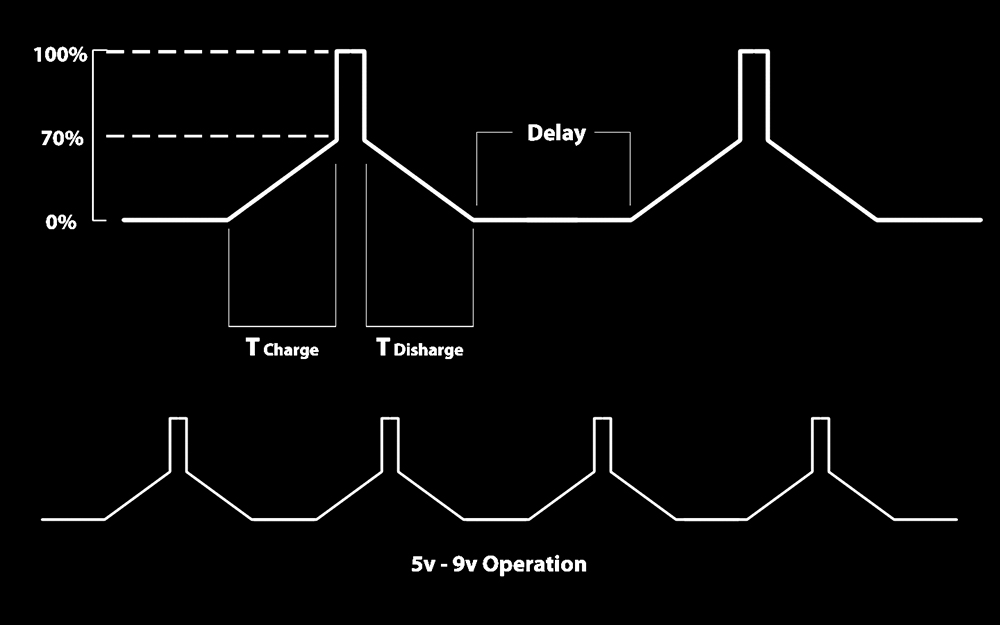

I have constructed a variety of "strobe" circuits in the past using Transistors and 555's but never both. Since I've been on a circuit binge lately I thought I might as well post this problem too.
Concept is a modified Sine Wave to have a low glow LED slowly ramp up to 50%-70% brightness and then "spike" or "flash" at peak brightness then ramp back down to minimum glow again. But, have adjustable timing and 50-50 adj ramp time also. I have attached a graphical interpretation of what I am trying to achieve.
*Correction on schematic 0% should have been 10%
The sine reference ?
You want independent timing and V over -
1) Trampup width time
2) Trampdown width time
3) Tbright pulse width
4) Vglow to Vbright transition V
5) Tglow V before ramp starts
6) Period/frequency
Is that accurate description ? Independent controls over each of these ?
What do you mean by 50-50 adj ramp time ?
Regards, Dana.
Didn't need ramp up and ramp down to be independently controlled. Both the same i.e. 1 sec. up, 1 sec down. Bright pulse is not too critical but the equal ramp up and down times need to be the same length but adjustable. If that makes sense.

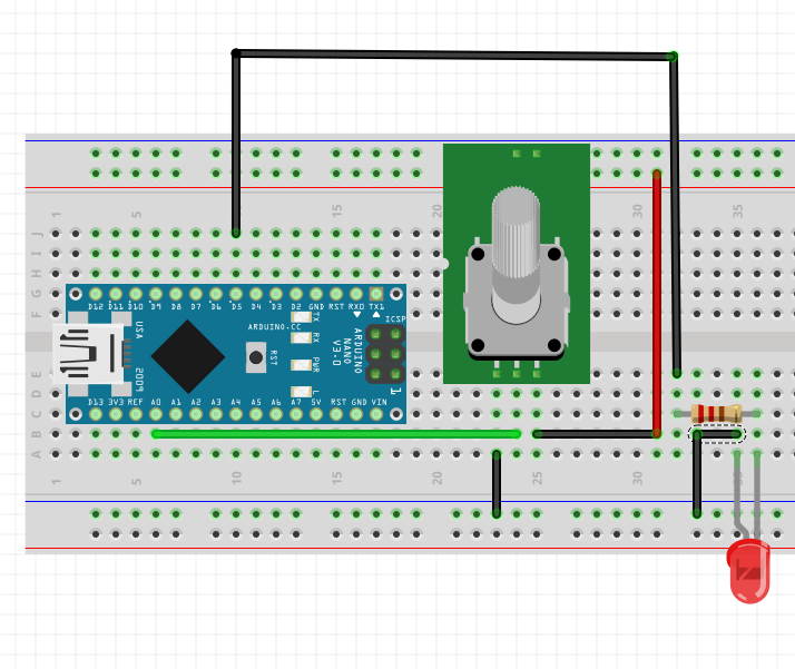

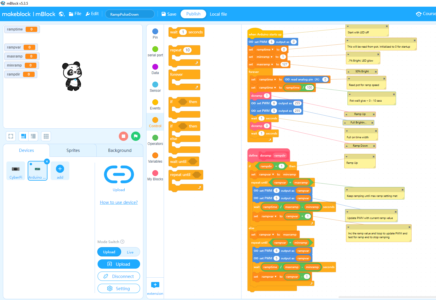

Here is a first pass cut at problem, again using mBlock and a Arduino Nano board.
The delay between rampdown and rampup, is that fixed, and width of 100% brightness also,
is that fixed ?
Note also I used two pwms, inside part, one to control brightness, the other to create a DAC for the scope capture shot above.
Ignore fuzz on scope capture waveform, thats just a limited RC filter used to effect the DAC from the PWM output. I just did
not use large enough values to remove the clock noise coming out of PWM.

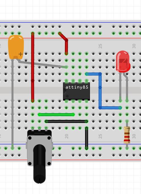

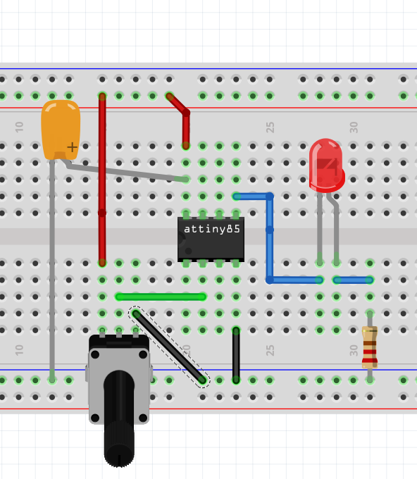

So all you would need is the board, LED, and a R. If you did it with ATTINY85 just the chip and LED and R and Cap to bypass
the ATTINY85 power pin. TINY solution less accurate timing than board unless you added a xtal (board has xtal).
When I did the jump to full brightness I did it from 50% to 100%, I think 25% to 100% looks better.
This is roughly solution would look like if you used the ATTINY85 -
Nano Board I think better because programming is simpler, and has accurate timekeeping.
Regards, Dana.

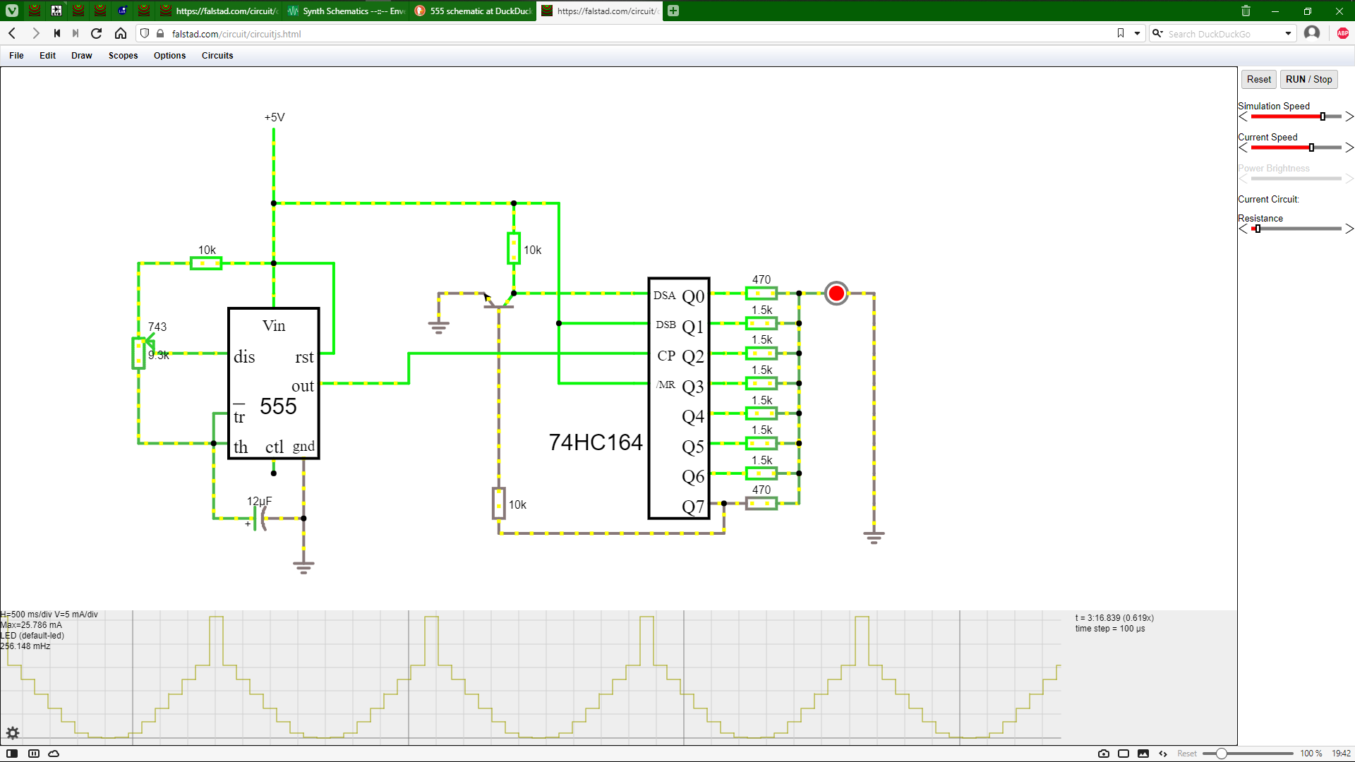

You can reuse the 'raindrop' circuit from your other post. Just replace the 8 LEDS with 1 and adjust the resistor values:
https://tinyurl.com/yesarm7m
Adjust the timer frequency to define the ramp times and the resistors to adjust the steps.
You could throw a capacitor in to smooth it if you don't like the discrete steps and a couple more to stretch the off and peak on dwell times.
You could even daisy chain a couple of SIPOs if you needed finer granularity.
