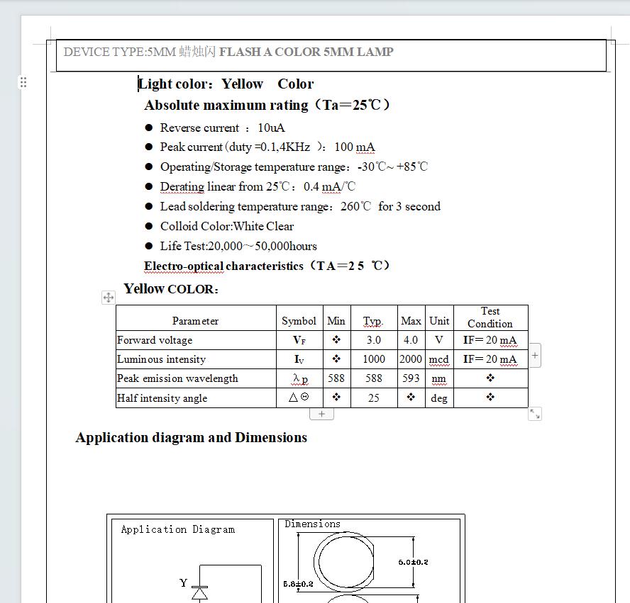

If you tell me the flickering LED’s part number, I can breadboard the circuit and provide waveforms.
I got the Datasheet.

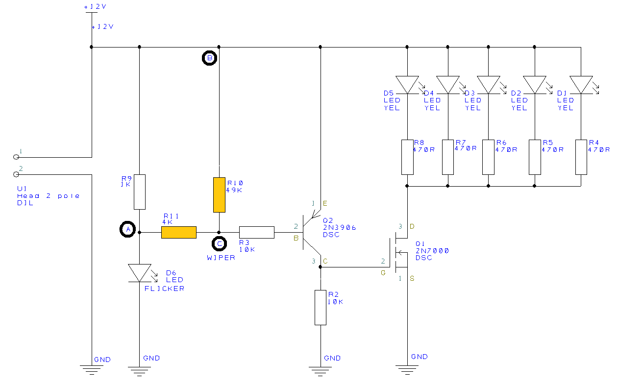

ok so i add a 49K from C-B and a 4k from C-A
So am I correct in saying that R9 should be 50K and R3 should be 14K? or since The POT is in paralell with R9 do i subtract R9 from POT value C-B and make R9 48K?
You are over-thinking this. Just replace the potentiometer with two resistors. Do not try to combine values of the other resistors nearby.
Resistors in parallel do not add up like that, and anyhow you should ignore the other values.
In theory, you could replace R3, R9 and the two parts of the potentiometer with three resistors. However you would need three new resistors instead of keeping R3 and R9, the maths you need to work out the values is really complicated*, and it's absolutely not worth it unless you are making thousands of a design.
*https://en.wikipedia.org/wiki/Y-Δ_transform I don't understand that page. I could probably work it out if I had to, but it would be hard work.
To me, that original circuit is messed up.
For far less voltage sensitivity, the LED and transistor emitter should be connected to the same supply - both to positive or both to negative.
That way, the supply voltage is not affecting the relationship between the LED voltage and the transistor base feed voltage.
I've bought some flickering LEDs from ebay, so I'll do some testing on them when the arrive to see what the actual voltages are when they are running.
Not really. You would still need to adjust something to get the right effect and that might as well be a potentiometer.
You have been more than helpful and I've experienced a great deal. Thank you. I'll be posting my attempt to place these new resistors in the schematic.
Here is my attempt to replace the POT with appropriate resistors. (the POTs value was 53K)
That should work the same as the pot, in that particular build - no guarantees with different components.
The big problem is that the critical voltage for the transistor is between the +12V rail and its base (or point C), while the critical voltage from the LED is between ground and point A.
Any change in supply will change the relationship between the two (A and C), so may need different values.
I should hopefully be able to provide a more reliable circuit by the weekend.

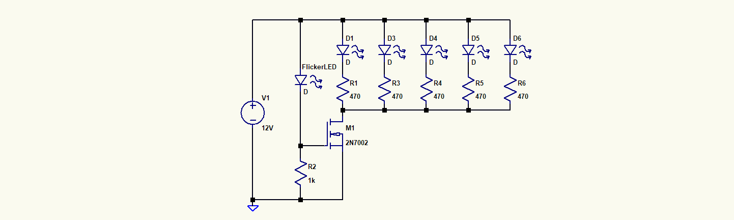

hi Alec.
I wired this up and it works from 4-8.5V dc producing the desired effect. The effect is optimum at 8V. Above 8.5V and the 5 LEDs begin to flicker less and by 9v they are solid and bright but the effect is lost. I swapped the resistor at R2 for a 3.3k but the circuit remained unchanged.
Thank you for providing the circuit. :)
