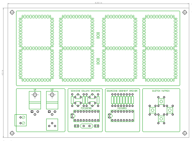

Just wanted to share a possible paper silkscreen layout for the MIC5891 version "Big Clock" circuitry on a cheapie $4 Radio Shack 276-147 proto' board (11.4x16.0cm). I still have to place some components in the power supply section and I have to figure out where to place four diodes for the switch matrix. I wish I could get a little better spacing on the display too but all in all it doesn't look too bad.

Hi Mike,
Thats looking neat! A lot neater than mine, saying that I purposely put my LEDs and circuitry on separate boards so I could keep the footprint of the clock just a little bigger than the actual digits.
I also used Proto board, the kind with just little square copper pads, which I find easier to "blob" two together on than the Protos with the round pads, which makes joining the strings of LEDs easier.

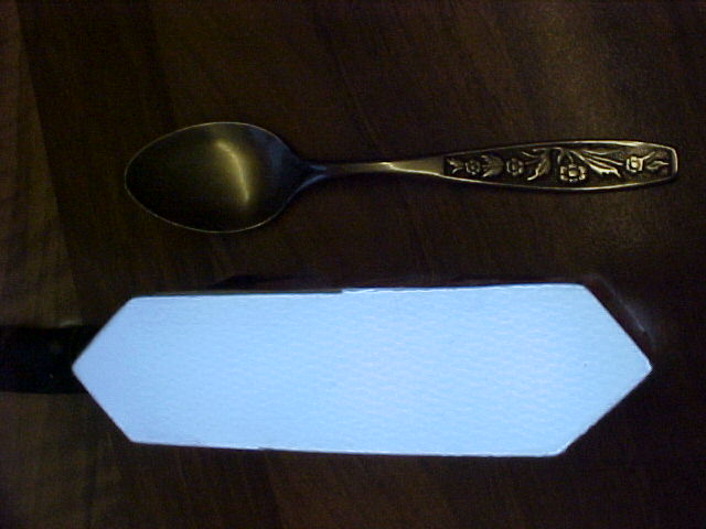

I have now got the clock bug pretty bad and am just making the prototype segments for my next one with digits being about 10" high. Your suggested IC should be ideal for it as the segments only have 3 LEDs in them and draw 80mA at 12v. I just can't decide whether to go with Red, Blue or Green ones.

Edit. Here is a photo of one of my segments lit by white LEDs, its hard to get good shots of them with the camera, the spoon beside it is a teaspoon.
