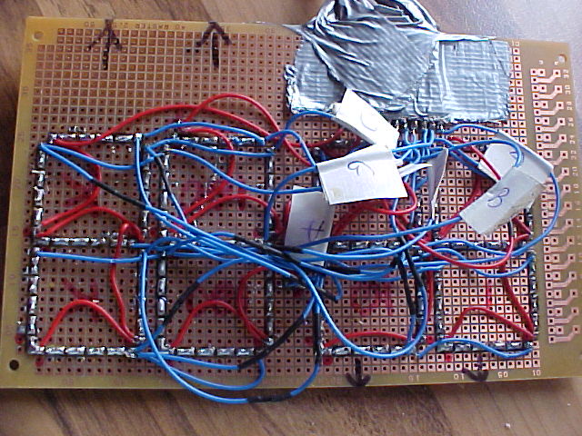

Hi Guys,
Well I was close then things took a turn for the worse. I did a little rewiring and made the whole display wrong.
Then I thought right, I must not be taking into account the reverse to the rear of the board. So I again rewired and all was strange again. Now I am beginning to wonder if ONLY the 3rd digit across is inverted? I thought that the last two (minutes AND tens) were upside down in the drawing, well I assumed that anyway!
What is happening to my wiring? Can someone tell me is JUST the tens of minutes inverted? Or is it like I thought at first?
Baffled again........Al
Al,
BOTH minutes are upside down, I still have the BB clock working alongside me.!
E
Hi Guys,
Right! Today I am starting afresh with a different method of wiring, I'm going to turn the whole thing upside down to do the minutes ;)
Its just the upside down AND doing it from the rear (sounds like a porn film) that gets confusing!
Anyway once more unto the breech, cross your fingers for me eh.
Al
instead of re work, better have a coffee and wire only 8 wires for each digit. Every time you can glow the segment see what it is as seen from top
attach a sticker to the wire concerned later you can handwire easily.
dont increase worklosd
your displays looked otherwise fine.

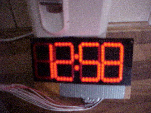

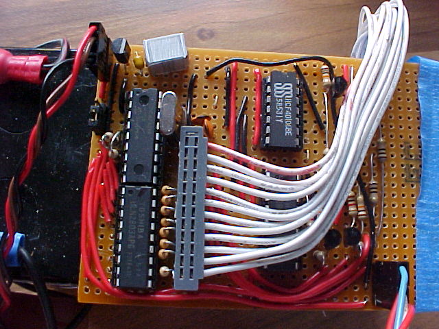

Hi to all,
Thanks again guys for all the help, I couldn't have done it without your support.
Anyway after another go at the wiring of the digits, and a much needed hand from my wife Dawn, who eventually saw where I was going wrong, I have a working clock!
The only small problem I have now is a small one and easily fixed. The 14pin socket I used for the 40106 buffer was an unused but old one, looked fine but the IC seems a bit easy to fit into it and if I tap the board it jumps out! hehehe (hot glue will solve)
Anyway I am posting some pictures of the finished product and should anyone else want to build one I will of course pass on all the help I can. I have a VeroDes drawing of the clock if anyone wants it (you need VeroDes installed but its FREE!) and lets you place components onto virtual Vero Board.
Thanks again guys for the help.
Yours gratefully Al ( at 1:23 precisely)
Edit. The ICs on the left are (top left) PIC16F628A (bottom left)2083 (top right) HEF40106) and (bottom right) under the sheaf of wires is the other 2083

Nice photo. perhaps she deserves a nice party for helping you finish the product/project.
Just have a feeling that inter digit , there could be little more gap. i saw that the board is limited
then we could use two pcbs , one for hours and another for min.
now with this PCB, you need to place a dark spacer between the inter-digit gap and then pack it in the box. It helps the digits not to be hazy.
IC jumping off the socket___there were similar jokes on ICs falling from Apple or earlier computers. they used to socket all chips and dispatch the computer. when received, the end customer finds all chaps out of those sockets and dancing around, inside the packet.
let us use cheaper I C bases ( not the turned pin type) and they work comfortably.
now coming to your helping others with vero board, perhaps it is better that we make a single sided pcb artwork so that they can not but make a correct clock.
Hi Sarma,
Thanks mate, I will be rewarding the wife with an order from our favourite take away tomorrow night!
As for the gaps, it was the only large vero board I had, so I made them to fit as you guessed. I would have liked bigger gaps but until I get some more board it will have to do. I am planning on covering the whole thing in red perspex so it should look a bit better.
The socket I used must be an old Apple one then! heheh Its not turned pin but really sloppy!
Anyway at least everything works ok now and I can move on to the next project that I can mess up.
Al
PS good idea about the black strips between the digits, I will implement that! Al
