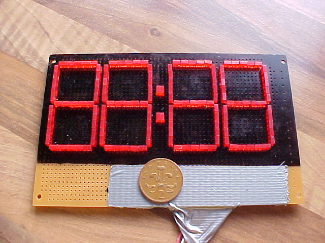

All the digits are connected segment A to A, G to G etc and the decimal points I have just added to one of the digits in a clock style, which is as the drawing. Jose only inverts the minutes to get the colon like clocks have, and the connections are seen as standard.
I once made another of Jose's clocks which was Charlieplexed and was a real wiring nightmare, I will post a picture of my clock display anyway, so you guys can see what you think of it.
Al

I have taken a couple of pics of my display to see what everyone thinks.
Al

hi Al,
Watch out for sunburn!

And as for sunburn! Not with these mate, they are very dull (well diffused) hehe
Thanks Al

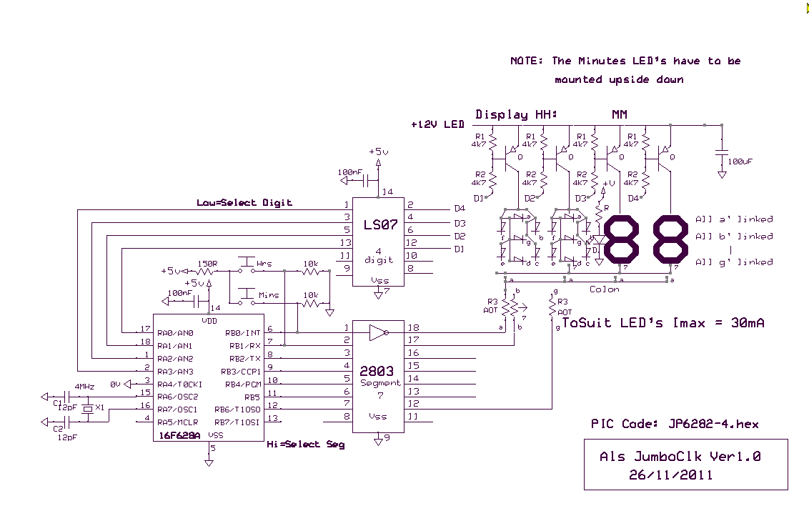

hi Al,
I have it working with the original hex and with a change to the circuit.
You may have seen in the 'jose' notes than the minutes are upside, well they are literally upside down on the LED's !!, not just a drawing error.
Segment 'a' is at the bottom , 'd' at the top.!
As my LED's are on a block of four I cannot turn them the other way up, but you should be able to wire yours to suit.
Keep you posted.

Circuit diagram and expressch.sch file.

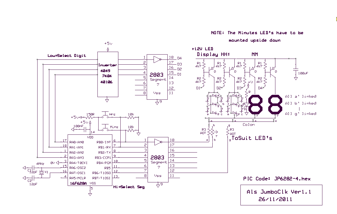

Hi Eric,
That looks good but I thought you were planning for 2N3906s instead of the 07 as I have loads of them?
Is it any different with them? Yes I can easily change the segments around.
I didn't mean this to sound ungrateful but I have the trannies to hand and not the 07s
You have always been more than helpful to me, and other members of this forum I'm sure.
Also I need to drive each segment at about 20mA just so they are reasonably bright, they are as I said "well diffused", to the point of being a bit dim at levels much below 20mA, so the segment draw at an "8" would be 140mA and thats without the 1/4 duty cycle factor, so it may be the only way is to use transistors?
The LEDs are a batch that I bought very cheaply at a rally I think, some time ago and they are probably very inneficient, just tried one on my LED tester where I can put a superbright red LED on at about 2mA and it be very bright even then, these 5x2 reds are not even visible! Probably get heat burn before sunburn on these Eric hehehe
Thanks Al
hi Al,
The 2N3906's are for the Digit Anode Drive.
The 7407 are non inverting open collector high voltage/current outputs to drive the 2N3906's inputs.
As the LED anodes are at 12v/15V, the 7407 acts as a non inverting level shifters. I have some spare 7407 to post to you.
The ULN2803 is for the segment sinks, inverting.
Rather than rewrite the clock program I have modified the hardware to suit.

You could do it this way if you have the bits on the shelf. Any TTT LS or CMOS inverter

Morning Eric,
Thats brilliant mate, I can now build it! I have loads of both 2803s and 40106s. :)

hi Al,
To increase the Anode drive I have changed the resistors on the Bases of the 2N3906.
Can you figure out how to connect your inverters, if not just ask.

Hi Eric,
I was perusing the diagram and wondered if the 40106 inverts and then the 2803 inverts again, isn't the signal back to normal?
If so then why can't I connect the PICs outputs through resistors directly to the 3906 bases?

Hi Eric,
Yes.
Because the 1k/4k7 are connected to +12V
Yours Al
