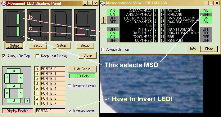

hi Al,
Look at this image of the sim PIC display.
It shows the Digit select lines are LOW to enable and the segment lines are High to drive the LED, which indicates a Common Cathode LED, not Common Anode.
Note to make it run I had to invert the Sim Digit select lines.
Lets know what you think.:D

jose pino site has a note that reads configurable CC or CA
Pin 3 defines the display type. If you will use common cathode display, connect to negative. For common anode, connect to positive. Here is a example circuit:
OK, I will give that a go.
EDIT:
Tried pin 3 all OK, missed that note in the small print, well spotted Sarma.:D
Works OK as both CA and CC leds
