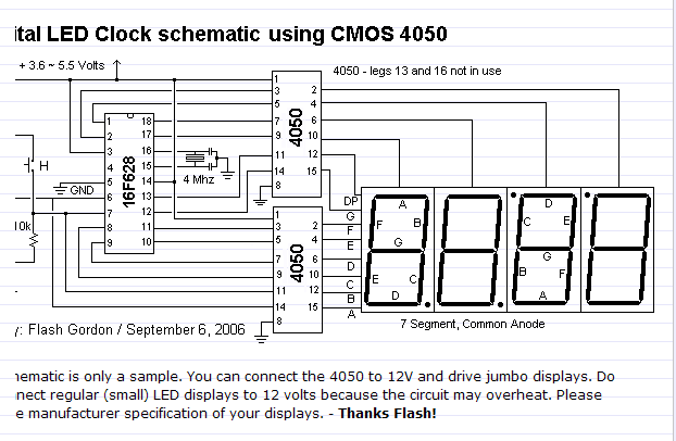

I have just built a jumbo LED clock from a design on Jose Pino's web page that uses a 16F628 and when I got to the stage of programming the PIC I found to my dismay that the packet I had it in was mislabled, the actual PIC is a 16F628"A".
All the research I did on the net seemed to point to the "A" being compatible with the code from a non"A". But on trying the code I am not getting much activity except the minutes digits showing capital "C"s but backwards.
I have tried various configurations of the fuses but that was the most I got. Is there a way of setting the configuration bits that would help me. I just wish I had a non "A" instead of the "A" version so I could rule out the differences.
Jose's page does not mention any special setting of the fuses and I have tried a good few combinations, but there are 7 fuses plus the protection one to choose and I doubt that the PICs legs will stand that many changes.
Here is a link to the clock pagehttp://www.josepino.com/circuits/led_clock
Any ideas guys........Al

There is your problem.... If the chip is set to use HS instead of the recommended XT.. The XTAL caps may be giving you a problem... Running this in ISIS appears to work. So it must be to do with the osc setting.

Exactly which circuit have you built, I know its the Jumbo, but post the actual schematic from your link.
E
Hi Eric,
The scan seems to be ok mate. The schematic I used is the last one on the page, credited to Flash Gordon. I can't copy it mate!
My circuit is exact except that I am powering the 4050s from 12v instead of from the 5v rail. My segments are each 5x red 5 x 2 leds and at 25mm each look really good as they are diffused LEDs.
I have tested the segments and all are ok.
I have always wanted a large LED clock for my workshop and now my neck is getting worse I can't look up at my regular clock! So I thought I would finally get around to making one. I did attempt to start from scratch but my coding skills are definately not up to it and I just kept getting confused with the interrupts and timings (well most of it really) hehehe
Al

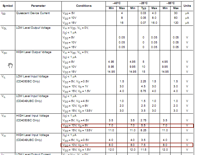

hi Al,
Look at this clip from the d/s for the 4050.
Are you using buffered 'B' or unbuffered 'UB' 4050's.?
hi Al,
As I suspected the 4050 when powered from 12V will not switch the output with a 0/5V input signal it..
The switching input must be at least +6V to be recognised as a logic high.
I suspect that Jumbo circuit is just another 'artists impression' !:rolleyes: Extract: This schematic is only a sample
To confirm the d/s, I have tried it using 4050's on a BB , it does not switch!
