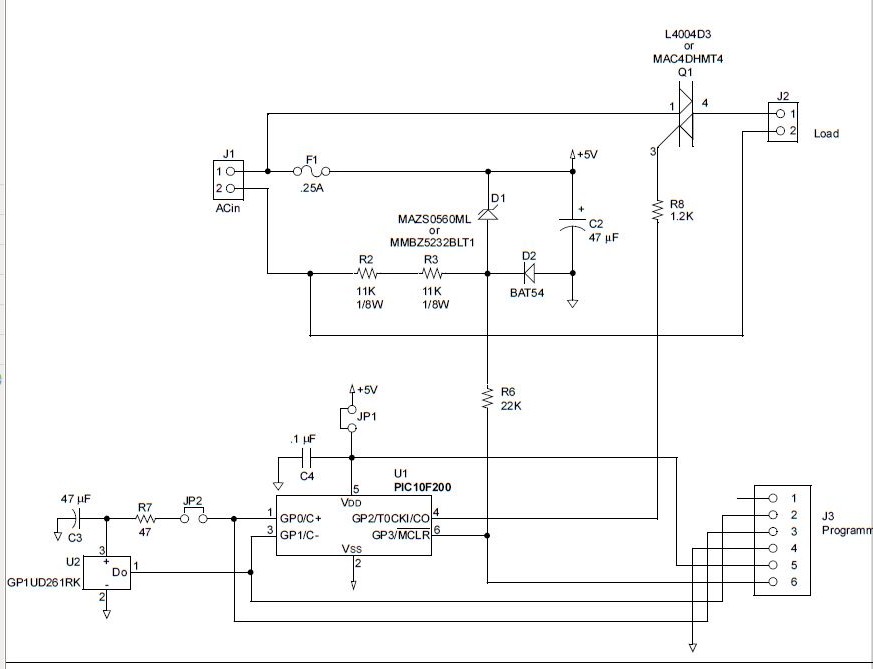

I hope someone can help me out. I'm attempting to build my first circuit (the incandescent dimmer circuit from the microchip site):
https://www.electro-tech-online.com/custompdfs/2009/09/91094A.pdf
I was putting together a parts list and when I came to the resistors, I didn't know the wattage that I needed - only the Ohms are listed. If anyone can help me figure out the wattage of the resistors, it would help a lot.
I searched the forums and came across another dimmer design. Does anyone with experience have an opinion as to whether one schematic is “better” than the other?
https://www.electro-tech-online.com/threads/light-dimmer-controlled-by-pic.88654/

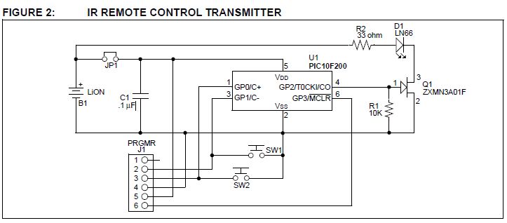

Does anyone know if I can just use a generic IR transmitter / receiver pair instead of the ones listed?
On the diagram of the receiver (see attached), there are several places (near the lower left for instance) where the lines are terminated with an arrow. Where does this connection "really" go? For example, the arrow to the left of the 47 mfd capacitor, and the arrow on the number "2" of the IR receiver [GP1UD261RK]. I’ll take an answer or a link, or an hint as to where to find that information out for myself.
One more question (for now). What do you think the jumpers are for?
So basically, I will take any help that the community can give. I have tried to do my homework before submitting.
Thanks a bunch! Chris

Chris, either circuit will work but be careful with the Microchip circuit. It is directly connected to the AC line and uses a resistor divider and zener to drop the voltage down to 5 volts. This method needs fewer parts but can be LETHAL if you are not careful. To answer your questions about the resistors, 1/8 watt should also work for the ones not marked with a wattage but if you have 1/4 watt they will also be fine. About the "arrows" that is the normal method of indicating circuit "ground" , connect all of the arrows that do not have +5V together and connect all of the arrows that have +5V beside them together. JP1 and JP2 are there to allow you to remove them and program the circuit using ICSP (In Circuit Serial Programming). J3 of course is your ICSP header, J2 would go to your light bulb, J1 goes to AC line (110 as most of us here in the States normally call it).
I do not quite follow you on the generic transmitter/receiver pair for the IR. The transmitter is made from scratch as shown in the 2nd picture you attached. Make sure you download the source code or hex file for it, I can't remember if it is in the zip file for 91094A or not. As for the receiver for best results use the one indicated, if substituting make sure you use one for a 38 kHz carrier

Mike, Thanks for the help! You did answer my question about the transmitter. I was referring to the actual IR transmitting/receiving Diodes.
At the local electronics shop (Frys Electronics) I found a pair of IR transmitting and receiving LEDs. My question was "could I substitute these instead?". It looks like as long as they are 38 kHz I might be good. The only place I found the exact part number was on Mouser Electronics and they were on backorder. I didn't want to pay $7.50 "backorder shipping" for a $1.25 part ;) I did go ahead and order a 38kHz substitution pair from them anyway.

Sorry for being so late getting back to you on this. The receiver is not just a diode, it is a complete receiver and demodulator circuit contained in a 3 pin package. You will not be able to substitute just a diode for it. On the bright side, you can likely pick-up a suitable substitute at a local Radio Shack if you are in a hurry to build the project or if you ordered a diode only instead of a receiver module

Thanks. I didn't realize that the IR receiver contained a demodulator built in. You likely saved me some debugging time! Can I trouble you (or the community) with another question. I thought I could figure out the capacitor voltage, but had to guess when confronted with the myriad of available options at the store. From what I can tell, all capacitors on this schematic are at +5 volts because they are already being knocked down from 110V to 5V by passing thru the two resistors and the zener diode. Did I read the schematic correctly?
Chris, sorry for being so long in getting back to you but my internet has been down due to a fried modem. The only one I would worry about is the 47 uf right after the zener. That one I would use at least a 50 volt cap

Some Good news..I have built both boards at got the remote to work. I haven't been able to get the dimmer board to work yet though. I'm going to rebuild it and try again. I do have one question before I start. In the docs (see here: https://www.electro-tech-online.com/custompdfs/2009/11/91094A.pdf) on page 3 it talks about adding a 330 mfd filter cap. as part of the transformerless power supply. I don't see that in the schematic though. Anyone know if this is an oversite, or is there something I don't know?
Chris,
Replace the 47 ufd capacitor in the schematic with the 330 ufd. This could be why the circuit doesn't work, not enough power for the devices.
