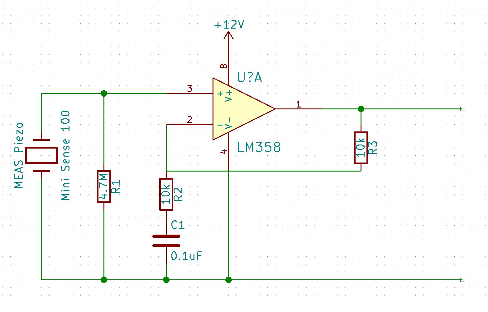

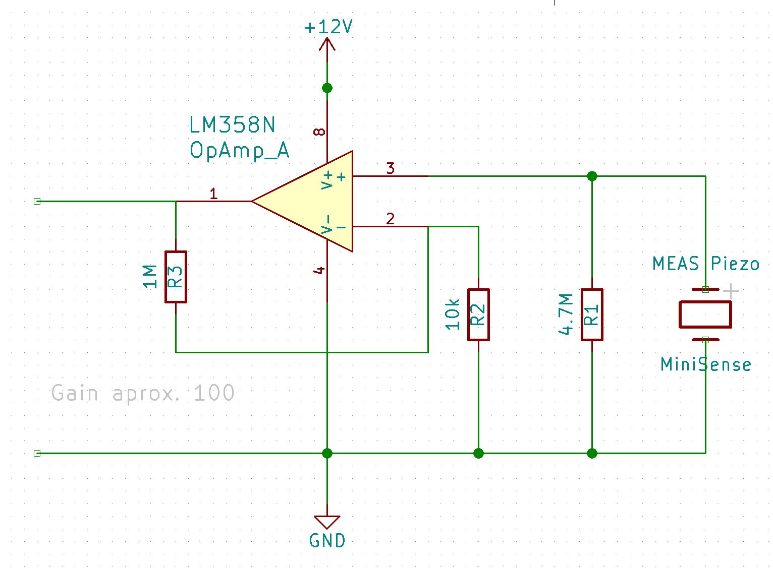

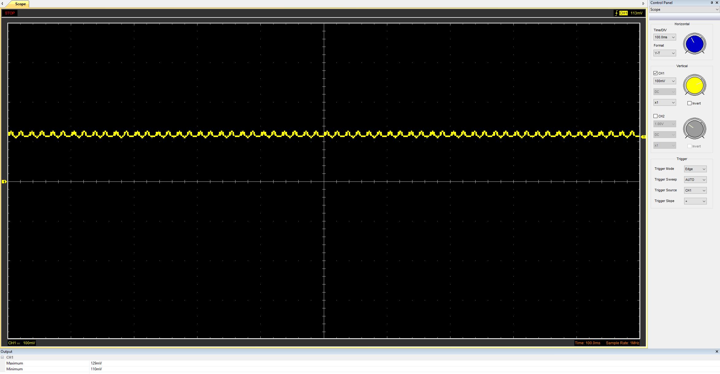

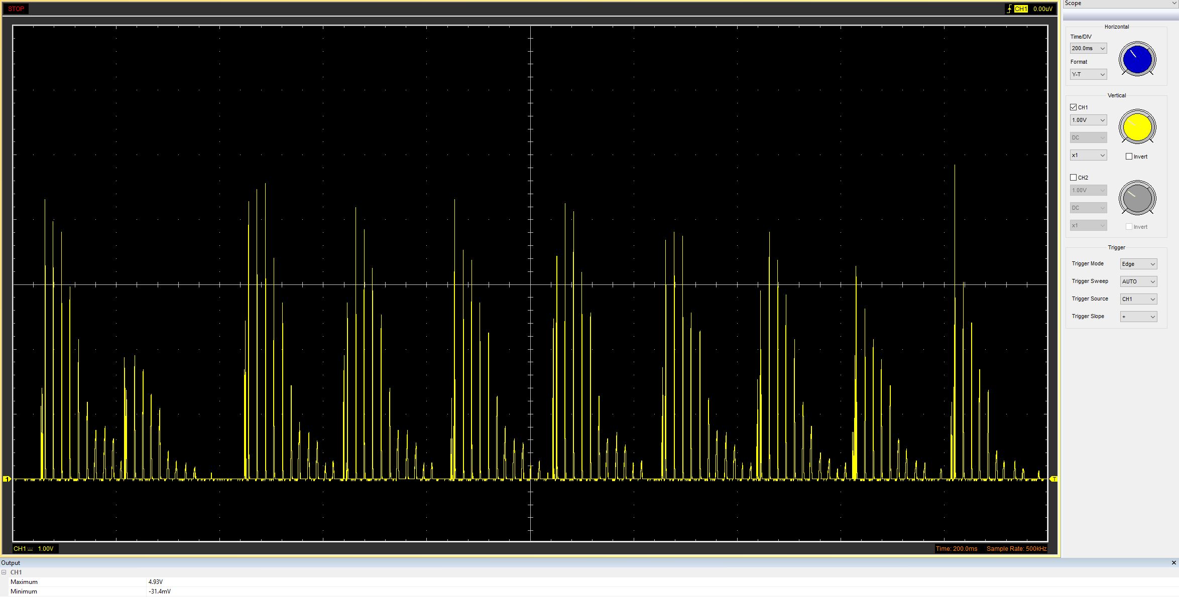

I am here again and using a very simple Op Amp LM358 circuit and got great results in regard to sensitivity. Also I am using a dual voltage supply with a LiPo delivering me -4.14V, 0V and +4.15V (a difference of 0.01V) I do not know how much this voltage difference is or is not affecting the result.

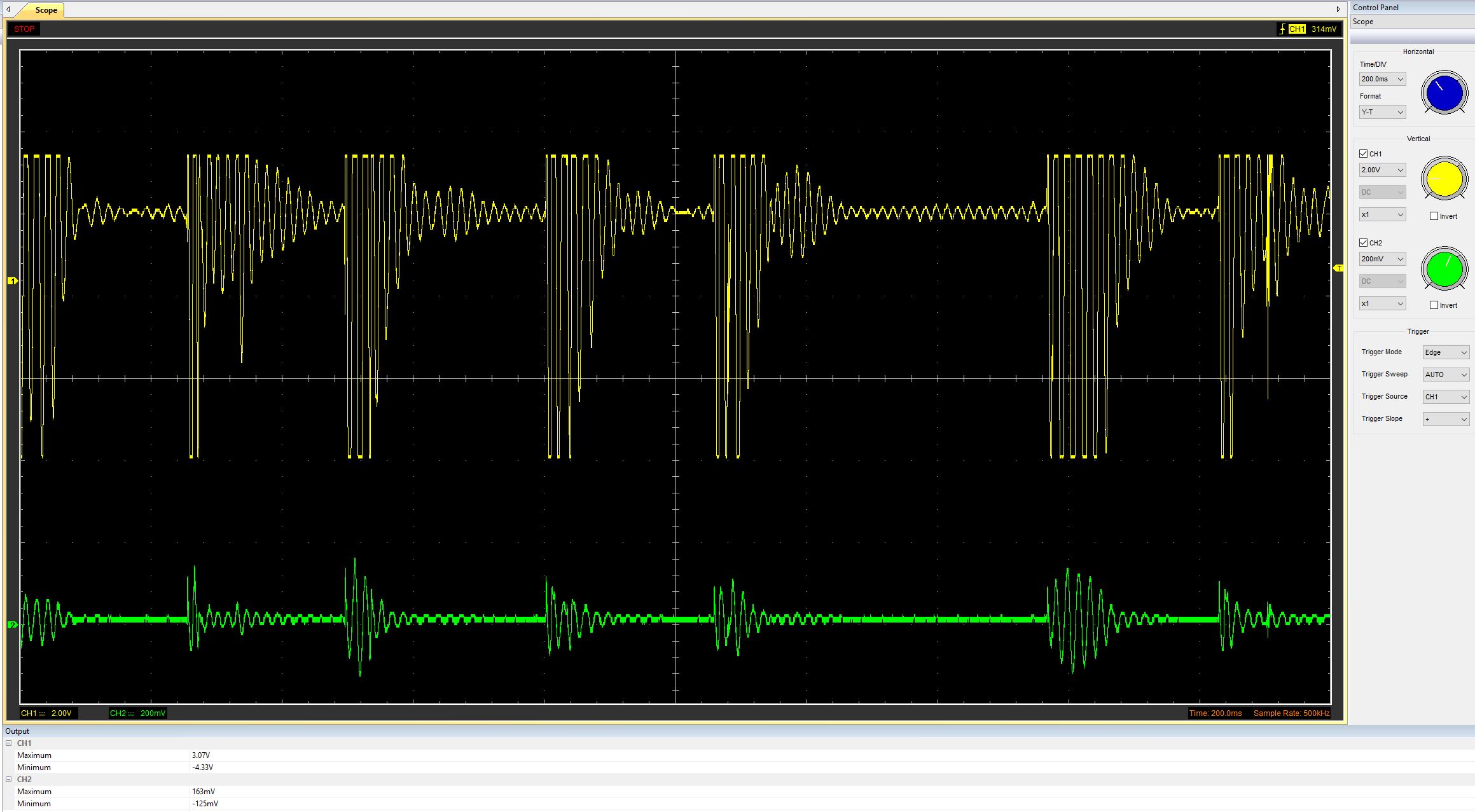

Look at the circuit with a Gain of ~100 except that at the moment of writing this I am feeding -4.14V into Pin 4 and +4.15V into Pin 8. BTW the pins 5,6 and 7 are connected to ground.
and here on the Oscilloscope the behavior of the LM358 using a double rail voltage supply
I thought that using a dual voltage supply the middle line of the wave would be along the 0V line but it happens to be that in the amplified signal = Yellow Line the center is on ~1.7V.
If I use a capacitor between R2 and GND my sensitivity does suffer a lot.
In the configuration I have now if let fall down a ball pen from 15cm and 3 feet away I get a nice visible signal on the amplified wave. I know I have again the 60Hz noise, but at the moment that is less of my concern as I can eventually live with it when connecting the output to the LM314 and just set the minimum limit on 1.85V for example and everything over that will be signalizing vibration.
Any comments about this behavior so I can understand what I am doing wrong ?

The offset of the OP amp and the transducer get's amplified by 100. 10 mV * 100 is 100 mV as an example.
So do what the suggested circuit does. One stage gain use some gain or a gain of 1. Then use a 2nd stage and capacitively couple the output from the first stage. The input Z of the second stage can be tailored to what you want.
You have to "juggle" stuff so it works. The high Z of the transducer messes certain things up. The buffer essentially does an impedance transformation where the filters (capacitive coupling) will now work.
Select C = 1/(2*PI*R*C); PI is that silly number 3.14...., C will be in Farads, R is the input Z or external added input load of the next stage. At f, the response will be down -3 db or the sqrt(2) or about 70.7%
The second stage will only amplify the input offset voltage of the LM358 and not the transducer.
The LM741 https://www.ti.com/lit/ds/symlink/lm741.pdf (DO NOT USE THIS OP AMP) has what's called an offset/null pin. This can be used to null the amplifier offset
So, you either need an OP Amp with a low offset or an offset null pin or offset null can be implemented using a summer.

OK. BTW I forgot to write in my previous post that using a single voltage I get the same behavior as using positive and negative voltage. Just as a side note.
Thanks and I am looking for a similar circuit you just described.
The st part doesn't look horrible and it has input protection. With a GBW of 400 kHz, a gain of 100 reduces the bandwidth to 40 kHz.
GBW = gain * bandwidth and is usually a constant for an amplifier. So, when you increase the gain, you reduce the BW. GBW is known as the gain Band Width product.
"product" comes from the multiplication
Pin 7 of the LM358 is the OUTPUT of the opamp you are not using. It might be trying to amplify its input offset voltage 100,000 times and go up in smoke because you should never short an output to ground.
Instead you should connect its (+) input to ground and connect its (-) input to its output so its gain is only 1 and its output will be close to 0V.

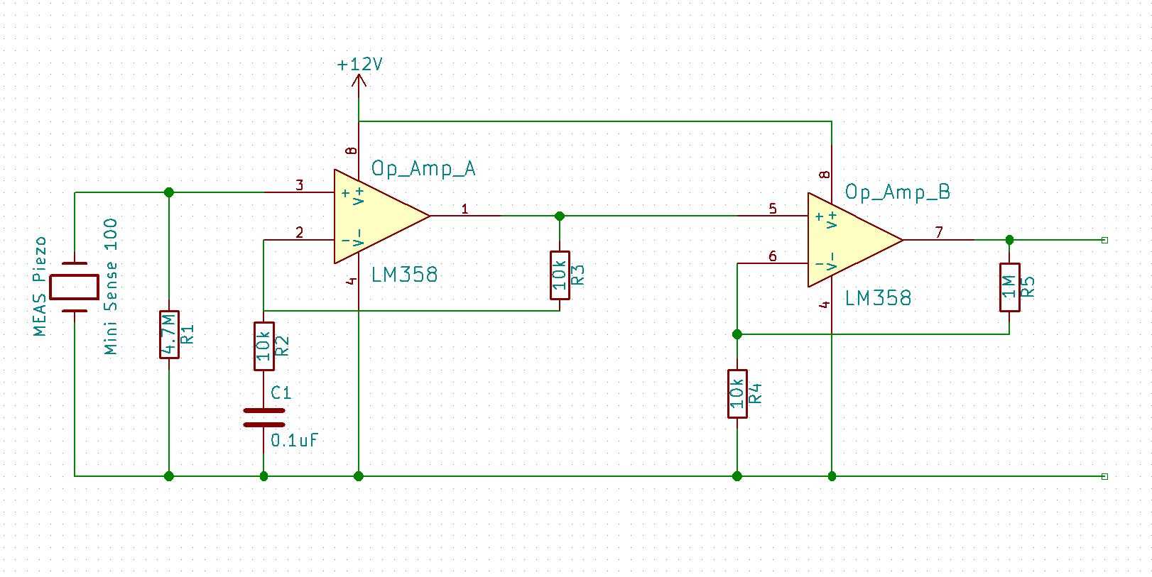

OK. I have now the following circuit as a possible ¿ Buffer As you explained ¿?
but now I found out that the probe of my oscilloscope is doing something strange. If I just connect the probe on Pin 1 I get an offset like the following one
and if I put a 220pF capacitor between Pin one and the probe i get a nice zeroed reading like the one below
I am clueless as usual :confused:
Now I wired the Pin 1 to pin 5 of the Op Amp B unit and set a gain of 100 using pin 6 and 7 as usual. Look below
but again I only get a zeroed reading putting a 220pF capacitor between probe an Pin 7 OUT Look below
and if I put the 220pf capacitor between pin 1 and 5 I get a high line and it only amplifies down to zero (0)
R2 out, R1 =0 C1 = out
You say your using a dual supply, yet your schematic is single.
So, are we single or dual?
This should be about what you had.
Now...
Put a 1 uf cap between pin #1 of OPA and pin #5 of OPB
Put a 1000 ohms to ground from pin #1 on OPA
This would reduce the bandwidth to 160 Hz or so.

Sorry, I am now working single supply from a 11.1V LiPo
Hi KISS,

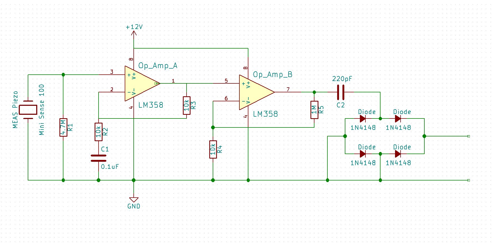

Well, here you can see the latest circuit
and here the output directly read from the bridge rectifier with the Oscilloscope probe connected to + and the Oscilloscope ground to ground. The result looks quite good and the sensitivity is also great but still have to test it somewhere to see more.
Your tip of using a buffer at first stage made the trick. :woot:
Now I will add the LM3914 as I have seen that the slightest movement already gives me a good signal. Will glue it onto the window or wall and observe what happens.
Even when I walk at about 10 feet away I already get a vibration signal ;)
Thanks a lot

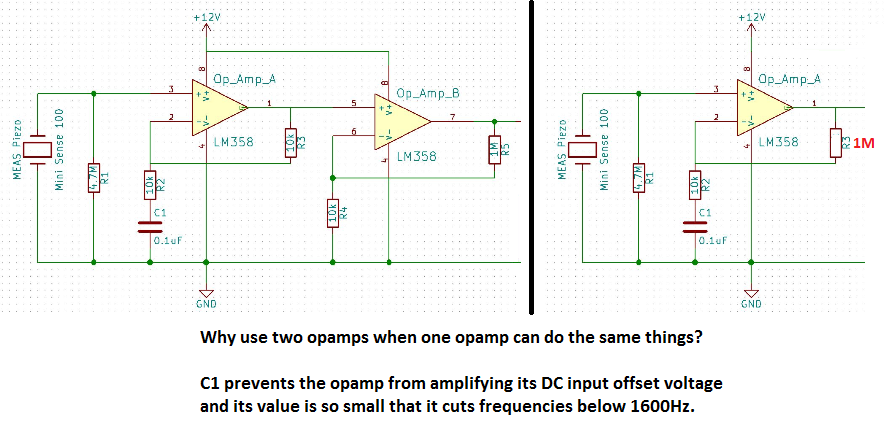

Since your opamps do not have a negative supply in your latest schematic and their (+) inputs are also at 0V then they rectify the signal so your diodes are not necessary. The outputs of the opamps cannot go negative without having a negative supply.
Why use two opamps?
Your capacitor value is much too small so it cuts most vibration frequencies.
Look at this:
