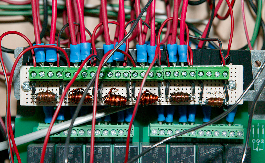

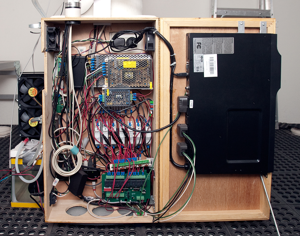

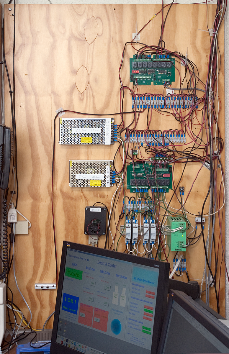

By the way I developed the whole wiring and mechanical logic for my observatory for being remote controlled. Look at the images below. I even thought how to measure the current, (peanuts for you but not for me until I found the logic how to do it), of the connected devices in order to know if they are working or not, I went from the point that measuring voltage was a nonsense as the device could be connected but if it is not drawing current it is not working. So I made manually a simple current loop detector or whatever it is called.
Yes right but that is no fun. I once made a amplifier using the INA122P for building a cloud detector and that worked. I searched the internet how to do it and it is working. The thing at the end of the red pipe

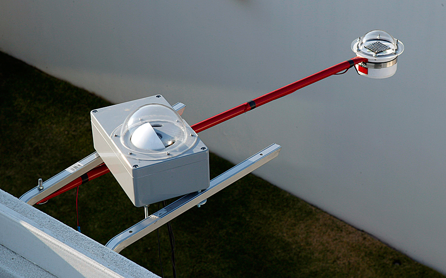

BTW the grey case is a custom made 180° All Sky camera also made by me.
Below you can see some of the wiring working in my Observatory
View attachment 94785 View attachment 94786 View attachment 94787
I am very impressed with the level of quality, time, and money you have put into your passion of observing the world beyond this blue marble. I think this shows your love of the sciences, the unknown, and your quest to understand how the world of things work. It seems to me that you were/are making good progress, and setbacks due to learning curve are to be expected, and part of the fun in the exploration process. How many tries did Edison make to get the lightbulb? I think you would be making a mistake to give up on your vision, and to quit would be a dent in your self esteem. Keep going brotha :)

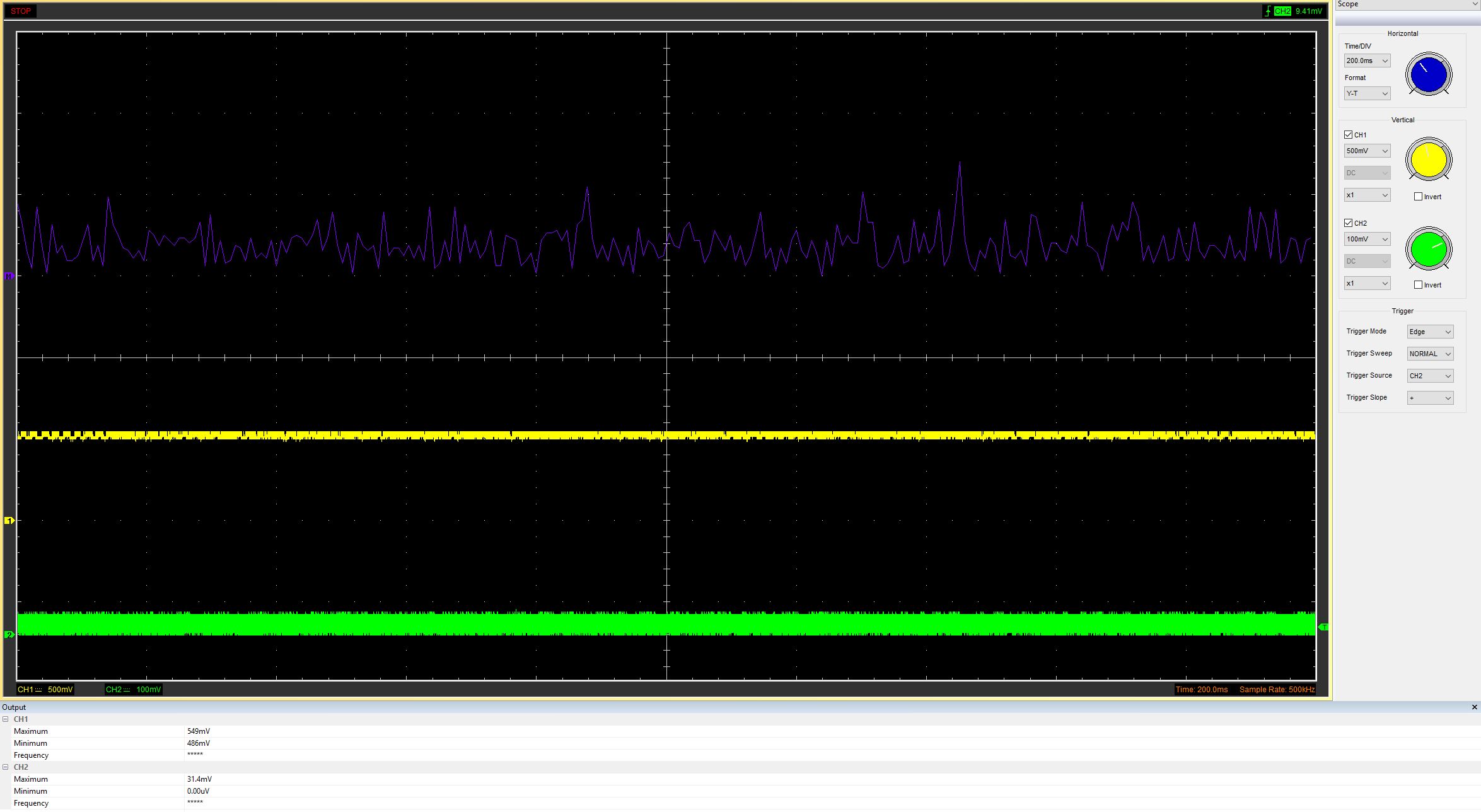

Somebody here asked about if my Oscilloscope has a FFT function. Well yes it has one.
I made some Trial & Error experiments and I get now the following FFT curves when analyzing input at the LM358 and as well the Output of the LM358.
Below the FFT curve sampled at 10ms at the input
The blue dotted line is sitting at ~ 60Hz which was the main noise I had before. Now I see no relevant spike there so the 60Hz noise is gone ¿ right ? but I see a relevant spike at ~ 15Hz which is one quarter of 60Hz. Maybe due to now correctly chosen values for the RC component , but Ok I think I am making progress but still using the LM358. I bought some TL082CP, based on a recommendation in this thread, but still have to fiddle out how to use them.
Now measuring the output at pin1 from the LM358 and analyzing it with FFT I see no relevant spike so I guess the output is more or less Ok, but what I have the feeling that my sensitivity has gone down.
One problem I still have is to get at the output of the LM358 real 0V output and not an amplified signal too.

Cool, you figured out FFT.

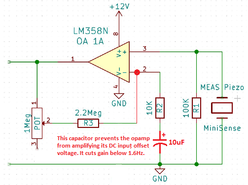

Back, a bit to the OEM schematic. The 500K to Vref basically forces U1b at 1/2 the supply voltage, so it actually sees above and below an artificial zero of 2.5V of the waveform. It's initially DC coupled, so the sensor and the OP amp offset is initially buffered too.
Don't use the TL082. The DC offset is too high.
Then they remove the offset with C10. C10 and R10 for a filter with a -3db frequency of )1/(2*Pi*10M*2.2e-9) or 72Hz, I think. =3db is the same as the signal has lost amplitude of sqrt(2) or about 70%. The point is called a "pole".
Your 'scope is set to 10ms per division and there is one division between the huge blue spikes so their frequency is 1/10ms= 100Hz, not 60Hz.
The opamp has some input offset voltage and is amplifying it so of course its output is not 0V. If you add a capacitor in series with the feedback ground resistor then it will not amplify the DC offset voltage.
Hi Ag,
I referred to the vertical blue dotted line which I positioned at the left side. If you look at the Oscilloscope screen pn the left lower corner there are the values in Yellow Letters
Cursor: Δ Time 16.4ms Δ Frequency 60.80Hz
When Moving the cursor that part showed me continuos different frequencies, and I left it at 60Hz in order to see if there was a relevant spike.
Thanks a lot for the hint with the capacitor in series with the Resistor at Pin 2. That did it.
I still have a max. voltage of 31.4mV when nothing moves but that voltage I also have it coming from the sensor directly.
When taking away the capacitor C1 the sensitivity increases but immediately the 60Hz noise comes back.
Below how the circuit looks right now before feeding the LM3914
Yea, primarily because you have a Hi Z blowing in the wind. High Z picks up everything. 60 Hz is everywhere. In the walls, ceiling etc.

From what I see in the FFT curve I have no 60Hz noise anymore because there is no relevant peak. The relevant peak is at 15Hz. From where comes that ?
My RC is ceramic capacitor 104 and carbon pot at 27KΩ
Look at the diagram below
A ceramic capacitor is a microphone and picks up vibrations and low frequency sound. Use a film capacitor instead. 104 is 0.1uF or 100nF.

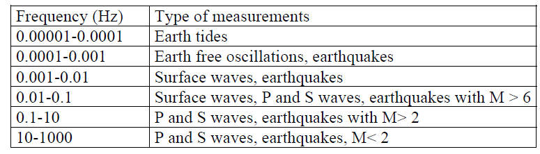

I would suggest your band of interest is 1 to 100Hz. You must convert g to v to x which is 2 integrations. ( like a low pass filter but infinite gain at DC)
Many cheap seismic sensors are limited >10Hz.
Seismic monitors vary from $10 to $10k.
High end seismic sensors using double integral charge amplifiers can range from DC -10kHz. I
I have used only these types which can easily be calibrated for g by free fall = -1g and ac displacement in μm with exceptional care.
Roof resonances can range all over the place above 1Hz.
Basically you want to buy a seismic sensor with a response down to 1Hz the $50 seismic geophones are good for 10 Hz. This will be far cleaner signal and more sensitive than your piezo . ( check amazon or ebay.) But you will be better off with amplifier included.
