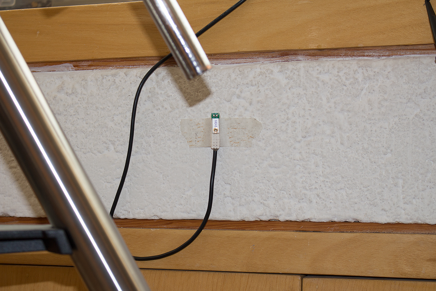

The sensor on the wall of my studio

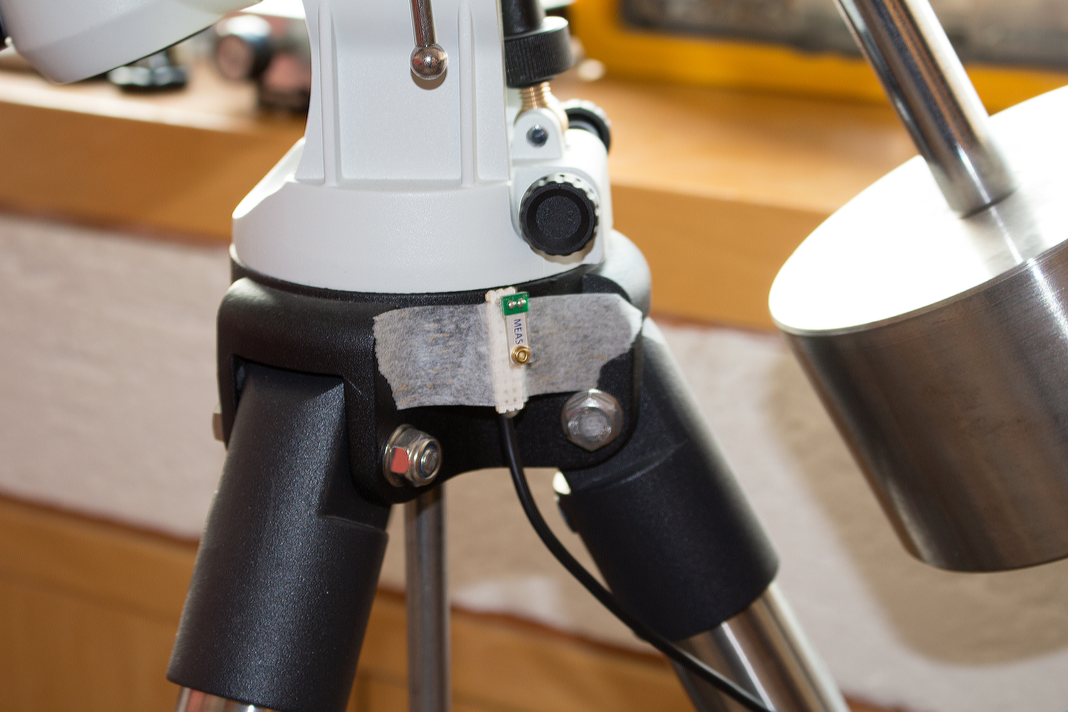

The sensor on a tripod of a equatorial mount

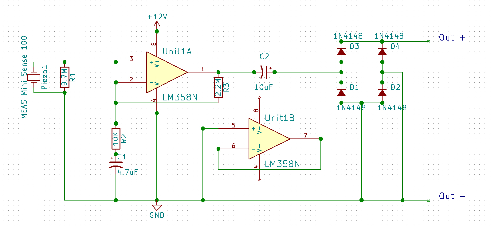

Below the schematics of the circuit
Thanks to all for all your help
Your circuit will not work:
1) The opamp is not biased so it will not have a proper AC output. The positive parts of the input will produce positive output pulses. The negative parts will do almost nothing.
2) The maximum input bias current of an LM358 is 250nA which is 0.25uA. Then if the input resistor to ground is 1M the input voltage will be +0.25V but your resistor is 9.7M so the input voltage will be 2.43V when there is no signal if your LM358 has the maximum input bias current. Use an opamp with a Fet input or reduce the value of the 9.7M resistor.
3) Your full wave bridge rectifier is not needed and does not work because it has only one input signal wire. Also the 10uF capacitor C2 is not needed.
If you need full wave rectification then you could use the unused opamp as an inverter to feed the other half of the full wave bridge rectifier.

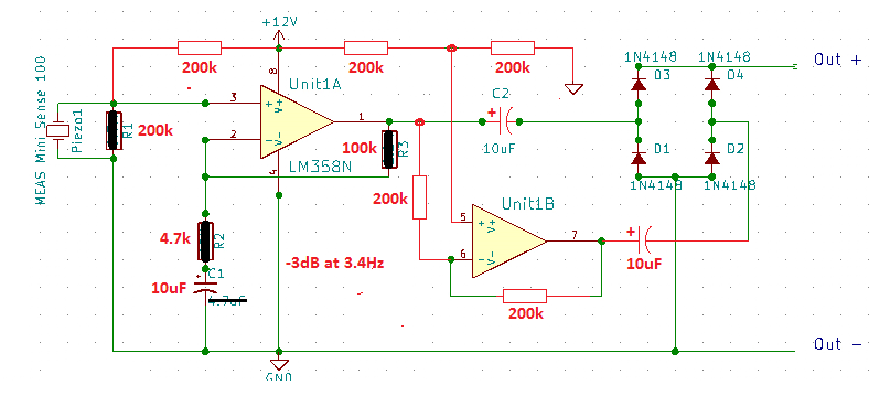

I fixed it for you.
But the rectifier is not active so it does nothing until the signal peaks are more than about 0.6V.

I do not know if the MC3408x opamps in Mexico are the version that must not have a gain less than 2 so they cannot be used for the inverting opamp I drew unless you add an attenuator and change my circuit. Also these opamps will not work in my circuit unless you add an additional negative power supply for them.
Your latest scope video with the LM358 shows that its output is at a positive voltage determined by its input bias current in R1. But R1 connects to ground so the input and output should be referenced to 0V. Since you have the (+) input of the opamp biased at 0V with R1 then the output is also supposed to be referenced to 0V then the signal would be half-wave rectified by the opamp but it isn't due to the input bias current in R1 raising it.
You use 4 diodes in the bridge but only D3 is doing anything and it acts like a half-wave rectifier.
Hi AG,
So this means that also in your circuit nothing happens if the output signal from Unit1B is lower then 0.6V ¿ did I understand that correct ?
I took a look at the upper part and if I understand correctly you are feeding additionally 6V into pin 3 from Unit1A as well as into pin 5 from Unit1B.
What is the purpose of that ?
If I interpret the wiring of the Unit1B correctly is has a gain of 1 and it just takes the negative part of my Sinus wave at Pin 1 and sends it to the full bridde rectifier and so I get both portions of the sinus wave from Pin 1 at my outputs marked Out + and Out -
:confused:

I guess your rectifier's load is the 1M or 10M input resistance of your 'scope so when D3 conducts slightly it is enough to show some half-wave rectified output.
My circuit biases the (+) input of the opamps at half the supply voltage so that their outputs can swing equally up and down so that the full-wave rectifier works properly.

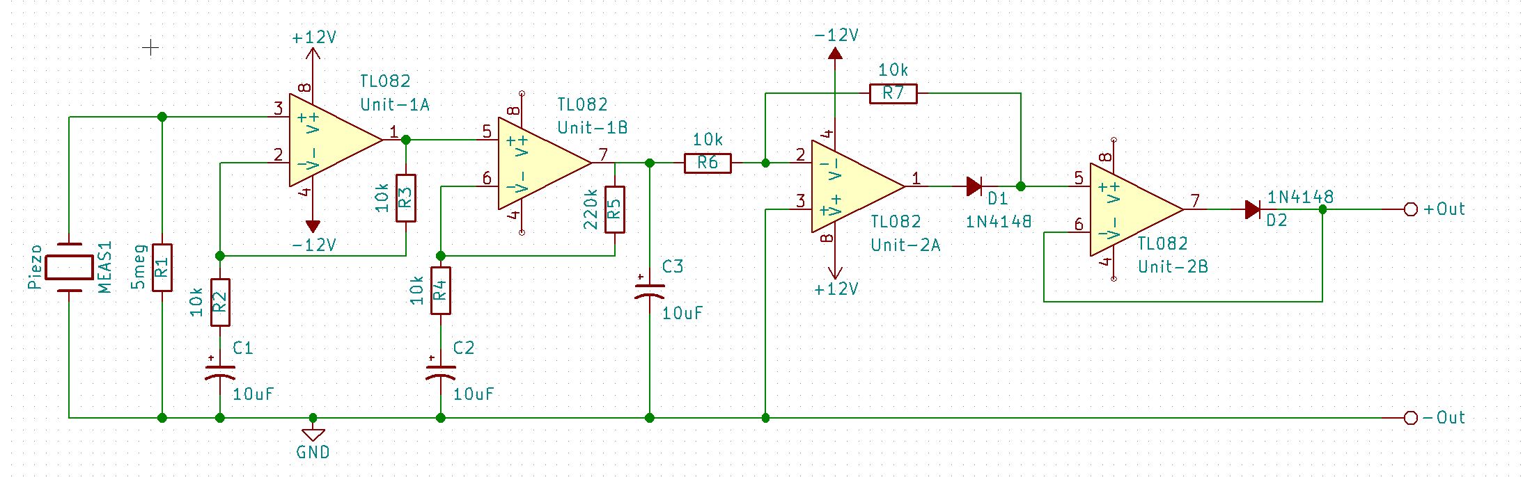

Your circuit has many parts that are not needed.
Capacitor C2 passes AC but not DC so the second opamp amplifies vibrations with a gain of 23 times but does not amplify its DC input offset voltage.
The first opamp has a gain of only 2 so it is not needed and the gain of the second opamp can be doubled instead.
You are using a polarized capacitor for C2 which has AC across it that is wrong. If the values of R4 and R5 are increased then capacitor C2 can be a small film (non-polarized) capacitor.
C3 is SHORTING the output of the second opamp so it should be removed. If you want to cut high frequencies then add an RC filter at the output of the opamp, my R6 and C3 cut frequencies above 97Hz.
You do not need two rectifying opamps.
My added diode prevents the rectifier opamp from saturating as low as it can go.
EDIT: I deleted my circuit because its halfwave rectifier was completely WRONG!
