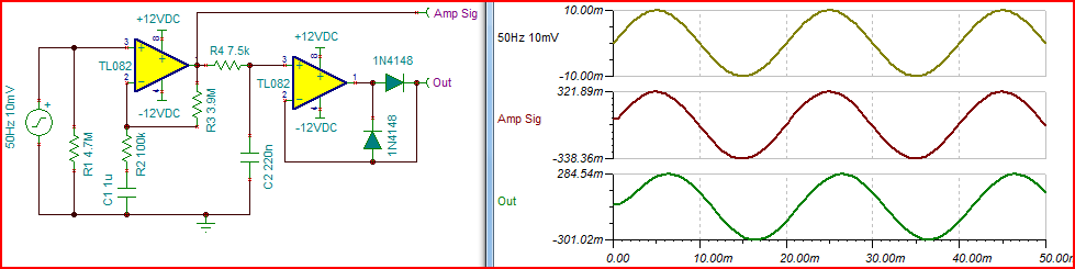

Your circuit has many parts that are not needed.
Capacitor C2 passes AC but not DC so the second opamp amplifies vibrations with a gain of 23 times but does not amplify its DC input offset voltage.
The first opamp has a gain of only 2 so it is not needed and the gain of the second opamp can be doubled instead.
You are using a polarized capacitor for C2 which has AC across it that is wrong. If the values of R4 and R5 are increased then capacitor C2 can be a small film (non-polarized) capacitor.
C3 is SHORTING the output of the second opamp so it should be removed. If you want to cut high frequencies then add an RC filter at the output of the opamp, my R6 and C3 cut frequencies above 97Hz.
You do not need two rectifying opamps.
My added diode prevents the rectifier opamp from saturating as low as it can go.

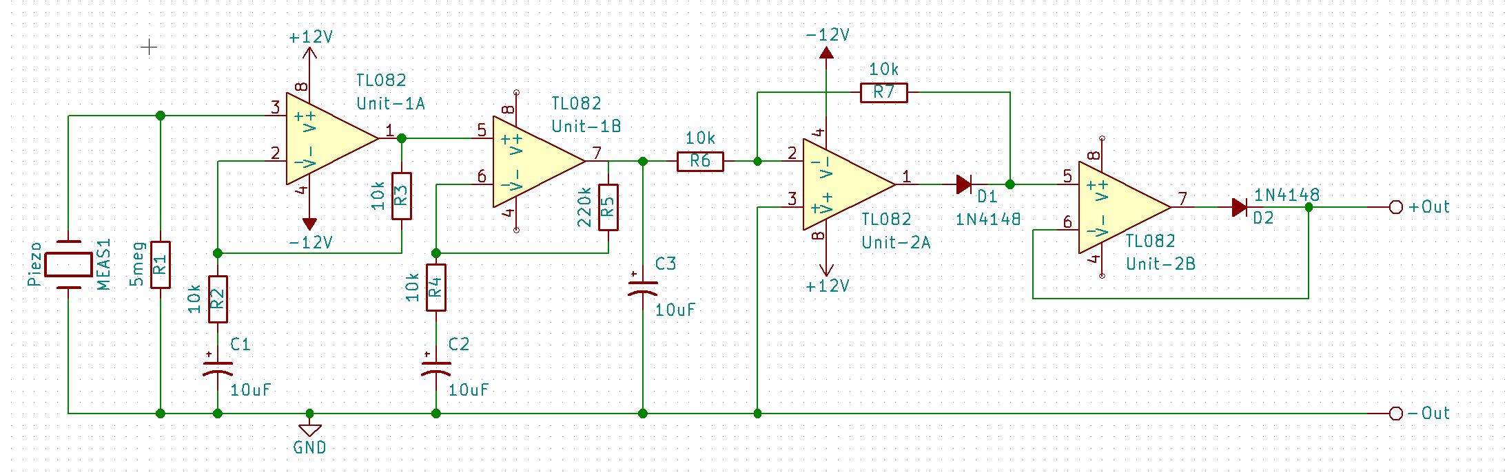

Thanks AG for the circuit. Will breadboard your circuit today afternoon. I do not have a Film 1uF capcaitor. Can I take an Elko ?
Hi AG,
Question from a Dummy or better said ¿ DO I understand your full wave rectifier correctly ?
The AC wave goes into the NonInverting input and Diode D2 letpass the Positive part. The negative wave is rerouted through Diode 1 into the Inverting Input and inverted to a positive Wave which fill up the space between the positive wave ¿ Is my thinking correct ? o_O
Thanks for the 5MΩ hint. Yes that is a 4.7MΩ but I measured it and it gives me 4.93MΩ and that is why I put there 5MΩ. Next time I will stick to the correct denomination of the resistor. Sorry

My bigger comments is to short C1 and short D1 (easy to test)
Glad you used a bipolar supply.
Possibly add full wave precision diode.

Hi KISS,
Thanks will try and see what is the outcome on the Oscilloscope.
The second OpAmp TL082 is according to me, a Precision Full Wave rectifier or " Full Wave Precision Diode " as you call it.

Just breadboarded your circuit with components I have here.
Is it supposed to give me a rectified output ? Because what I saw is a variable Sine Wave at the output (typical for a vibration curve eg. Car shock absorber) in the same way as I get when I use my circuit
That's what I got with a SIM as well, rsfoto:
Which makes sense since first one diode conducts and then the other does and so, presto - a sine wave out. Not sure what this part of the circuit is supposed to do but rectification, best I can tell, is not what its doing.

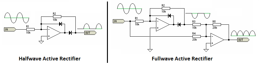

Yes, my halfwave rectifier circuit was wrong. You almost had it correctly.
Here is a good halfwave active rectifier and a good fullwave active rectifier:

Hi AG,
Thanks. I have seen those active rectifier circuits and many many more. So in any case if I use an active full wave rectifier circuit I will need a double Op Amp chip :(
My second Op Amp is an active full wave rectifier ;) I will think about an active rectifier and see if I can live with a 4 diode bridge rectifier, which would make the output by far more simple :wideyed:

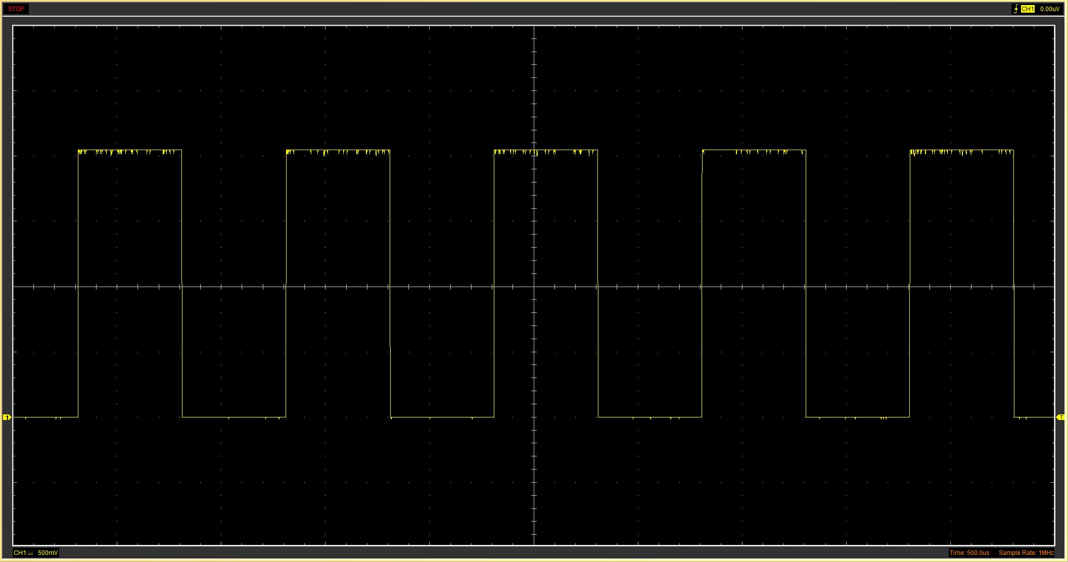

Hi AG, KISS and cowboybob,
How can I avoid that the 1MΩ resistance of my oscilloscope probe does not influence the measuring value ? Using a capacitor and if yes any value would do it ?
Another problem is that I have a slight negative amount of voltage = -11.9mV at the output of my active FW rectifier.
If you use a x10 or greater "real oscilloscope probe", the effective input Z become 10 Meg ohms.
The scope's 9 M is in series with the 1 Meg in the scope.
This https://www.radio-electronics.com/info/t_and_m/oscilloscope/oscilloscope-probes.php is a better explanation.
Very short version:
The scope is typically 9 M in parallel with 22 pf. A 10 x probe is typically 1 M with a variable capacitor. The coax of the probe adds capacitance and you WANT the scope to see something purely resistive.
The artifacts show up at high frequencies and the edge of a square wave is composed of many frequencies (sorry, short answer says I won't discuss further). So, you get artifacts like shown in the photos. These ARTIFACTS are adjusted out by using the "calibrate" signal of the scope which is typically a kHz and a small amplitude.
So you adjust the variable capacitor on the probe, until you gate a square wave. On the x1 scale , if the probe has one, the adjustment is covered on most probes.

The 4 diodes bridge does not work in your simple circuit. Your second rectifier opamp is not an active fullwave rectifier because it simply duplicated the same halfwave from the first opamp rectifier.

Hi AG,
Thanks, Yes the numbering is known to me :)
By the way you have much more experience in Electronics then me but I do not agree with you about the statement
quote: " ... it simply duplicated the same halfwave from the first opamp rectifier ... "
Look at the analysis of one of the frames of my video I posted before.
My logic tells me that if that would be the case, then I should be seeing same 2 peaks repeated which is not the case. Look at the attached image
I will do a test and measure my FW rectifier.

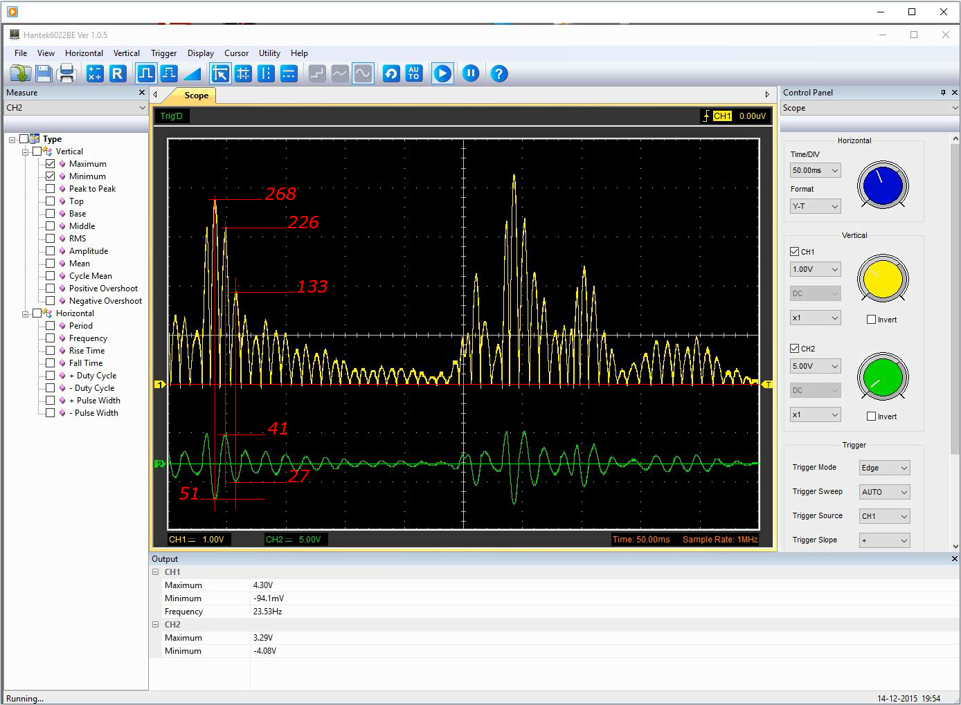

Hi KISS,
Somewhere you mentioned the calibration of the Oscilloscope. I made a screenshot of probe 1 and so far I think the calibration is quite good
Yep, it's just that a 10x probe (common) increases the input Z from 1M to 10 M.
A half wave rectifier will keep the same frequency in, A full wave rectifier will double the ripple frequency.
e.g. 60 Hz half wave rectified --> 60 Hz ripple. Full wave rectified --> 120 Hz

Hi KISS;
Thanks for confirming that I have a FW rectifier at the output :cool: look at the values at the pointing green arrows.

10 M: The tek full version is too complicated for now. Look here: https://electronicdesign.com/test-a...ive-and-active-oscilloscope-probes-your-tasks
A 10 X compensated probe on a 1 M || 22 pf scope makes your oscilloscope probe appear to the circuit as a10 Meg resistor.
If you "extended" the probe with a piece of coax, you may not be able to compensate it.
RG-174 is a thin 50 ohm coax. It has a capacitance of about 22 pf/foot. The whole point is the cable also has attenuations based on frequency and length. With a scope, you want the tip of the probe to be resistive. Hence, compensation. usually it's associated with high frequencies, but a 10 Hz square wave with a very fast rise time requires a bandwidth greater than 10 Hz to see it.
The probe is like a voltage divider, but it really is an impedance divider, hence the variable capacitor.
The scope is made intentionally complex 1M || 22 pf to accommodate probes that have capacitance.

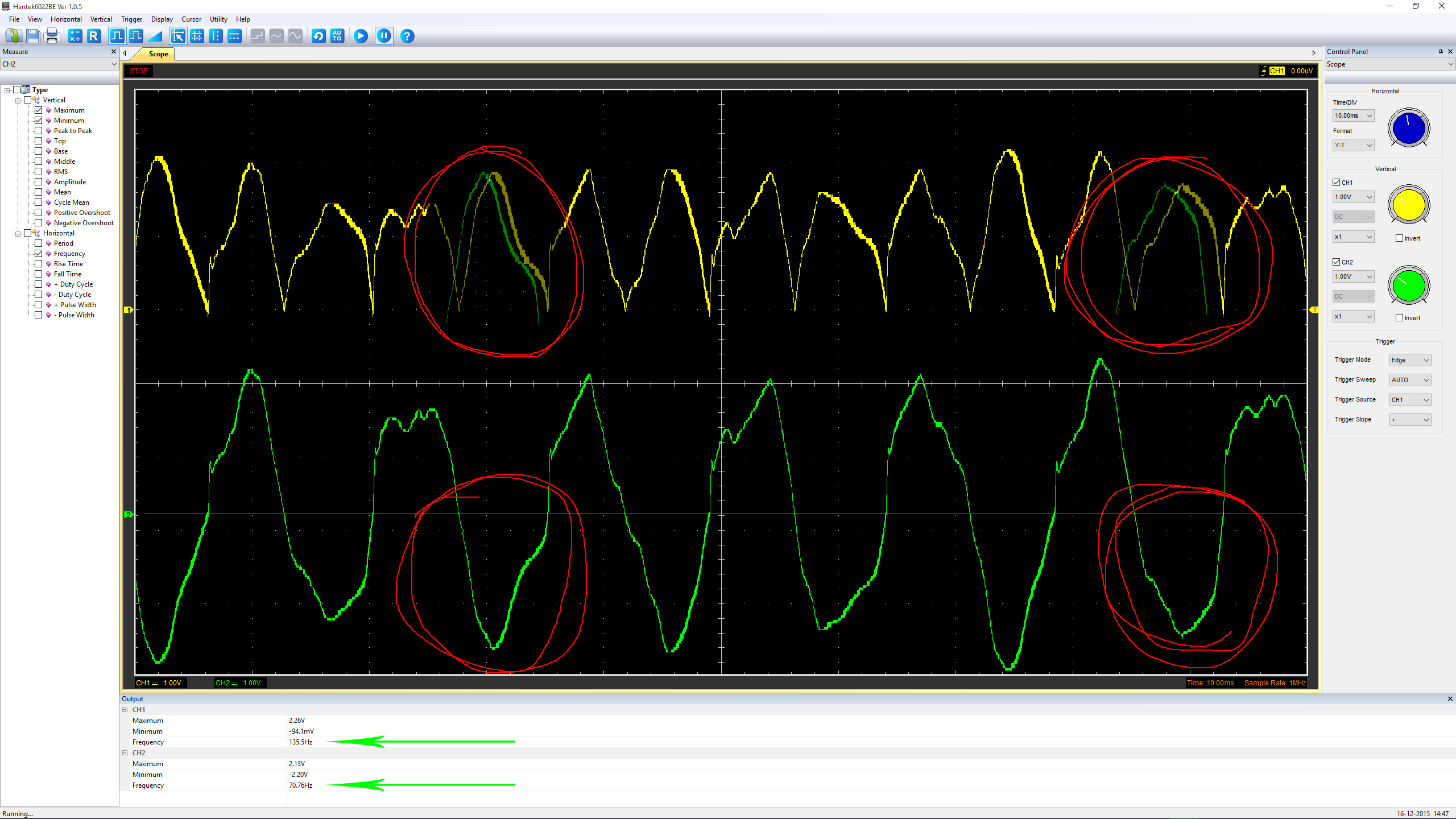

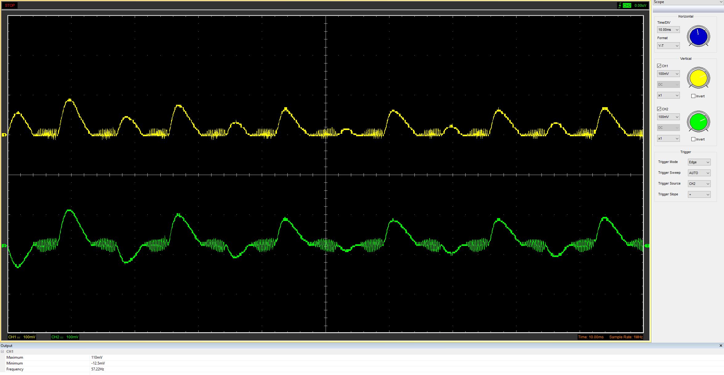

I have a question.
I am working with my circuit as you can see below. I may sound stubborn, but that is the one I have found most useful so far in regard to sensitivity Gain of 100x eg, resistor R5 is 1MΩ
Now having glued the piezo on the wall I am getting a signal, red circles. From where does it come and how can I kill it. If my calculation is correct it is a 3000 to 4000Hz frequency

Answering my own question = I have changed the Elko 10uF C1 for a 1uF Film capacitor and eliminated C3 so far and still experimenting.
First thought is a mechanical source, such as an HVAC fan or heat/AC motor. Sympathetic harmonic vibrations from the 50/60Hz powered hardware in your home/office/neighborhood.
Don't forget, your piezo sensor is very sensitive across a wide range of vibration frequencies. You may end up having to insert some filters into your circuit to "dump" (or block) the unwanted noise.
