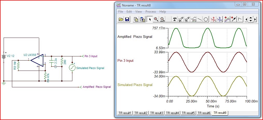

rsfoto,
Is this what your trying to do?:
The amplified sig is "bellied" (and ugly) since the Piezo sig is dropping below the minimum signal level for the OpAmp . The belly is from the cap discharging/charging. The belly "effect" starts at about the zero point of the sim'ed voltage level of 0VAC.
If we up the sim'ed signal to 68mV P-P, the 34mV sig you first envisioned gives slightly more than the 723mV you mentioned in your first post.
Notice the flatter "belly".
Hi cowboybob,
Great. That is exactly what I have been looking. The signal form of the output does not matter. After amplifying the AC signal from the piezo sensor I want to activate some leds using a LM3419.
I guess I can flatten the output with a cap.
May I ask what program is that for simulating the circuit and where can I find it ?
Again thanks and regards Rainer
PD I will test that circuit right now ;)

You need to hit the piezo VERY HARD with a hammer for it to produce a signal into the very low value 280 ohm resistor. I think you said it will be used to sense (small) vibration from a telescope turntable?
Most piezo vibration circuits have the piezo loaded with a high value resistor that biases the opamp input at 0V, then a diode prevents the piezo output from damaging the opamp input with a negative voltage. A zener diode is used to prevent a strong knock on the piezo from damaging the opamp input with a positive voltage that is too high.
