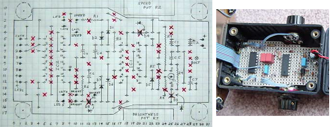

On stripboard only one wire is soldered in a hole then it is easy to desolder a part to replace it or change a resistor or capacitor value.
Here is an example:
Desolder them and solder the new again into it ?
Yes, it's simple to do so - bear in mind you shouldn't be randomly guessing at values, the circuit should be designed and calculated correctly before you ever touch a soldering iron, so you should only need to 'tweak' an odd value or two.

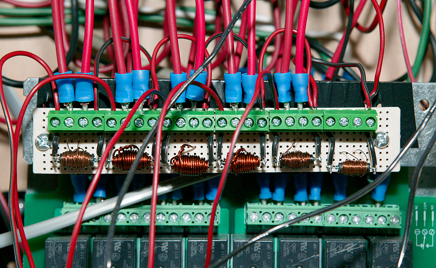

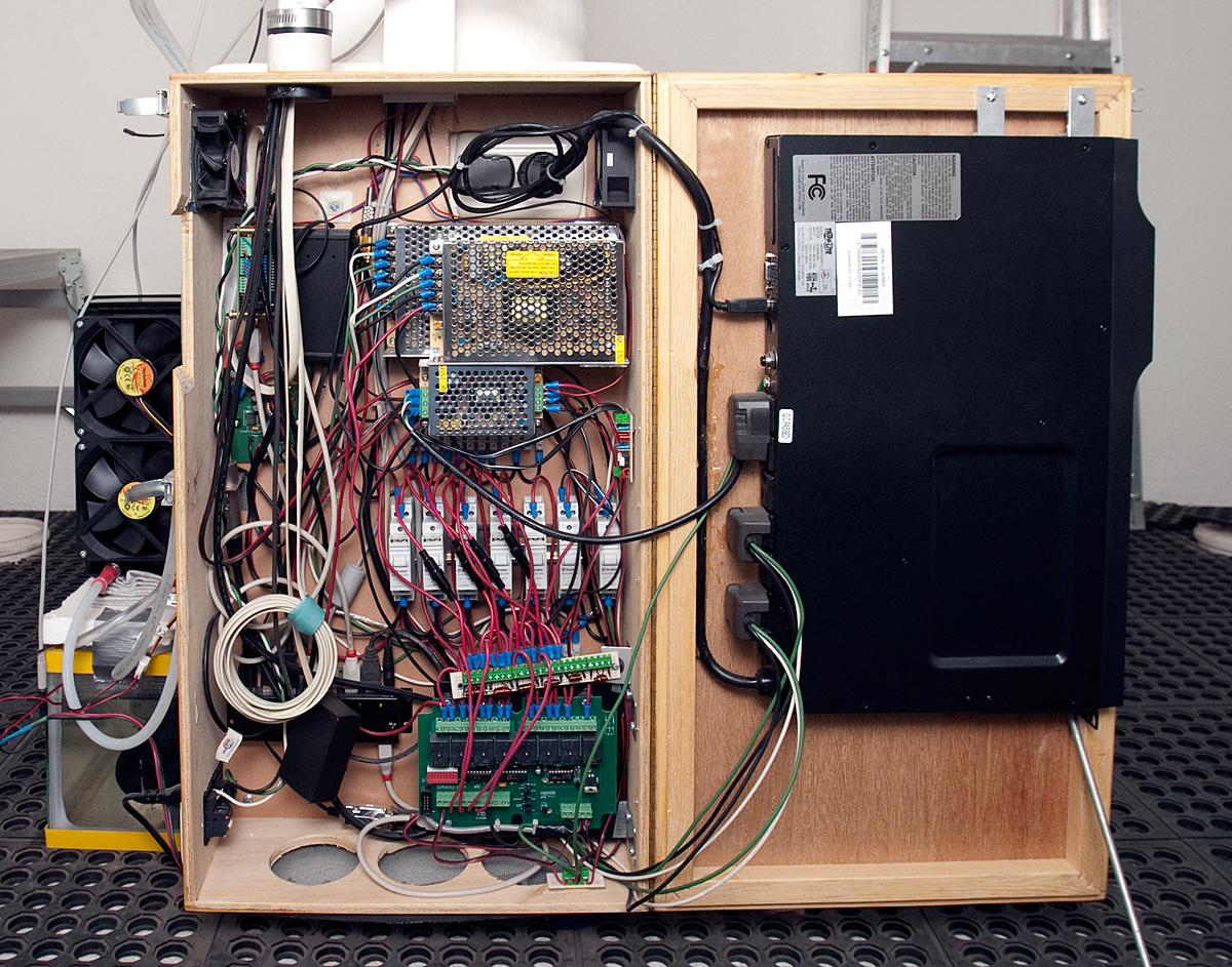

By the way I developed the whole wiring and mechanical logic for my observatory for being remote controlled. Look at the images below. I even thought how to measure the current, (peanuts for you but not for me until I found the logic how to do it), of the connected devices in order to know if they are working or not, I went from the point that measuring voltage was a nonsense as the device could be connected but if it is not drawing current it is not working. So I made manually a simple current loop detector or whatever it is called.

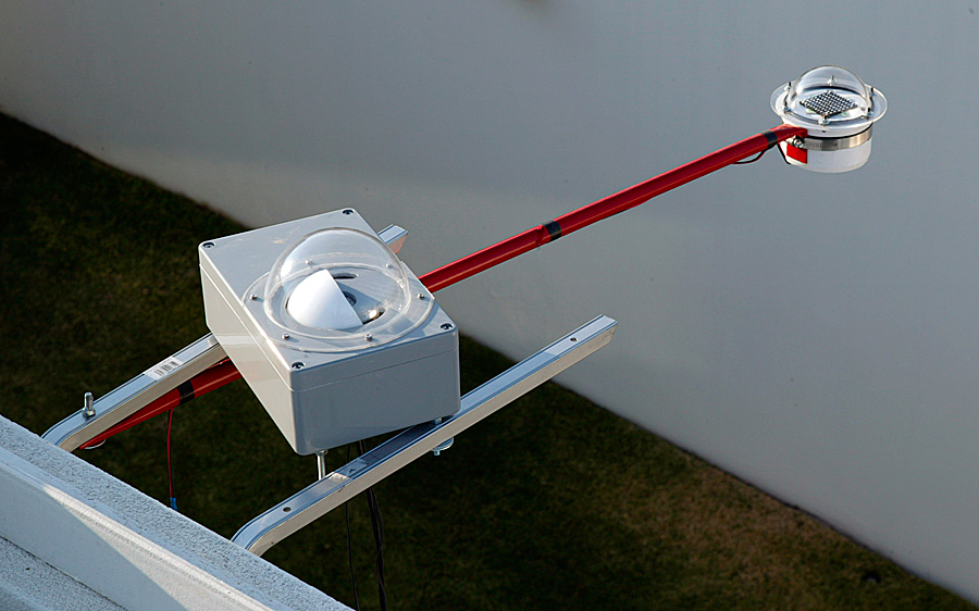

Yes right but that is no fun. I once made a amplifier using the INA122P for building a cloud detector and that worked. I searched the internet how to do it and it is working. The thing at the end of the red pipe
BTW the grey case is a custom made 180° All Sky camera also made by me.
Below you can see some of the wiring working in my Observatory
