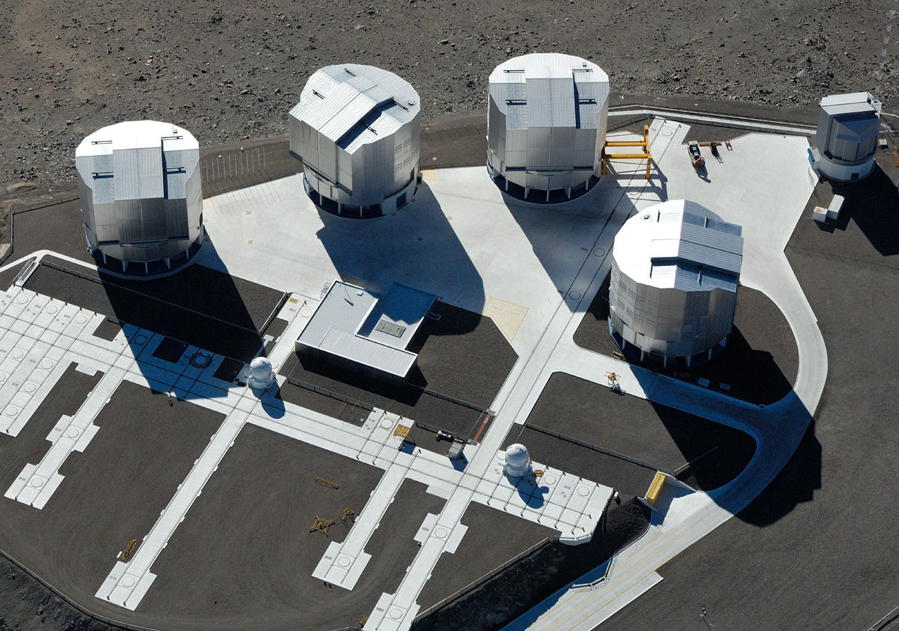

VLT from the ESO at the top of the Paranal mountain in Chile :wideyed:
My columns are sitting on a dense clay formation (no rocks available where I bought the house :arghh: ) This clay I remember being a young boy was really hard to dig. We had to use steel bars and inch by inch we were able to dig the trenches for the foundations of whatever was going to be build.

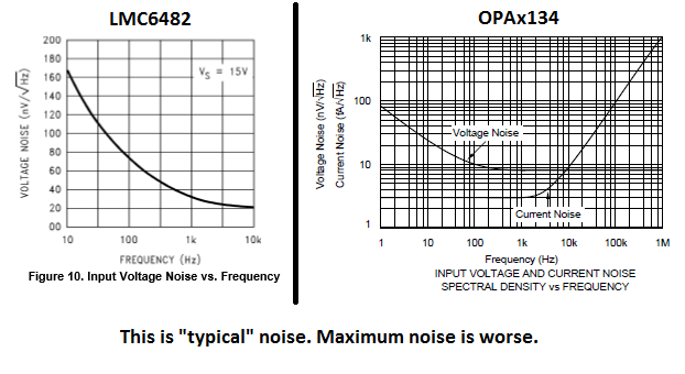

Like most Cmos opamps, the LM6482 is fairly noisy with 5 times as much noise as a low noise OPAx134. It is not suitable for your very high gain preamp.
Yes I looked at the correct datasheet of the LMC6482 where "C" is Cmos. It is a noisy son of a bxxxx.

For his application does that really matter? What sort of noise numbers should he be looking for? I am just curious because nV/Hz seems pretty low to me, so I hope to learn something here.

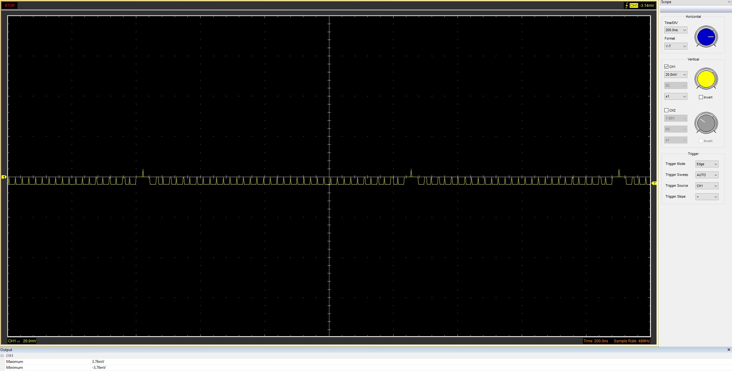

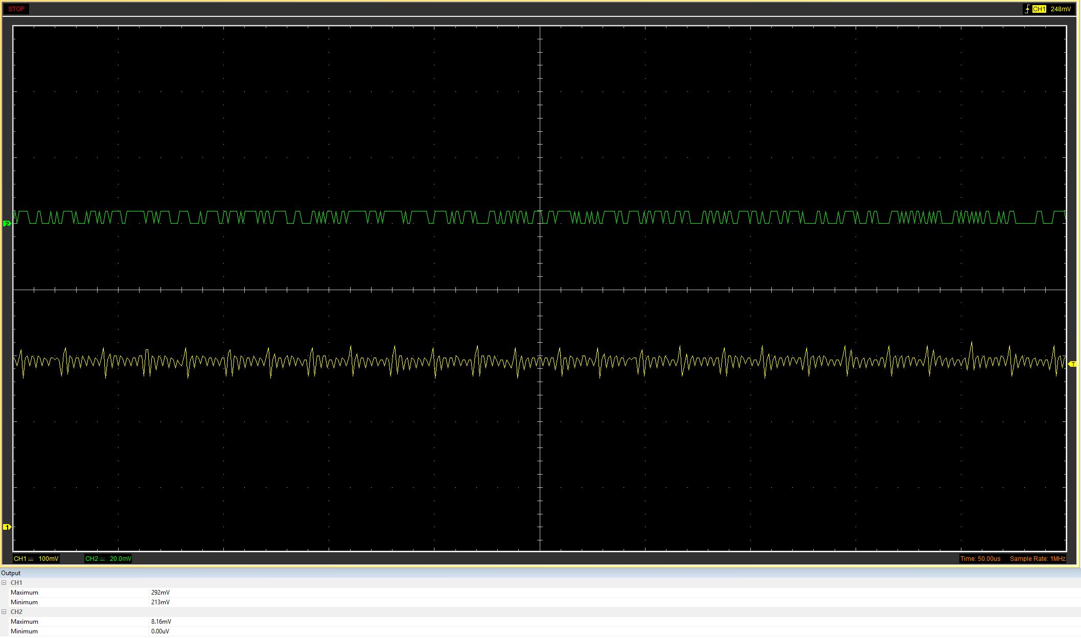

Hi KISS,
Well if you look at the signals I compared from the amplified Piezo = Yellow line as well as from the unamplified direct signal = Green Line from the other Piezo, I see that the yellow amplified curve looks similar to a noise curve from a power supply from a video I just saw.
So analyzing the strange positive / negative saw tooth curve of the amplified that comes from my DC Power supply. I have not yet measured the DC power supply noise. Will look in the internet how to do that

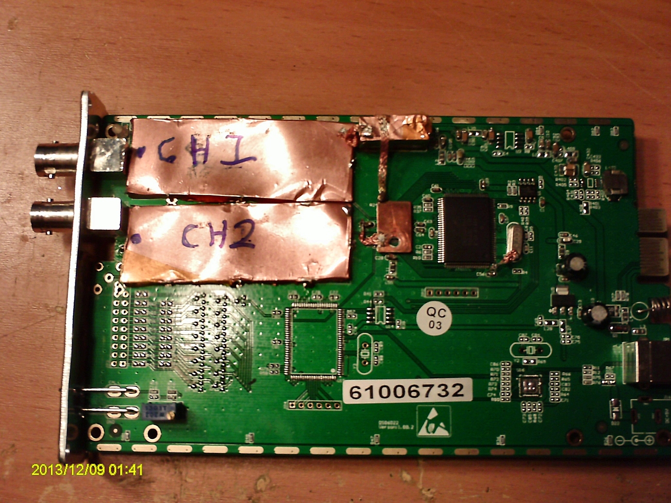

I read somewhere how to shield the inputs of the Oscilloscope Hantek 6022BE. Should I start there ?
Just saw a video of Texas Instruments how to properly measure with the probes
Will keep doing my homework
His gain is 300 which is much more than a phono preamp. If you used a noisy opamp as a phono preamp then the noise that is heard and that would be displayed will be high.

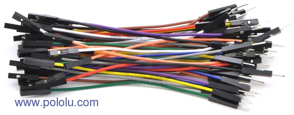

Another point is that I am using 3" cables with pins for my bread board connections ...
Mikebits: The OPA is about 7x less noisy at 100 Hz.
rsfoto: Your wierd sawtooth noise on a linear power supply battery explained: **broken link removed** My way, the cap gets charged to a peak voltage and then acts like a discharging capacitor y when the signal goes away.

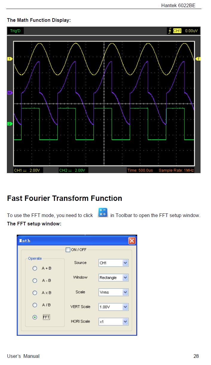

I doubt you scope does FFT's (Fast Fourier Transforms)? That lets you look at signals by frequency component.
How often in time to the higher spikes occur? 1/t = frequency.
Look here: https://en.wikipedia.org/wiki/Shot_noise under the Title Electronic Devices and read the first paragraph only.
Yes, it looks like your very high power Chang Chung power supply switches at 52kHz and also produces the other high frequency seen on your 'scope. You will not see the interference if that power supply is turned off and you use a battery instead.
Each and every wire on your solderless breadboard is an antenna that picks up interference and causes coupling in the high gain circuit which might produce oscillation.
You CANNOT use a solderless breadboard for such a high gain circuit.

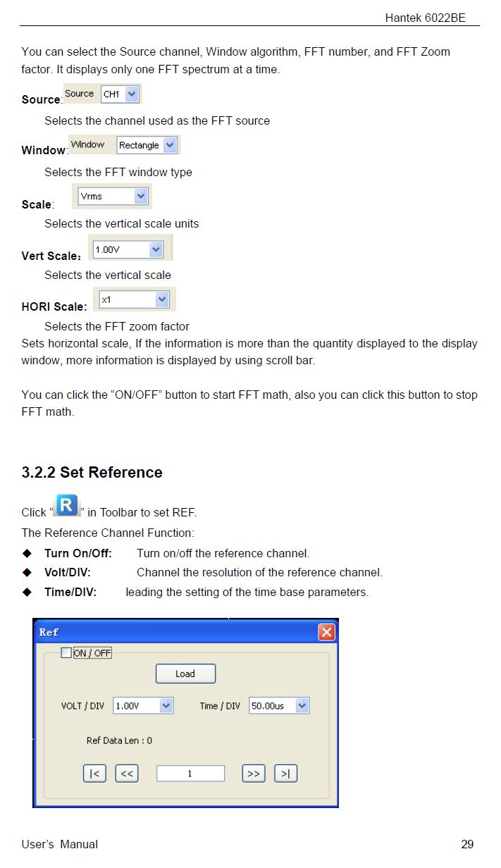

Hi KISS,
Yes it has in the software a built in FFT function
and here is the output of the oscilloscope when I connect the ground of the probe to the clip
What is your veredict ? :nailbiting: :nailbiting: :nailbiting: :nailbiting:
