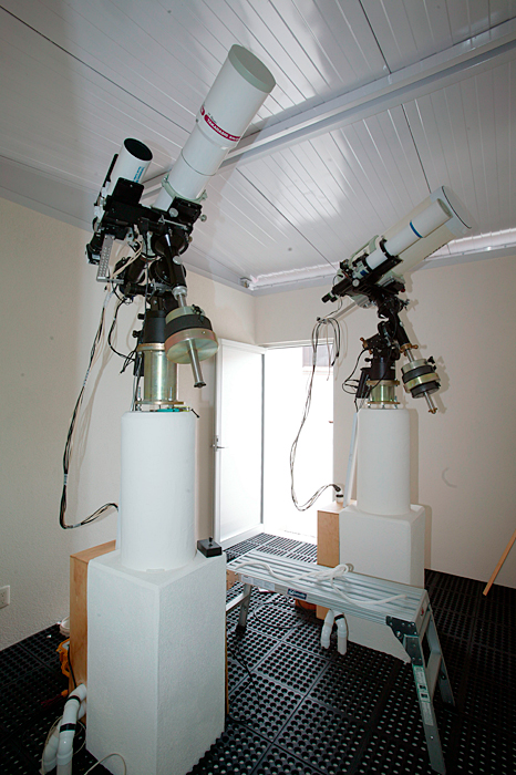

BTW this project is going to be used to help other amateur astronomers to find out how much their piers or columns vibrate as many of them have the observatory build on the roofs of their houses.

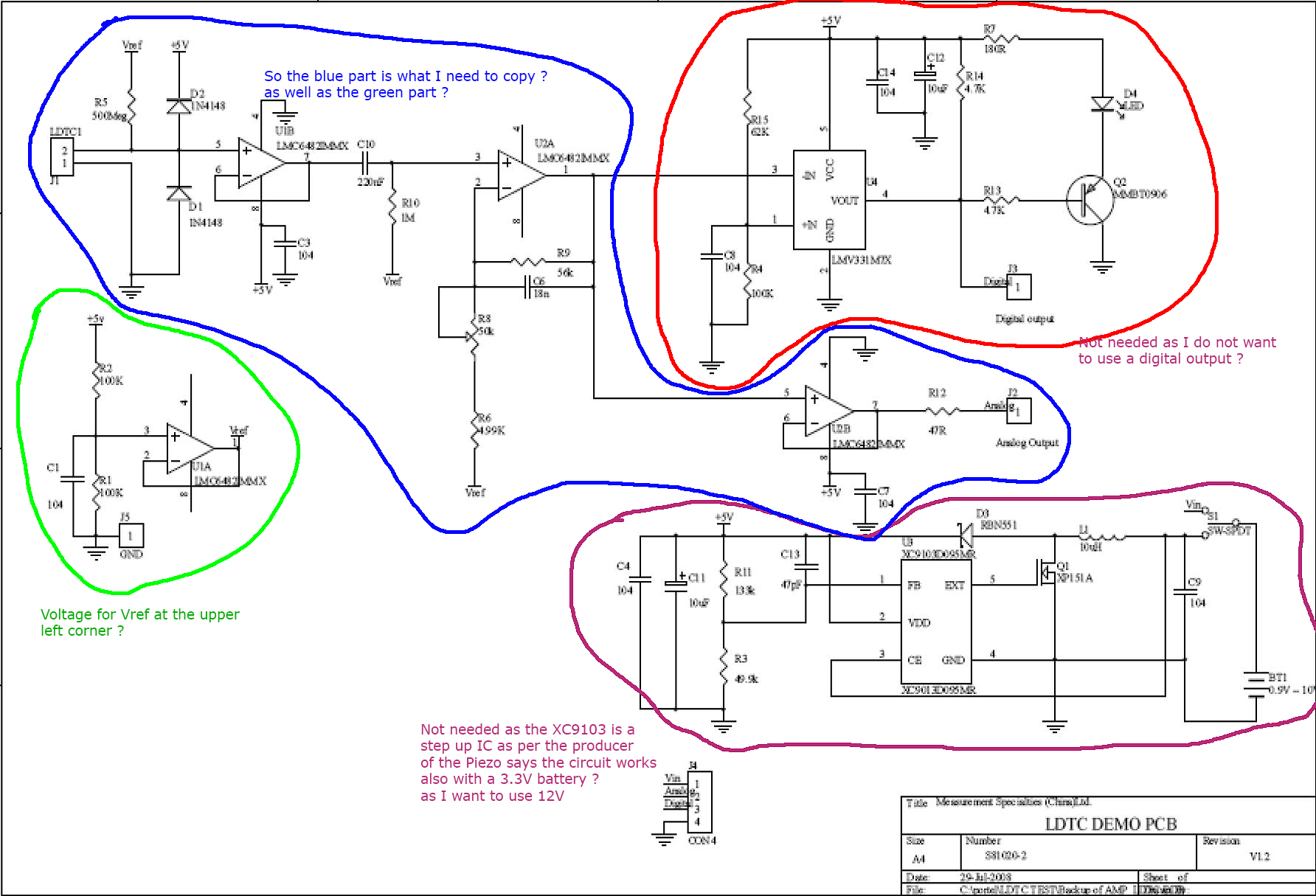

OK, let me see if this is what I need
I cannot read the fuzzy part number of the opamps but they are LMCxxx which is Cmos (VERY high input impedance). The opamps might have a maximum supply of 6V so the voltage converter IC efficiently converts the 9V battery to a regulated 5V.
Vref biases the inputs of the opamps at half the +5V supply voltage so that their outputs can swing equally up and down, the piezo sensor is not affected by the DC.
The voltage comparator is very sensitive so if you want a linear output then you need more gain and a half-wave detector.

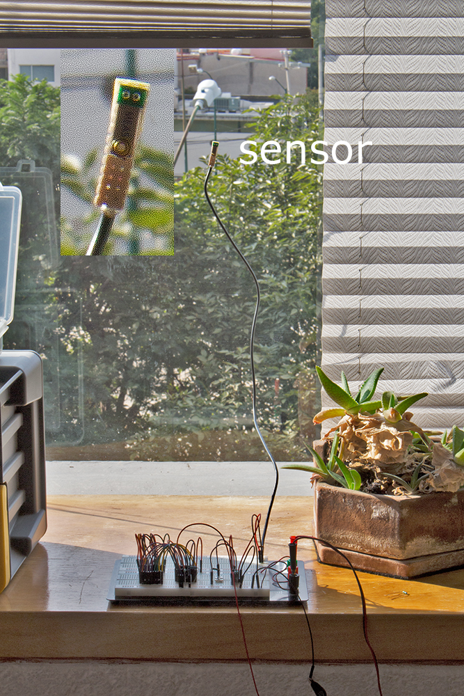

Out put as sensitive as possible. At the moment I am driving with the output of the amplifier a LM3914 and with an output signal of about 230mV i can see the second LED flickering very lightly. The bar goes from 0V to 1.25V, so if my calculation is correct and the piezo is really linear I would sense at an input of 4.2mV a g force of about 0.0042g. At the moment I do not know if that is little or much. I will have to inform myself about this value.

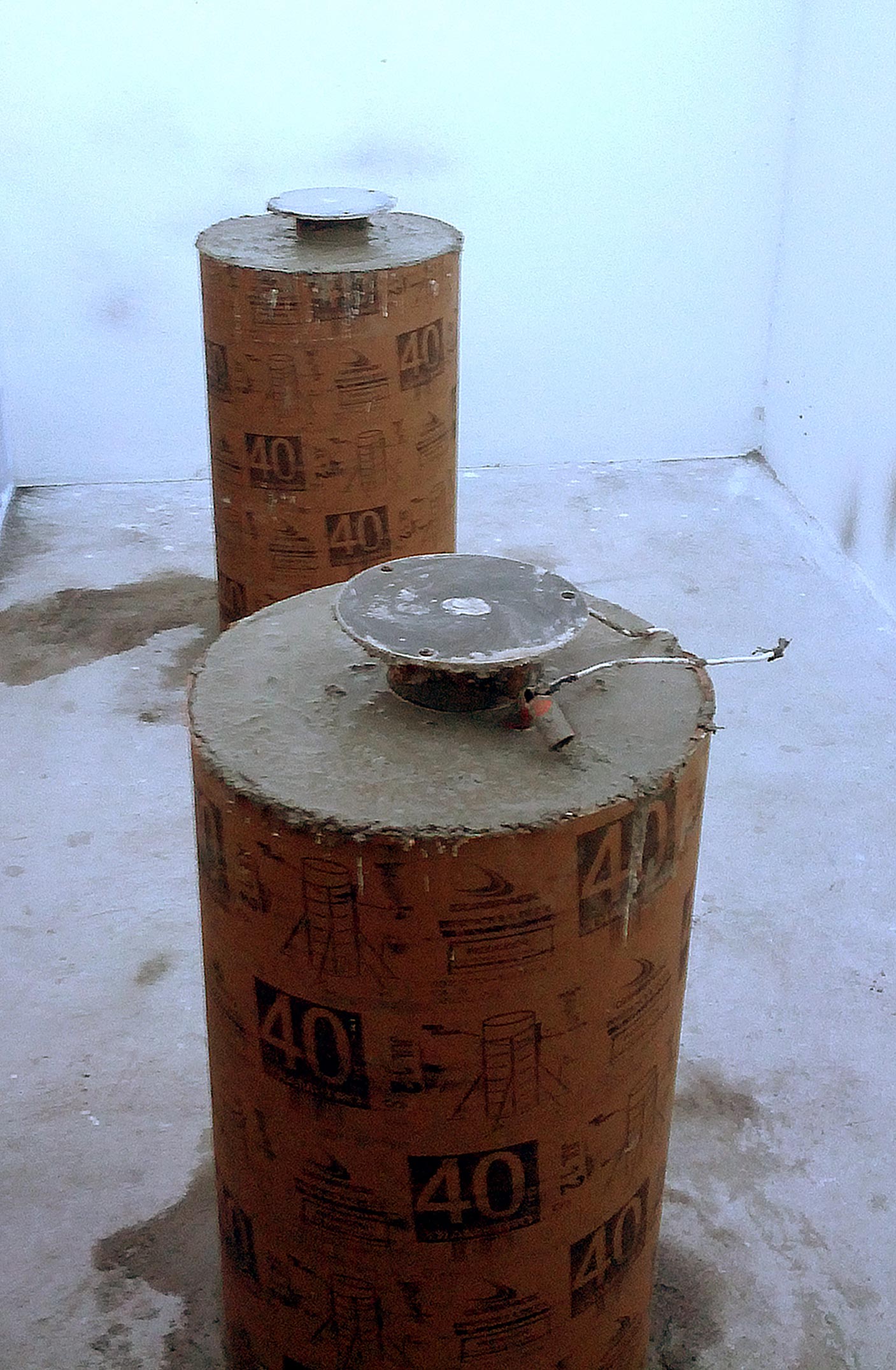

So far I think I have achieved what I wanted. I will put them on my columns to get an idea. See image of my columns. Each column has a weight of about 6,850kg ~ 15,100 pounds and the telescopes are at a height of about 6.2m ~ 20 feet 4 inches
View of the inside of the observatory

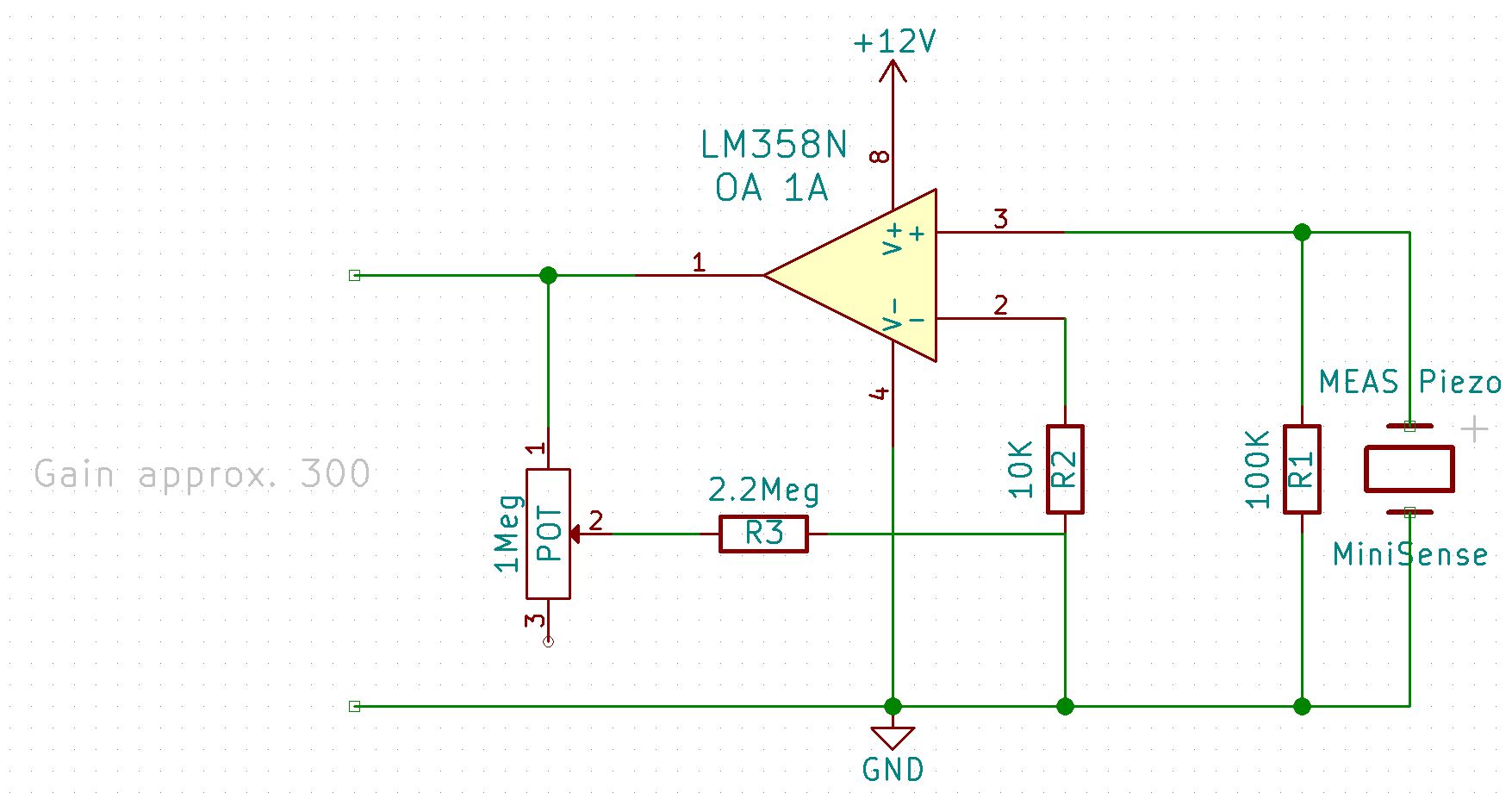

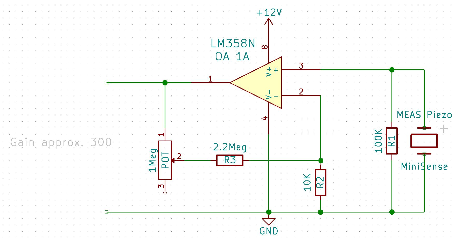

At the moment, as the circuit per attached image is, I am working with a gain of ~300.
Now the piezo is glued to a big window and I am waiting for cars to pass by. BTW I do live in a 4th floor about 12.5m above street level. So far I have a change in the curve when a car passes by and so I guess it is working, but as written before I can not judge it until I know what signal I do get from my columns and then I can compare more or less the columns of my friends observatories.
So far I am a happy

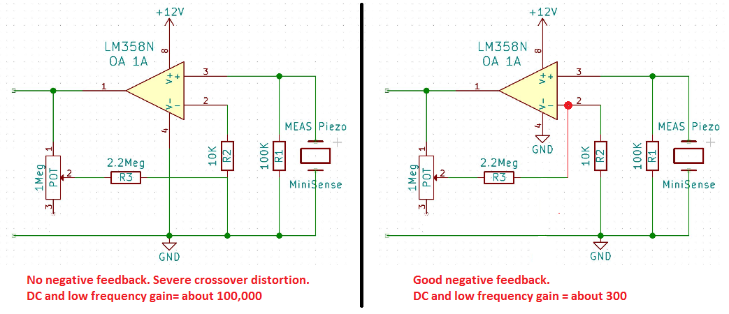

drawing error, corrected below

Your circuit has a serious error as shown in my attachment.
It has another error that it amplifies the DC input offset voltage of the opamp. An LM358 has a maximum input offset voltage of 7mV which produces an output as high as (7mV x 300=) 2.1V with no input signal.
The DC gain can be reduced to 1 by adding a capacitor in series with R2.
EDIT: The input offset voltage might be negative then the output will not show anything until the input signal is very high.

dont worry about it audioguru, he needs the offset to bias his LED.
The LEDs are driven by an LM3914 bar graph driver with a full scale input of 1.25V.
Hi Tony,
Thanks for the correction and yes my bread board is wired like that.

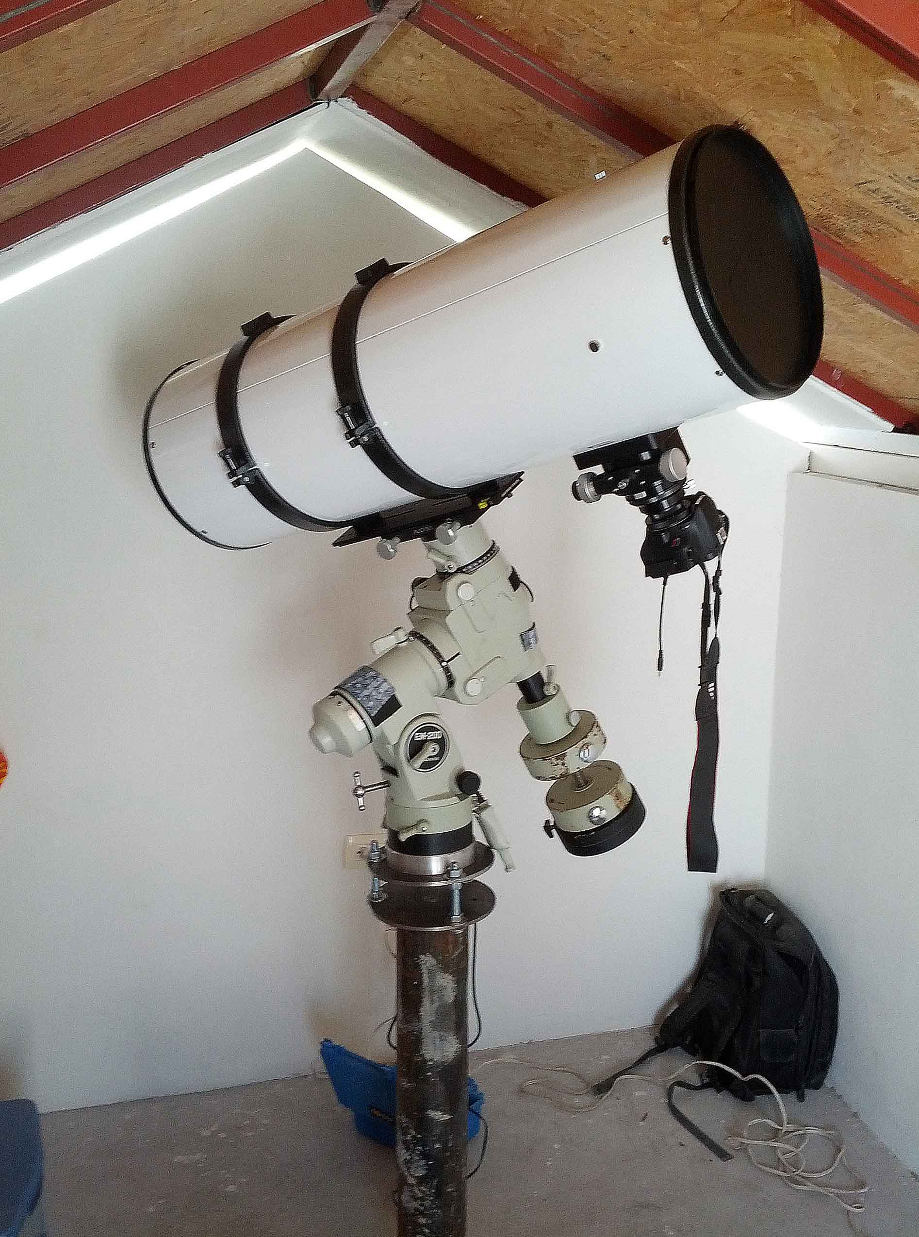

Yes it moves. I mentioned in this case soil but as I wrote somewhere before som astronomers do build their observatories on the roof of their houses. Here in México all houses except the designer houses have a flat roof.

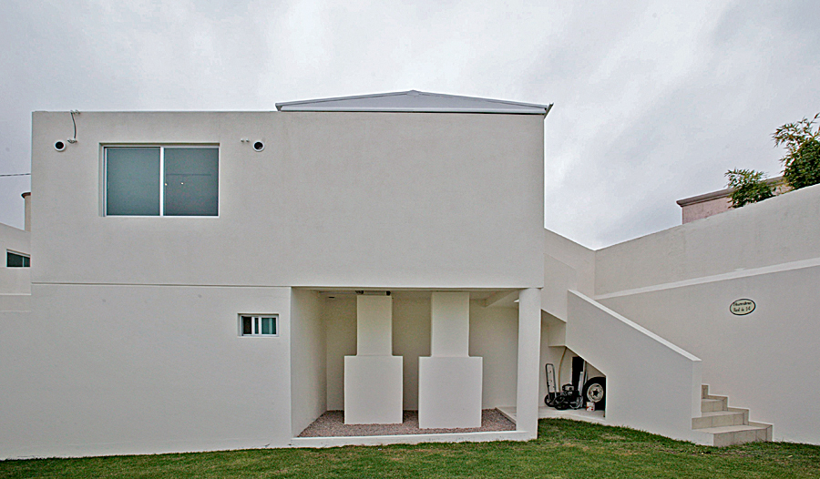

If you ever had a telescope on the roof of your house and your kids running below it, I bet with you you can see the telescope moving while visually observing. Another source of vibration is when big trucks, like the garbage collecting trucks, etc., pass near your house you can also detect the vibrations of the pier on your house roof, etc.
Look at message #96 . That is an example of an observatory on the roof of a house. Even worse when he does not control the telescope from a room below or he did not build the pier over a cross made by walls which normally are less prone to vibration.
Yes the error was in the diagram but the wiring is correct. Tony already corrected it before.

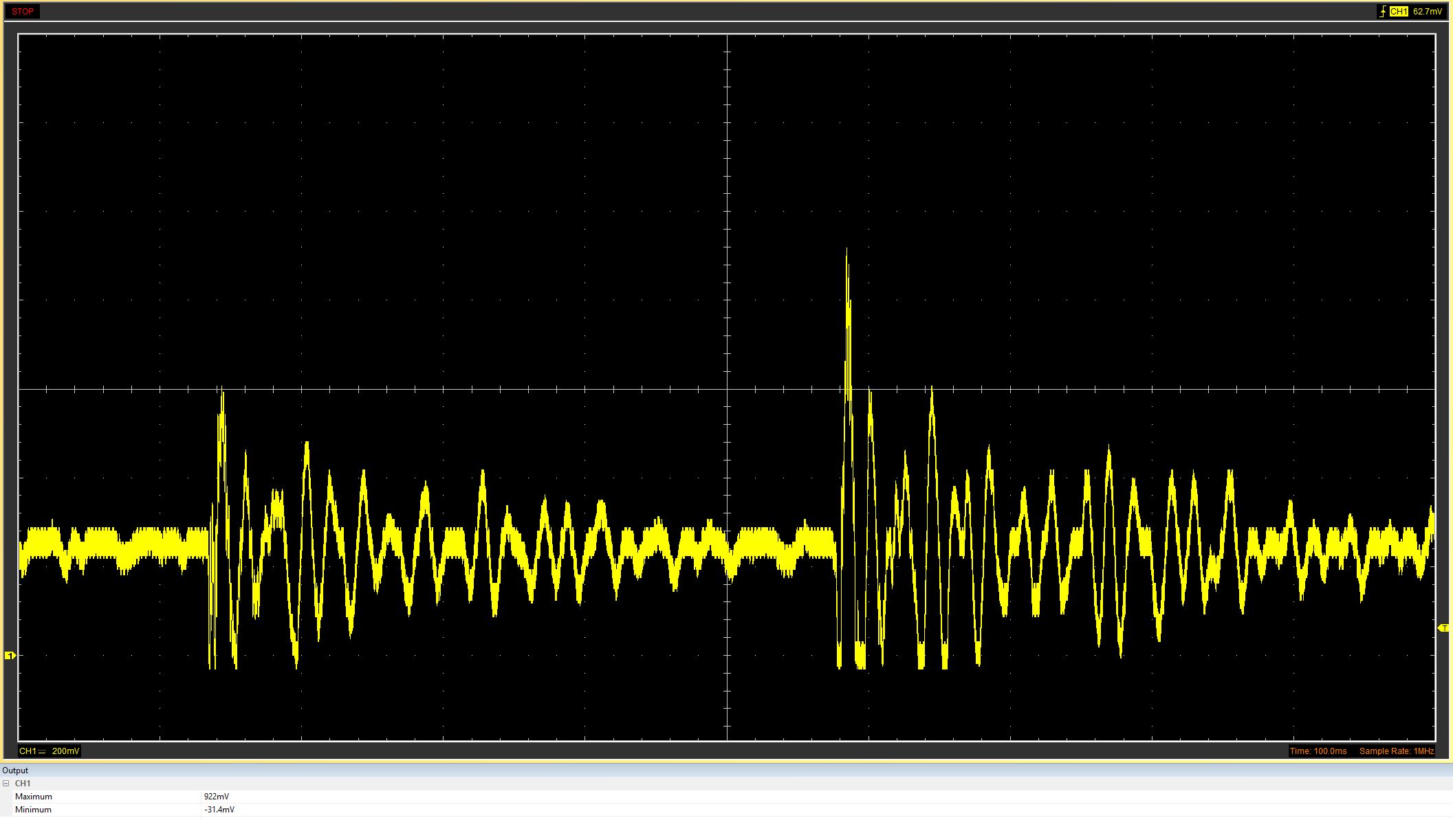

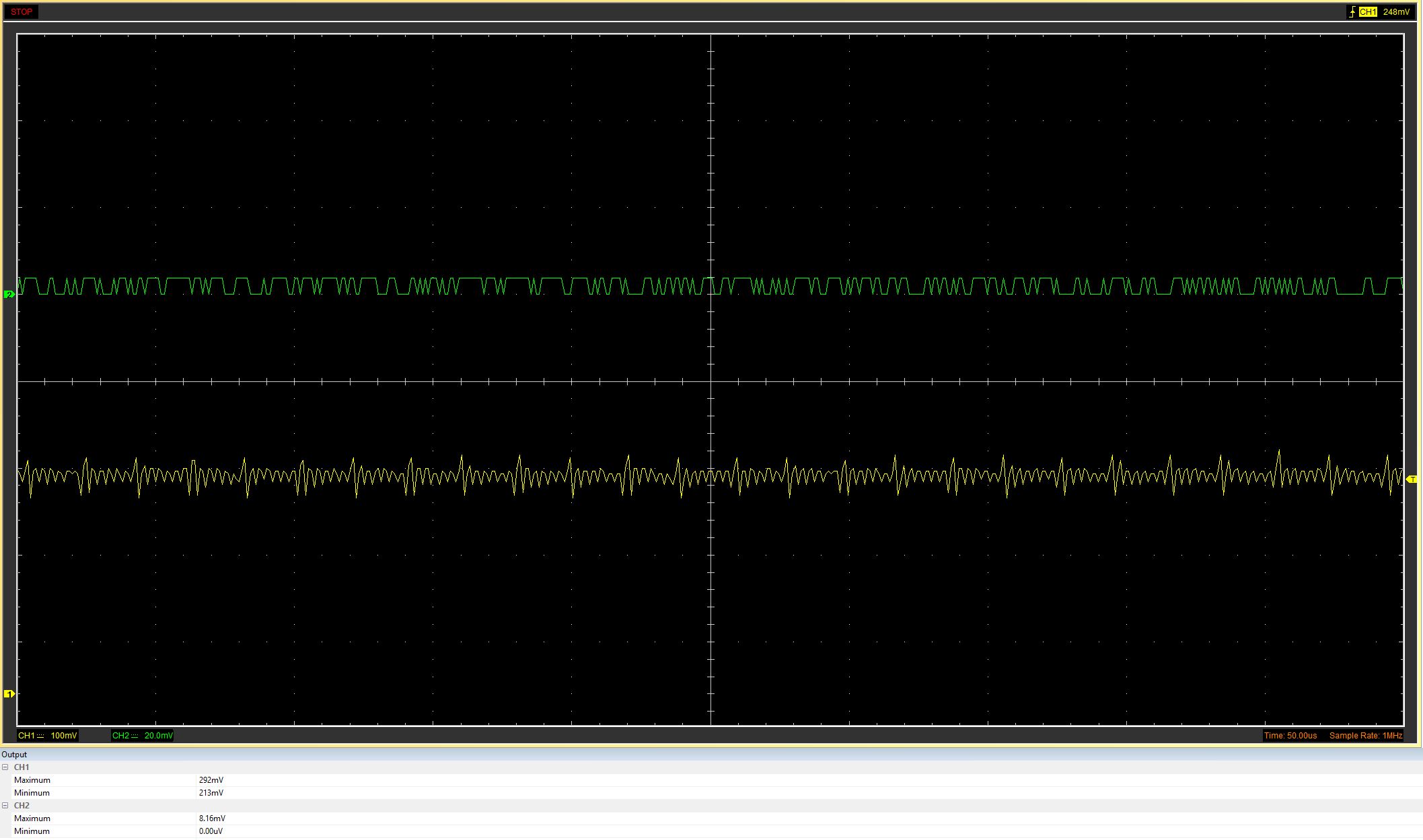

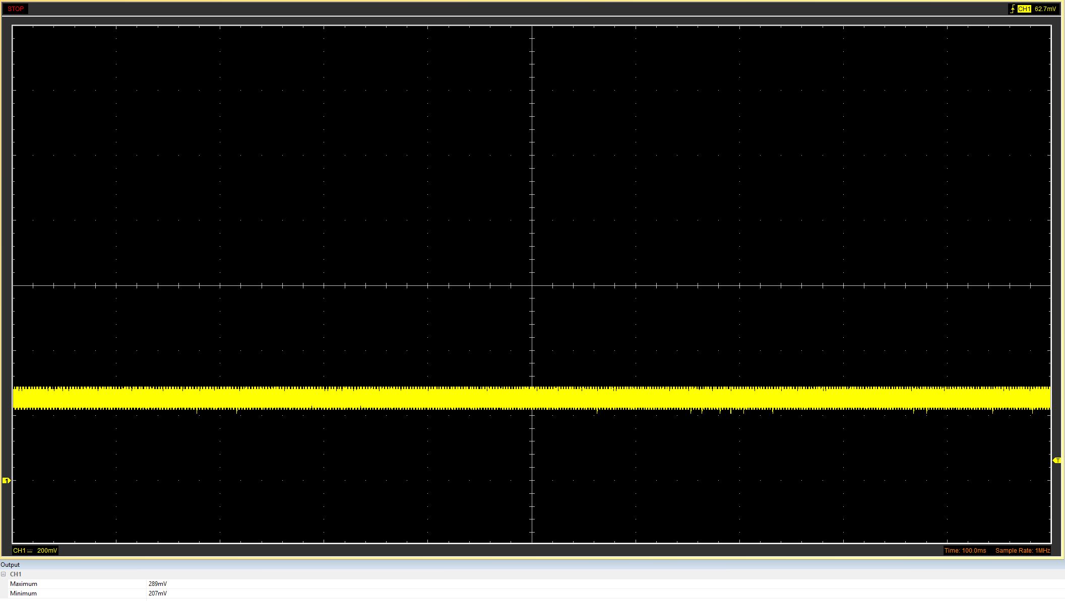

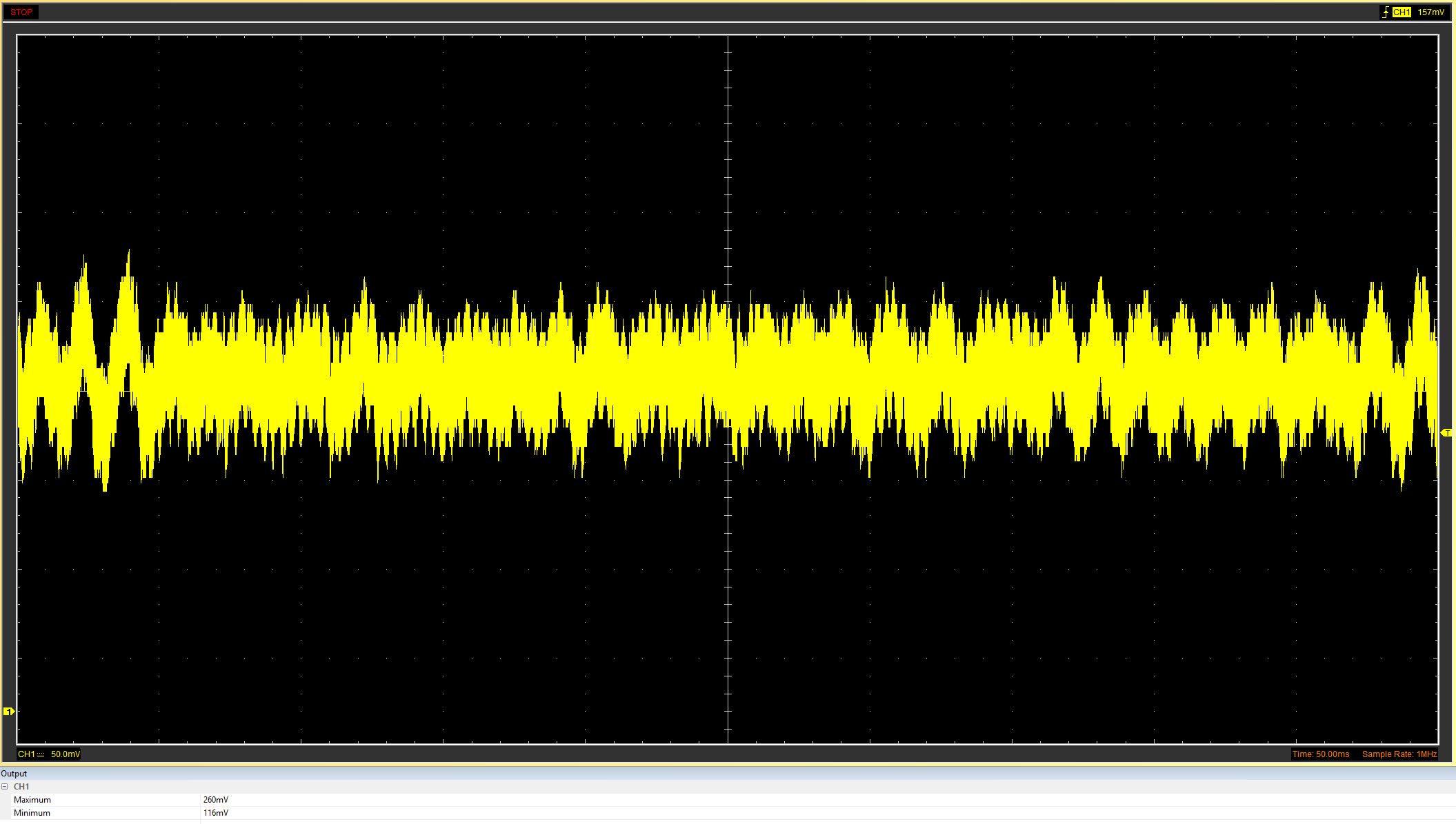

Below you can see a few curves of the behavior of the circuit (taken with a cheap Hantek 6022BE oscilloscope) :oops:
Sensor on the wall
Sensor on the window
Sensor on the window and my wife knocking slightly onto it
2 sensors compared.
Yellow line = Amplified sensor signal hanging in the air.
Green Line = direct signal (non amplified) from the sensor also hanging in the air.
lots of EMI on source from supply perhaps, lots of DC offset from mismatch R and high gain and lots of resonance around 50Hz and higher from window resonance.
-generally poor signals, but good enough for your purpose.
