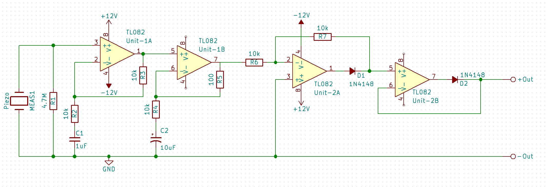

Did I understand correctly and use the Unit A of the Amplifier Op Amp as a Voltage Follower ?
Do I need a resistor between Output Pin and Inverting Pin when using as Voltage follower ?

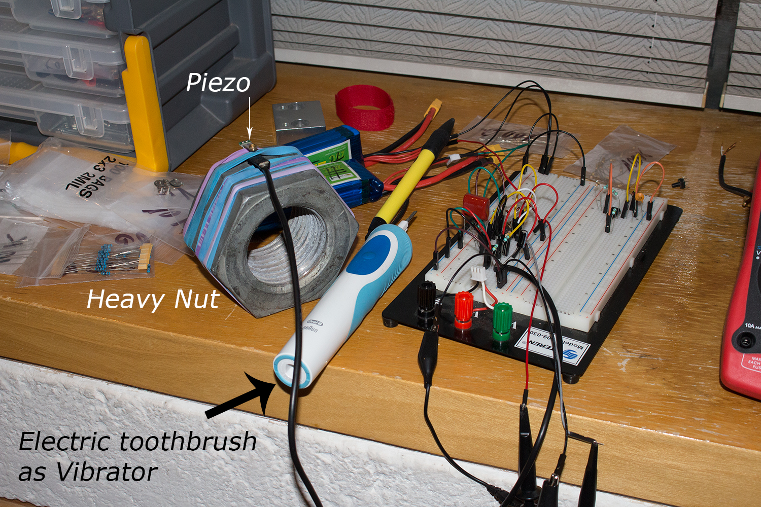

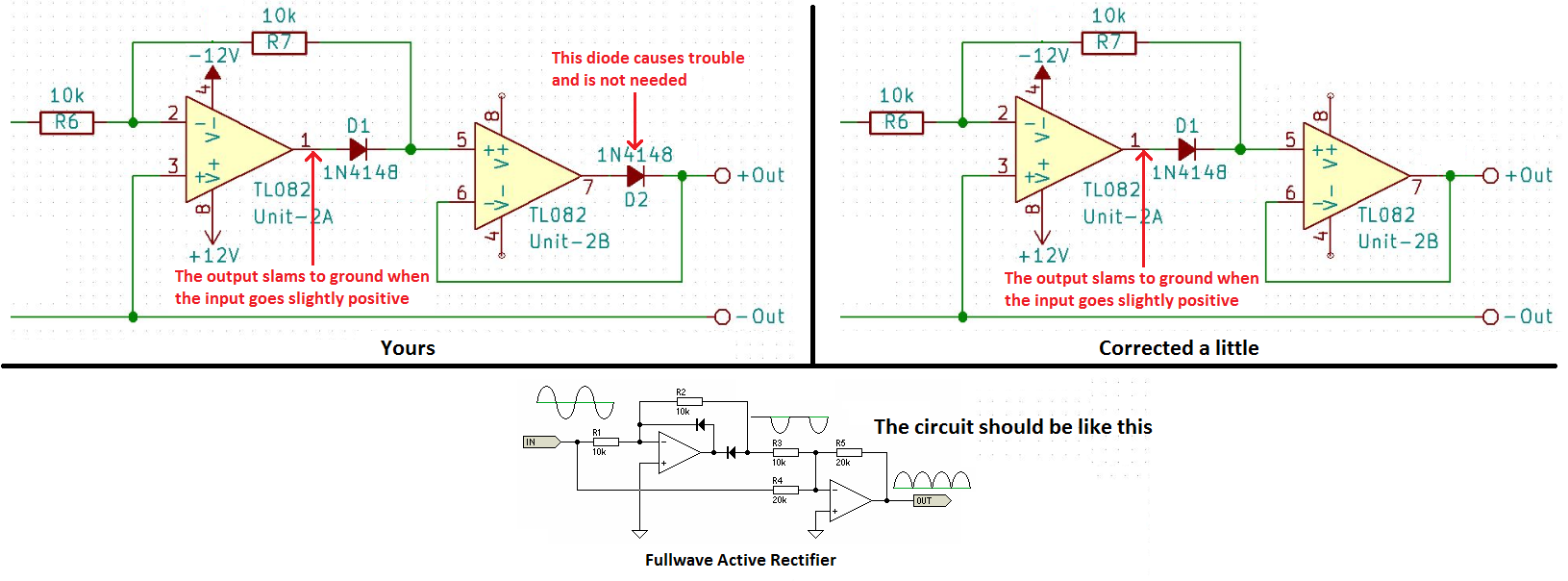

Here is the latest version which I am testing.
and below the test setup
A video of how the vibration is measured by the piezo.

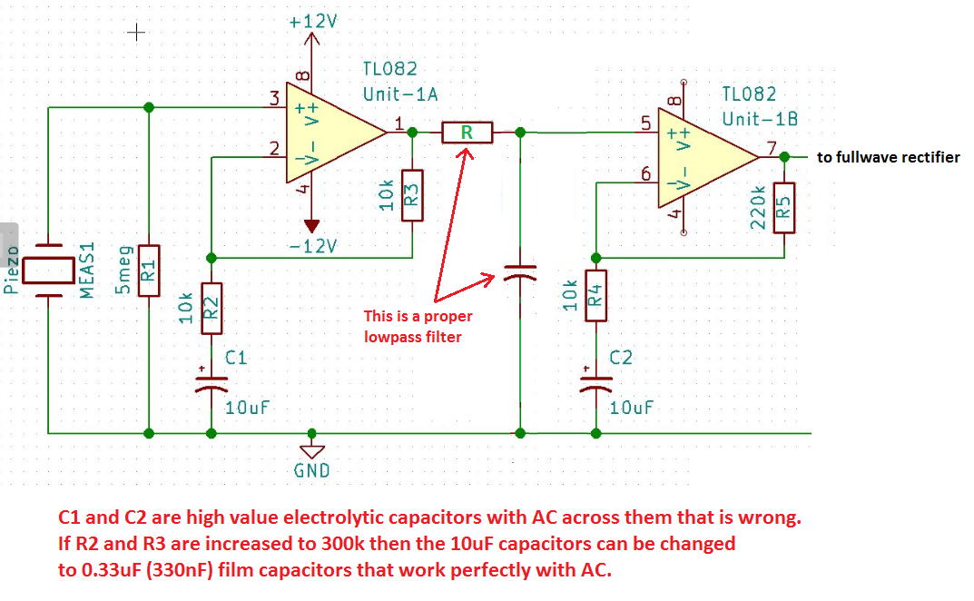

Your piezo sensor works only at low frequencies, it does not pickup high frequencies. Your C3 was shorting the output of the opamp causing it to oscillate.
If you want a lowpass filter then it should be like this:
10k and 1uF cut vibration frequencies below 16Hz that maybe you want. 1uF is a big expensive film capacitor and since it gets AC then it MUST be a non-polarized type (not a polarized electrolytic). Then increase the value of R2 and R3 so that the capacitors can be small inexpensive film ones.
I see that your active rectifier produces a fullwave output but it is still wrong. It should be like this:

Why did you kill the gain of the preamp by changing R5 to only 100 ohms?
R5 of 100 has to be a typo. Please short out C1.
To answer your question about voltage followers a bit. Generally you see the output returned to the - input and the plus input to ground.
That turns out "not EXACTLY right". The best scenario is the same value of what the inverting input sees. It's a real world thing. Using a non-zero value helps cancel the input bias current.
Sometimes you need a resistor from the output of an op amp to the input to say another follower. This won't work without some resistor value between them. It just can't be zero.
Shorting out C1 gives you a gain of 1 + Rf/Rin. Big deal at this point. You don't have to change the circuit to get a gain of 1. (A true voltage follower).
That cap in the first stage is TOO early in the signal chain to have a high pass filter. High pass ::= defined as > DC.
I agree that C1 should be a piece of wire since the first opamp has a gain of only 2 times then it amplifies the input offset voltage only 2 times.

I like your bench setup. Keep in mind that a breadboard, such as you're using, has inherent connection issues that might be aggravated (compromised) by the vibration of the toothbrush. I'd suggest putting the board on a foam mat.
Thanks for the Tip
Will put the board on foam.

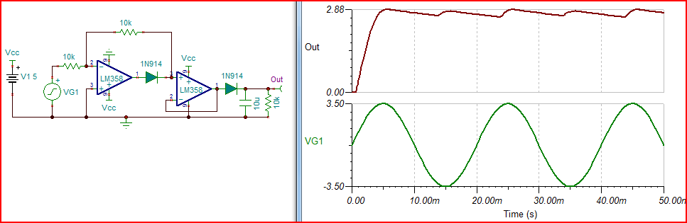

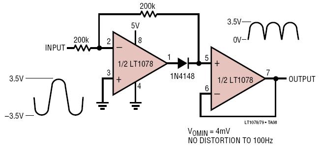

If I look at that I think I could even use a LM358 with single supply ...

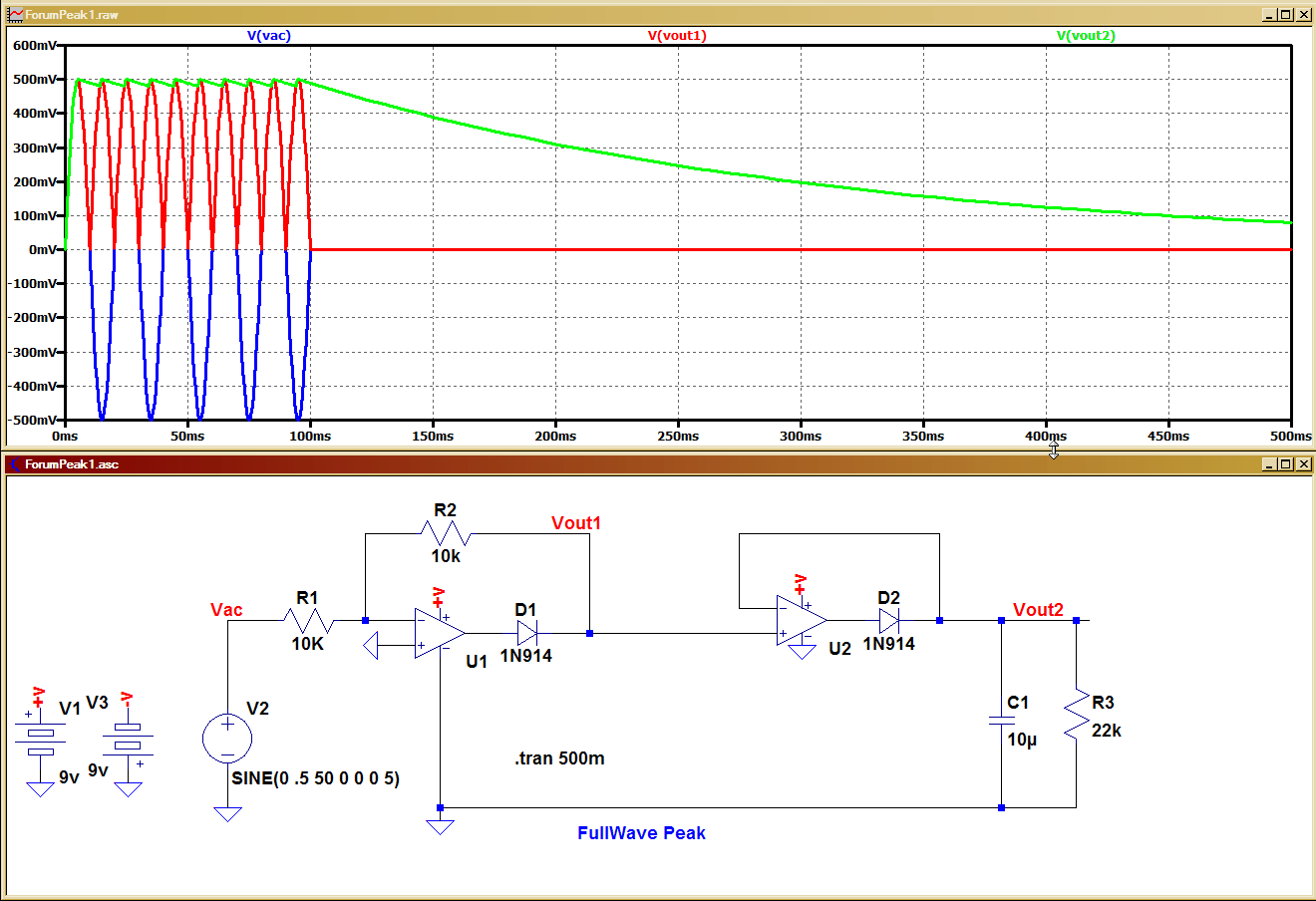

One of ericgibbs' designs - his stuff is pretty bulletproof:
Single supply LM358s. NO idea of current capability, but your stated use would be a voltage driven situation, for which this circuit will work just fine.
I made a minor change to the load resistor to allow the LM358's ability to respond a little easier.
<EDIT>Just replaced the graphic with one having the correct diodes :banghead:... Note cumulative losses across the diodes.

If I understood correctly the datasheet of the LM358, it can output 40mA
http://datasheets.datasheetpro.com/STMICROELECTRONICS/70013564.pdf
Thanks a lot for that. At the moment I am using Erics circuit with dual voltage supply as well as a TL082CP
Tha 10μF capacitor as well as the 10K resistor I assume is to get a DC voltage and not a alternating DC voltage. That is worth thinking about it because that in my case, it would mean that I get on the LM3914 a fading signal and not a flickering signal of the LED bar.
I do not need current capability as this circuit will drive a LM3914 and there I will apply the supply voltage which is powering the whole enchilada.
The 1N4148 diode is very very similar to the specified 1N914. Checked it already using the page **broken link removed**

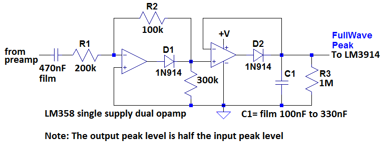

I like the fullwave rectifier using a single supply opamp. I tweaked it.
The input of an LM3914 is a high resistance so the 22k output resistor of Eric's circuit can be much higher, as high as 1M ohms. Then the filter capacitor value can be much smaller, try 0.1uF to 0.33uF.
Cowboy Bob's circuit has the second diode outside the negative feedback loop of the second opamp, use Eric's circuit that has the diode inside so that its voltage drop is cancelled.
I added a resistor so the input of the second opamp is not floating, then the output level is half the input level.
Of course it needs an input coupling capacitor if the preamp also uses a single supply.

... Cowboy Bob's circuit has the second diode outside the negative feedback loop of the second opamp, use Eric's circuit that has the diode inside so that its voltage drop is cancelled. ...
He's right. Corrected schematic:
My error, although in my defense, it was a wiring "typo" :rolleyes:.
I think the 10uF output capacitor will take too long a time to charge. If the 10k output resistor is changed to 1M then the capacitor value can be reduced so that it charges much quicker.
