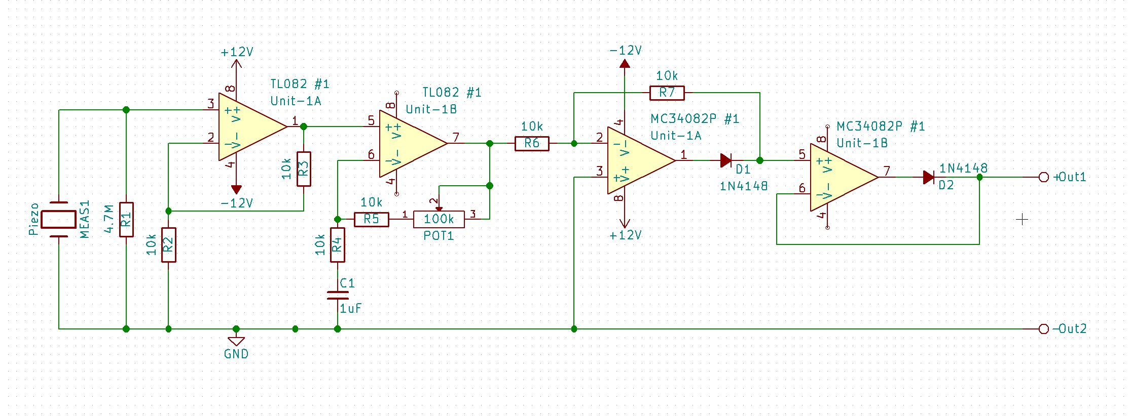

The "thread" started with a "poorly designed" single supply circuit.

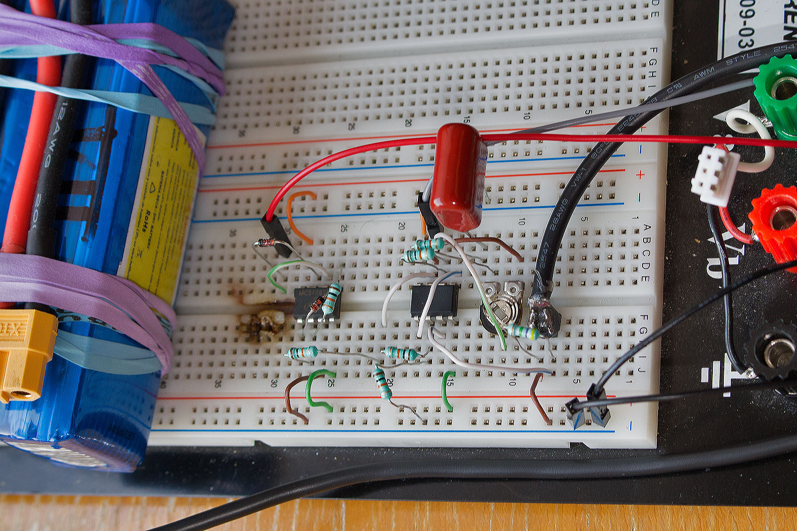

Next step yesterday was to take off the Antennas and wire it with one strand wires which I get from some old Ethernet cables laying around.

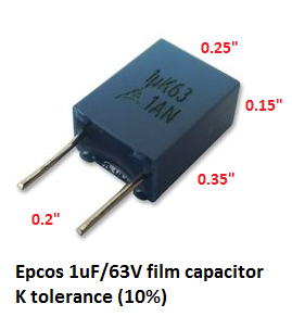

Finally I saw that the circuit is not really that big as I thought :wideyed: except that HUGE 1μF Film capacitor. It will have nearly the size of the full circuit :banghead:. Is there an alternative for that Monster component ? Will try with Ceramic capacitor and see what happens ... :confused:
If I go now onto a veroboard, what is better ? Directly sodler the OpAmps into it or use a Socket. I could use a DIP 2x8 socket and accommodate both Op Amp on that one.
OK I will think it over for a while about how to solder the whole enchilada and then make my first soldered version as small as possible.
and Surprise I just saw that the FW rectifier is not a TL082CP but it is a Dinosaur called MC34082P :D. After exchanging it to an TL082CP I did not see any difference in the outcome, but exchanging the Piezo amplifier from a TL082CP to a MC24082P there was a huge difference in that way that I have tremendous frequencies so I will leave there the TL082CP.
The Epcos 1uF/63V film capacitors I use are MUCH smaller that your Oriental high voltage ones. They are 0.25" long, 0.15" wide and 0.35" high with their leads 0.2" apart.
An old MC34082 dual opamp is high speed so it will probably oscillate when used on a solderless breadboard.
I soldered thousands of circuits on Veroboard with a very compact layouts. Each copper track was cut with a drill bit at an unused hole to as short a length as possible and only one wire was soldered in each hole.
A ceramic capacitor picks up, sounds and vibrations.

Thanks AG,
will search for those Film capacitors. Well that is what I found on a specialized store here in Mexico :banghead:
http://www.agspecinfo.com/pdfs/P/POLISTER.PDF this is what I get
With C1 as 1uf and R4 as only 10k then the circuit cuts most low vibration frequencies that you want, which is why I said that R4 and R5 should be 470k and the pot should be 4.7M then the circuit will pass low vibration frequencies.
Farnell (called Newark Element 14 in the Americas) has branches all over the world including here in Canada and in Mexico. They stock everything. If I order online or by phone before 8:00PM then it is delivered to me the next morning.
Hi AG,
I do not have those components but just tested with 200KΩ on R4 and on R5 I put a 1MΩ resistor plus 1M trimpot and no change at all.
Will keep trying on R4 a ~400KΩ resistor and on R5 a 3.9MΩ plus a 1MΩ trimpot and see what happens then.
Simply calculate the low frequency cutoff yourself: 1 divided by (2 x pi x R x C) where R is Ohms and C is Farads. This is the frequency that is cut -3dB (0.707 times and lower frequencies are half the level for each octave lower.)
1uF with 400k is a cutoff frequency of 0.4Hz which is 2.5 vibration movements each second. The gain at higher frequencies is 1 + (2M/400K)= 6 times.

Farad value in this case for example when I use a capacitor with 1μF that would be 0.001 in the calculation ¿ Correct ?
400k ohms is 0.4M ohms. When multiplying a 1uF capacitor with a 0.4M resistor then the u cancels the M and the answer is simply 0.4, it is that easy.
I make it even easier. How much is 1/(2pi)? It is 0.159155.... which is very close to 0.16 so I calculate 1 divided by (2 x pi x 0.4M x 1u) as 0.16/(0.4M x 1u) which is 0.16/0.4= 0.4Hz a vibration frequency.
