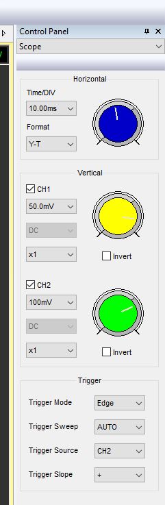

Your 'scope's "Vert" (vertical) input(s) should have a switch with the options AC, Gnd and DC. Select the DC position plus a slow Horizontal (time base) of, say, 250 to 500mS and you should see a trace following the variable* DC signal coming from your signal conditioning circuit. Play with the settings (Horizontal and Vertical) to get a trace that makes sense.
By way of explanation, when in the AC position, there is a decoupling capacitor in the circuit to eliminate the DC component of the test signal. The gnd position grounds out the input to the 'scope's vertical circuitry (but NOT the signal you are feeding it). The DC position lacks the decoupling cap, so all DC signal biases are passed to the vertical curcuitry (as well as AC elements - makes for a messy trace).

My Oscilloscope cost me US $ 99.00 so nothing sophisticated and no, it has no adjustment possibility for AC and Ground.

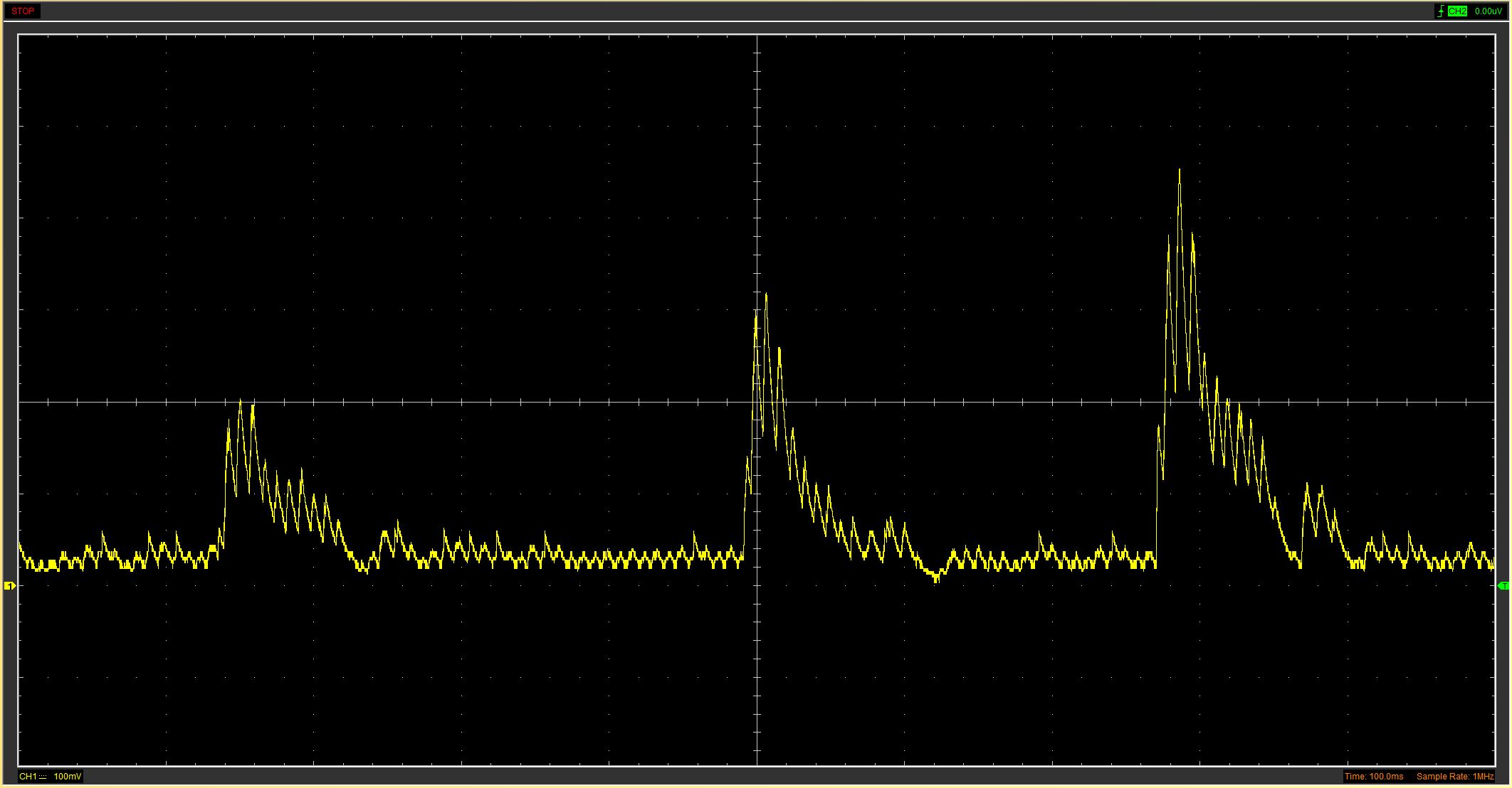

Current circuit ... with a gain of 12

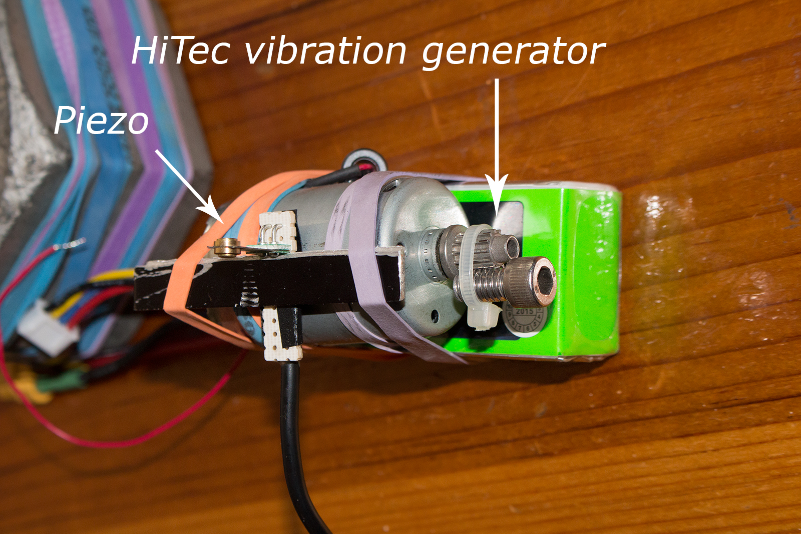

Here a video measuring on PIN 3 ( GREEN curve ) on Unit-1A and Yellow curve is on Output Unit-2B **broken link removed** (drumming fingers) You can see the voltage values for CH1 and CH2 on the lower part of the video
The next video is when a small screwdriver falls from about a height of 10cm on my table at a distance of 1 meter **broken link removed**
What do you think ?
Another one
Video as a message before but this time using a HiTec Vibration Generator
Video here **broken link removed**
That is exactly what I want to do. Measure the vibration of the pier on which the telescope mount is mounted in order to know when it is vibrating too much. More or less a simple seismograph

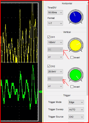

As for the AC/Gnd/DC issue, it appears that you do, indeed, have those options on both vertical channels:
just not real switches. At my age I keep forgetting the virtual world stuff out there.
No possibility to switch anything. Have gone through all menus at the top and nothing. Maybe I overlooked something and will do through it again :banghead:

Your "HiTec Vibration Generator" is a gem of what we Hams call "Home Brew" gear... :cool:.
Thanks. That is a motor from a printer I ripped apart a few years ago and as I have some LiPo here I can take out 3.7V, 7.4V and 11.1V ;)

Yes. It might not be necessary to make any circuit alterations.
I just added a 0.010μF cap and a 100K resistor and that is the result.
Just play with the scope settings to get the most useful and demonstrative examples of the vibrations being monitored.

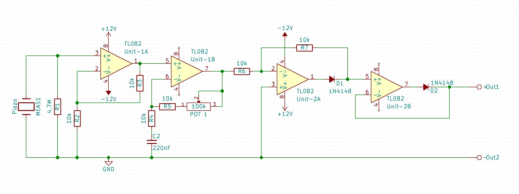

1) The datasheet for your vibration sensor says, "Operation up to 40Hz" because it has a strong resonance at 75Hz. Your circuit has no lowpass filter at 40Hz.
2) You have C2 as a low value 220nF capacitor and R5 as a low value 10k resistor which cut frequencies below 73Hz but vibrations are much lower. If you use 220nF then the R4 should be 470k then for the same gain as now R5 should also be 470k and the pot should be 4.7M. Maybe you should use a 1uF film capacitor and these higher resistor values for even lower frequencies.
3) Your unshielded wiring or many wires on a solderless breadboard are picking up a lot of 60Hz mains electricity hum.
4) The first opamp has a gain of only 2 so it is it needed. Increase the gain of the second opamp instead with R1 at its input.
5) The outputs of opamps 2A and 2B alternate slamming as low as they can go because you do not have a correct fullwave rectifier circuit.
Hi ag,
Starting next monday I will be in vacation for 2 weeks ans then take the time to set up everything soldered on a board an test it in the Observatory. I already have a copper mesh with which I will build a Faraday cage and so I will see what comes out.
