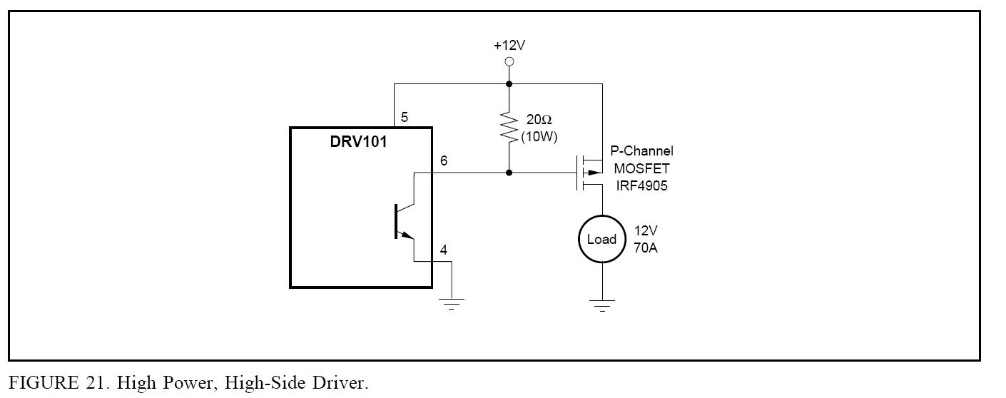

OK, need some help from Electrical Engineer pretty please. The power mosfet is $35us STE250NS10 (**broken link removed**). As I stated in my earlier post, the electrode I am using now draws 50 amps @ room temp. Later I plan to expand the surface area by using circular plates instead of rectangular ones and I anticipate a current draw of 125A, which is why I am choosing a transistor which can handle twice the current. for the driver I would like to use a DRV101. Here's a schematic from one of the App note's: Instead of the IRF4905, I'd like to use the STE250NS10. What adjustments do I have to make to the schematic to make it work? TIA
