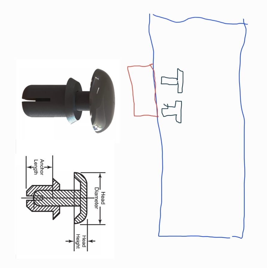

I came across an interesting technique for mounting a small enclosure to a panel while working on an exercise bike.
If you've got an enclosure (some great microcontroller project for example) that you want to mount to a panel, you may have a quandary. You can't run screws through the back of the enclosure because you can't access them when the enclosure is shut. Maybe you could get an enclosure with mounting flanges, but that's not always the best look. Double back tape to the rescue. Until you need to take the enclosure off to work on it.
The control box on my exercise bike it mounted to a sheet metal structure. I wasn't sure how it was mounted, as there were no screws from the back. I could see a couple plastic bumps (4 as it turns out) that I took for locating pins with I guessed double-sided tape.
A little gentle prying and the enclosure popped free, revealing the mounting secret. Many companies make variations on this idea, but Essentia Components calls them "push rivets" or "snap rivets". These are inserted through holes in the mounting panel and back of the enclosure, and the button pressed to lock the enclosure in place. They provide a firm grip, but are flexible enough that they give way with no damage when some over-zealous idiot tries to pry the enclosure off.
I've seen these rivets before but never for an application like this. I hope my description makes sense, and that some of you will find it useful.

They also make the 'screw' type where instead of a push pin you have a screw, and to secure it you screw in the screw instead of pushing in the pin.
My preference is to use what they call, "rivet nuts". These are amazing little fasteners that once installed in a panel provide you with a strong, threaded hole so you can mount something to that panel using regular bolts like M3, M4, M5, etc. I used these to reattach a gas door to an automobile where the plastic push pins had failed.
You need a special tool to install them. You thread the rivet nut onto the tool, insert the nut into a hole you drill or is already present, then spread the handles of the tool. The rivet nut anchors itself to the panel. You then have a threaded hole there.
There is one drawback to many of these solutions. That is, they do not fit perfectly flush to the front surface of the panel they are installed in. They stick out a very small mount. It's not much, but for some application it may not work as well as a real threaded hole. For that you would need regular nuts on the back of the panel, but if you don't have access to the back you have to do something else like use these rivet nuts or something.
