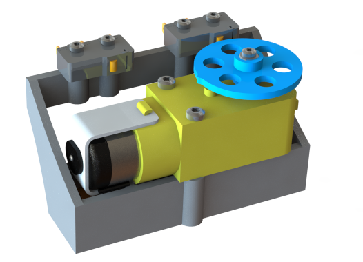

What would be the most basic circuit for controlling 1 revolution of a disk at the push of a button? As per below schematic, the disk turns CW until the marker meets a sensor. Then, with a single push/release of the button, the disk makes the next revolution. Etc.
Disk speed 60 rpm. Position accuracy is not required. Circuit power ±10W. Mechanical, optical, magnetic, etc. solutions are allowed.
Thank you

Thank you. The disk is the final stage of a 1:120 gear ratio so disk inertia is not expected to be an issue. As soon as the current is cut, the disk will stop. 60 rpm is peak. No requirement for acceleration. It is a trigger mechanism to be used in a bigger school project.

Sensor type was open for selection as asked. I understand your set up as per sketch below? With one NO and one NC switch. I think it is brilliant, exactly what we need! I can do this with some micro switches. Thank you!

Yes, the sketch is the restart position. Does this set-up have a name? As it seems quite common and would work with many type of sensors. Yes, i will add a video when it's running.

That sounds like a lot of work for something so simple. No matter how far the disk coasts after the index switch is tripped, that distance will be a constant for all cycles. Given the 120:1 reduction from the motor to the disk, I'll be surprised if it is more than a few degrees. The only important thing is that the index switch remains pressed continually while the motor and disk come to a complete stop. The width of the index bump on the disk covers this.

Just be careful with the shape of the leading edge of your dimple - too steep and you may have unnecessary wear on the dimple on the disk or the nub on the micro switch. I would have kept part of the actuator arm from the micro switch since the steel is nice and smooth for the nub on the disk and it presses flat onto the microswitch. High sheer plastic-plastic glide surfaces can cause melting and "stiction".
