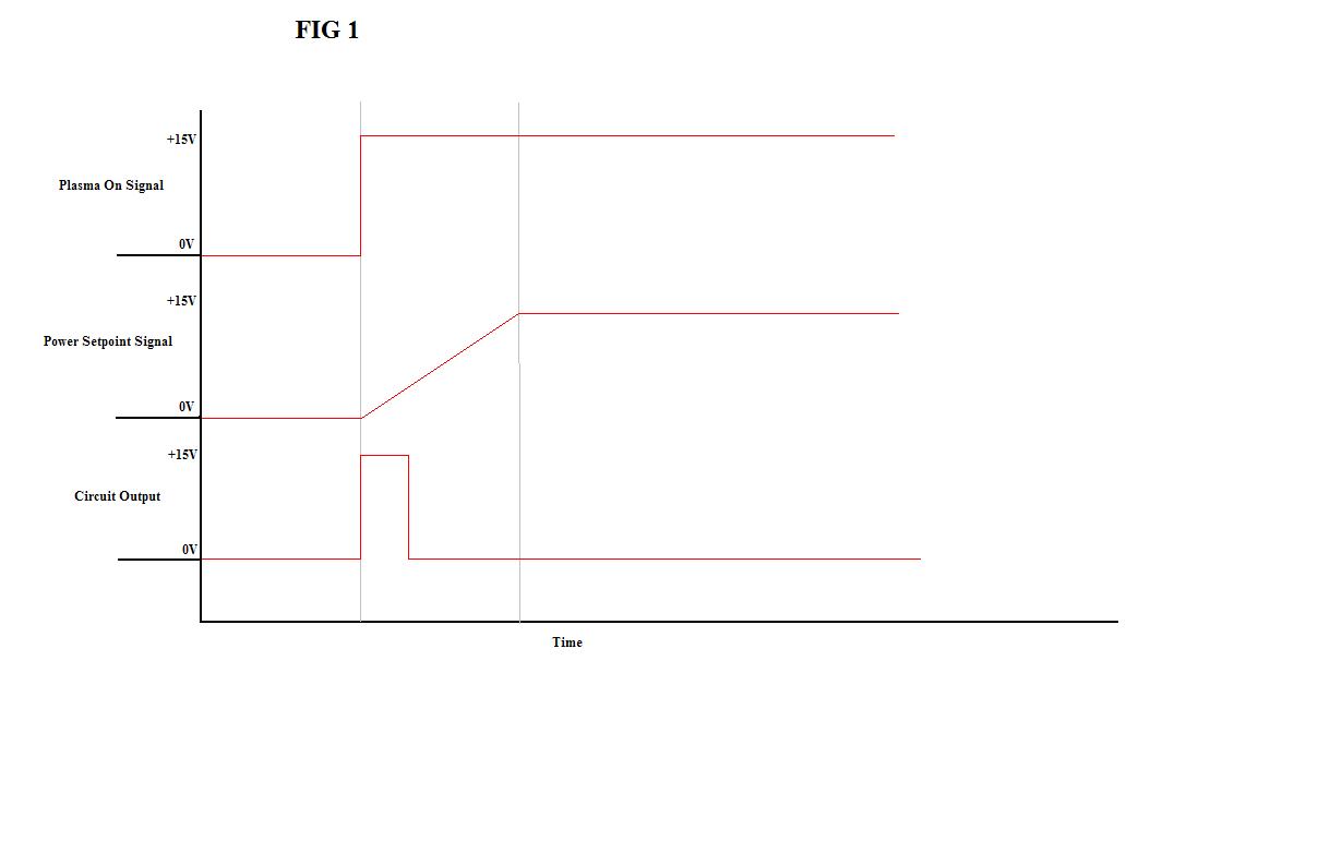

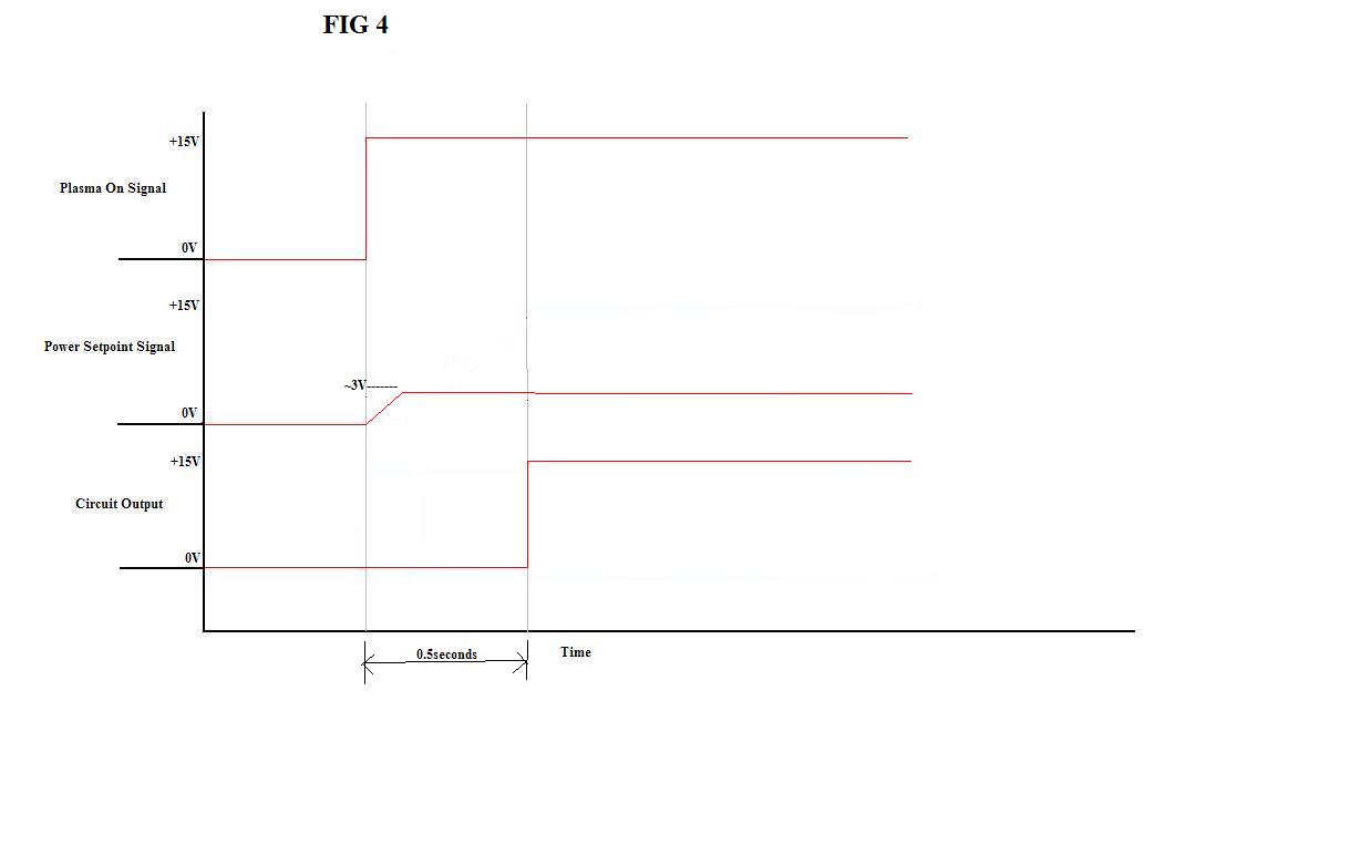

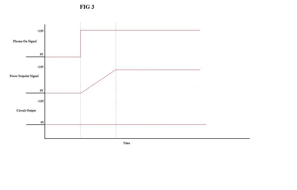

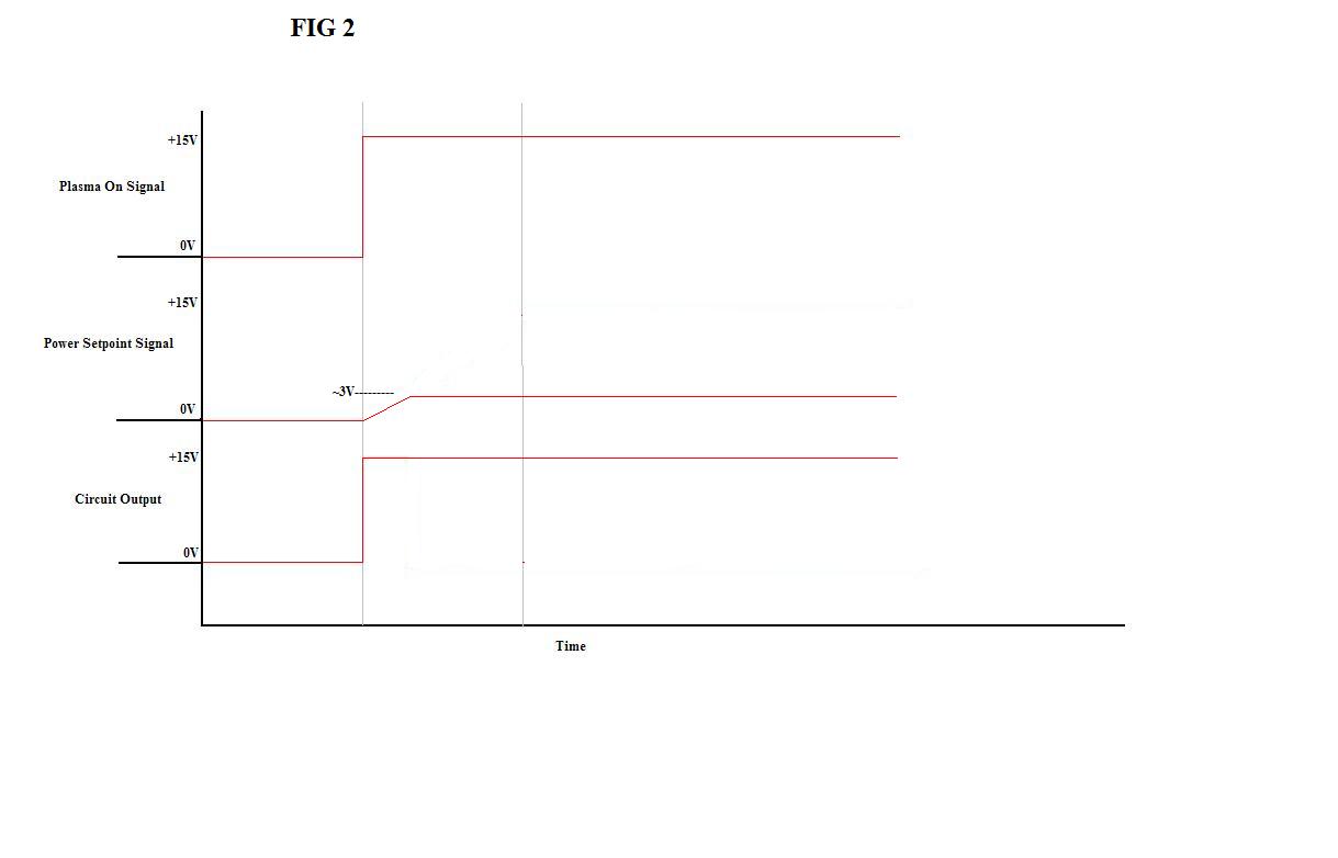

Ok I made some timing diagrams, I had to use MS Paint because I dont have anything else to use here at work.
Fig1 - This is what is happening with my current OPAMP circuit, the output pulse is probably 1/4 of a second
Fig2 - This is the OPAMP circuit when it works (the power setpoint is below 3V)
Fig3 - This is what I would like the circuit to do when the power setpoint is higher than 3V
Fig4 - This is what I would like the circuit to do when the power setpoint is below 3V
Actually to make this easier to understand and since I have the rest of the circuit working great.... all I need to do, is figure out a circuit that when the "plasma on" signal goes high, a pulse for 0.5 seconds is created and after the pulse times out, the circuit will ignore any high "plasma on" signal until the "plasma on" signal goes low again.
Hopefully this might make it easier to understand.

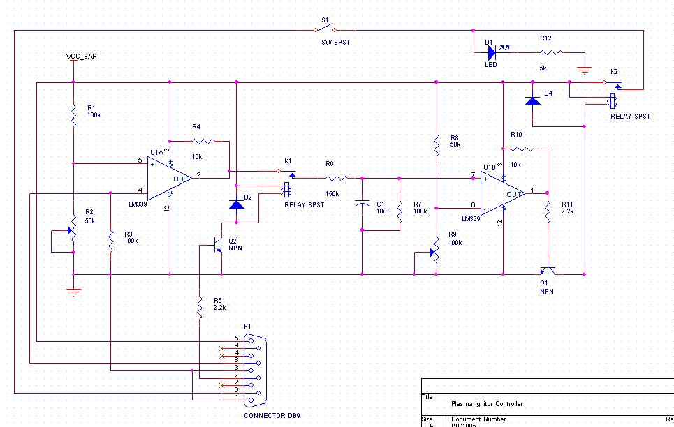

Attached is my old circuit, using OPAMPS and relays... I would not like to use relays in my newer versions of my circuit.
This is the pinout of the DB-9:

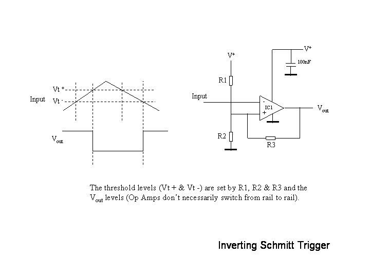

Here is an inverting Schmitt Trigger (the "threshold detector" in my previous post).
I believe you need an inverting one since you want the output to be High if the Power Set Point voltage is < about 3 V.
I would therefore design the Schmitt for Vt+ of about 3 Volt and Vt- for say 2.7 Volt. This will give you 0.3 V of hystersis which should be adequate.
Edit, forgot to attach
I like the idea of the Schmitt Trigger, I didn't think to use one in my application but I will use it in my new design.

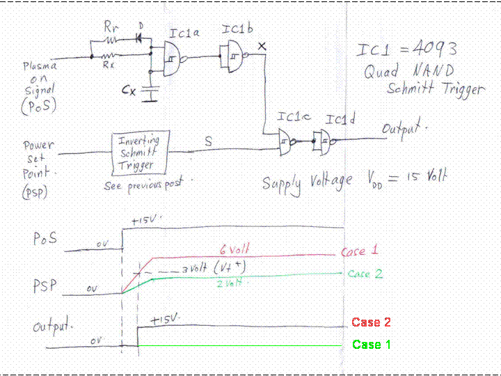

Here is a suggestion. (Please excuse the scribble)
You don't need a Mono or a FF provided that the signals remain constant as you showed in your waveform diagrams 3 & 4.
Circuit description.
When PoS goes High, Cx charges via Rx. When the Cx voltage reaches the +ve threshold of IC1a, X goes High.
In case 1, I have assumed that the PSP voltage rises to +6 Volt.
Thus the output of the Inverting Schmitt Trigger remains Low.
Hence the output remains Low.
In case 2, I have assumed that the PSP voltage rises to +2 Volt.
Thus the output of the Inverting Schmitt Trigger goes High.
Hence the output goes High.
When PoS goes Low, Cx discharges rapidly via D & Rr thus the circuit is reset ready for the next sequence.
Ok... So this is my delay correct?
I actually have a similar sketch I made, using a standard voltage comparator and NAND gates. All I had to add to the circuit were RC timing componants, but I didnt know my threshold voltage for the NAND gate.
Also couldnt I use a standard voltage comparator instead of a Schmitt Trigger? The signals the circuit will be getting are straight from a PLC.
I'm stuck at work for another hour! I can't wait till I get home to start to really crank out a couple ideas on OrCad!
Answers
1. Yes. The delay is the time to charge Cx to the +ve threshold level of the IC1a Schmitt NAND.
2. A standard voltage comparitor (or an Op Amp configured as a comparitor) does not have hystersis. Whereas, a Schmitt Trigger is a voltage comparitor with positive feedback so that, once the voltage reaches the threshold, it changes rapidly.

Schematic Attached

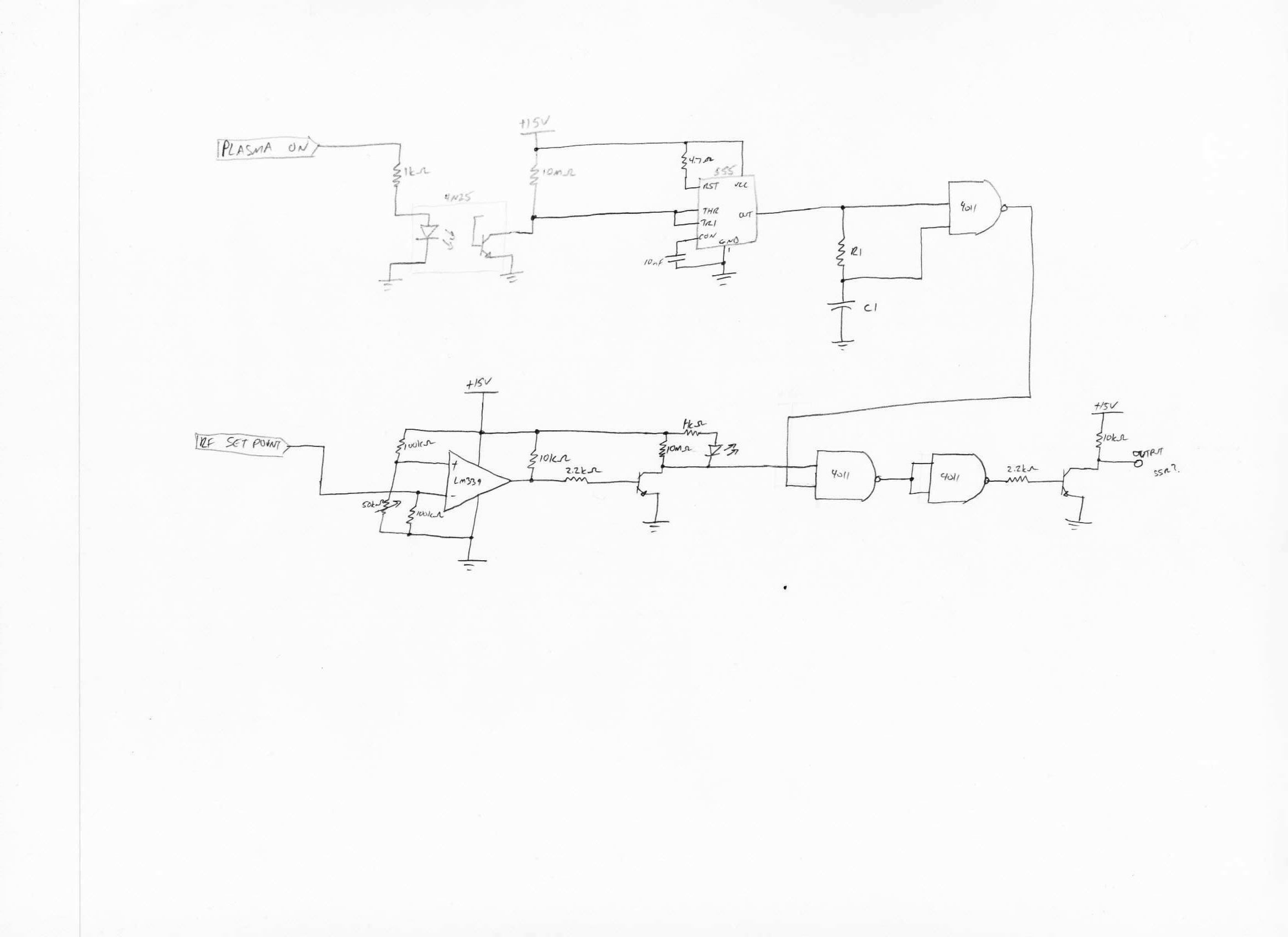

Here's the idea I had using an RC circuit connected directly to the NAND gate.
About hystersis, I was always under the impression that hystersis was a bad thing. I thought a standard voltage comparator had hystersis (when both inputs are close to each other and it toggles the output rapidly). By adding a type of feedback to one of the inputs it would take care of that, it will reduce your "hystersis leve
I did some research and found out that I was thinking completely opposite. :eek:
When detecting threshold levels, hystersis good not bad. Without hystersis, the trigger level is not precisly defined and the transitions are slow.
Hystersis is particularily important for an RC timer because an Op Amp or Voltage Comparitor is a high gain amplifier so without hystersis, the output will change slowly as the input voltage passes through the linear range.
So in the circuit you posted, you should replace the 4011 with a 4093.
Also, you don't need the opto coupler and 555.
