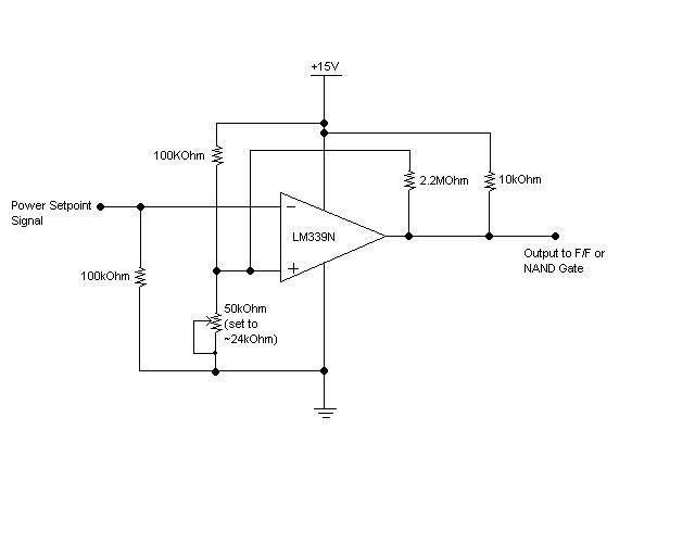

Here's my inverting Schmitt Trigger. I found the formulas I needed and according to them the trigger voltage is 3.01V and it should hold till 2.75V. Of course the circuit will be fine tuned with a 15-turn pot after it is installed in the PECVD tool.

You don't have a load resistor for the comparator to power its output.
You have the inputs of the comparator backwards.
Wow jeezz how'd I miss that? Must of been the 3 chilli-dogs and beer I had for dinner, haha

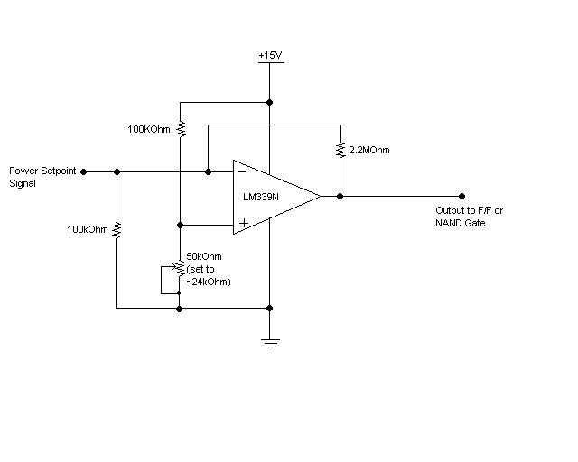

Here's the updated file....

2 comments.
The rise time of the output of the S/T (with a 10k pull up resistor) may be too slow for the FF. It won't be a problem if you use a Schmitt NAND.
I still don't know if you need the 100k. What generates the PSP signal?

How so? The LM339 is a proper voltage comparator, with open collector output.
If the S/T is driving the Ck input of a FF, then there will be some capacitance to gnd - ie. the input C of the FF and any stray C.
So say it is 20 pF. 10k & 20 pF gives a time constant of 200 ns.
So, the FF may not change state to Ck transitions - depending upon what the maximum allowable rise time of the FF is.
OK. I see.
He can try to use 2K for the LM339 output collector load to ease the problem a bit.
The LM339 quad and LM393 dual comparators are very old. They are also low power which means slow.
stizzswizz said:
I have some LM311N's, would you recomend another comparator?
The LM311N would be suitable, but you still need a pull up resistor. Whereas, an Op Amp does not need one.
