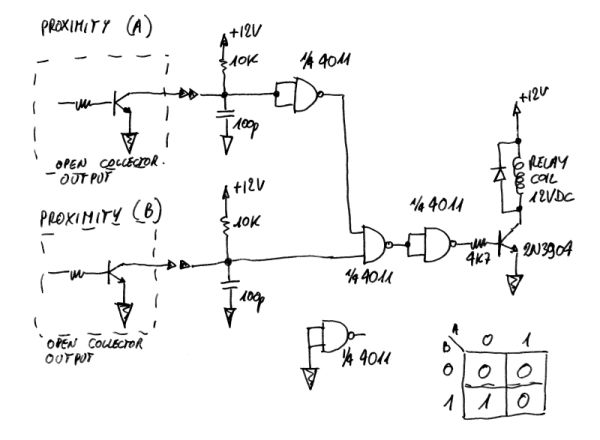

You can try something like this:
img_0003-jpg.33867
I used a CMOS 4011 NAND gate powered at 12Vdc but any NAND gate should work (using the right power supply, of course).

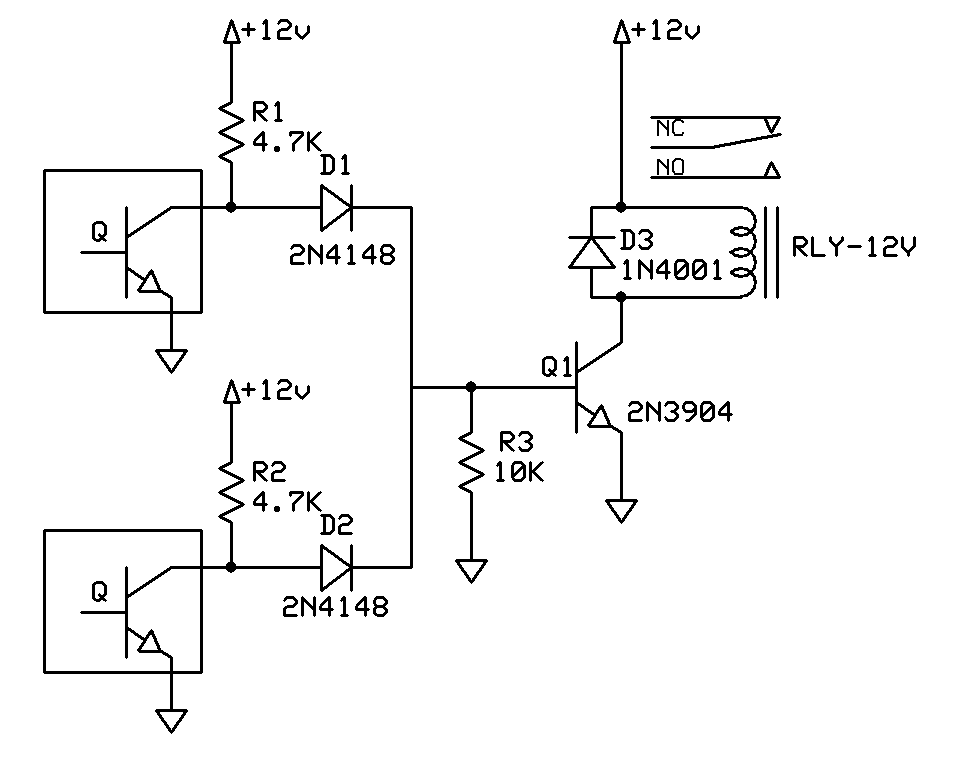

Or a little bit old school...a DTL NOR...assuming that the sensor outputs are low when metal is present.

Arkham00
This looks cool, Thanks very much.
I know that this is something simple for you but I am trying to understand how all this works. Could you give a brief explanation of what each component does in the circuit. I have a couple of questions about your solution.
1. It looks like the 2 resistors are 10K but what is the value of the resistor between the last gate and the transistor.
2. What is the value of the diode across the relay coil.
3. Are the capacitors 100p
4. I know the inputs of the un-used gate get connected to 0V dc but does the output get connected anywhere?
5. Where does the other led from the proximity sensor get connected? I am thinking to the +12V dc

Arkham00
Reply to your questions:
(1) 4700 ohm
(2) 1N4148 or 1N4002
(3) yes
(4) the output of the unused gate is floating (unconnected)
(5) yes, the power supply wire of the proxy is connected to +12Vdc
But pay attention to the other messages about the low speed of you proxy sensors. This is an important issue.

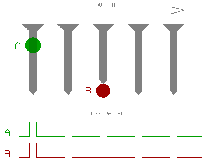

I have attached a drawing of what I am trying to accomplish. I may be on the wrong track completely. If anyone has a better Idea please tell me.
I am not concerned with complete accuracy in checking length. I just want to stop the process if the nails are about 1/8 inch short.
My concern in using a larger Proximity sensor is the distance between the nails. I think that with the larger sensor 2 or 3 nails would be detected at a time. So a short nail would not be detected. I could be wrong, I have been before.

Hi Tim,
using two TDA0161 connected to an MCU and comparing the resultant frequencies caused by the nail passage the sensors are independent of object (production) speed.
Sensor A senses every nail, even a missing one, while sensor B will sense the present and missing ones.
A completely missing nail will result in identical pulse patterns of sensor A and B and no action has to be taken. (misload)
Connect the MCU output to the switching circuit which stops production.
The function is illustrated in the sketch below.
Boncuk

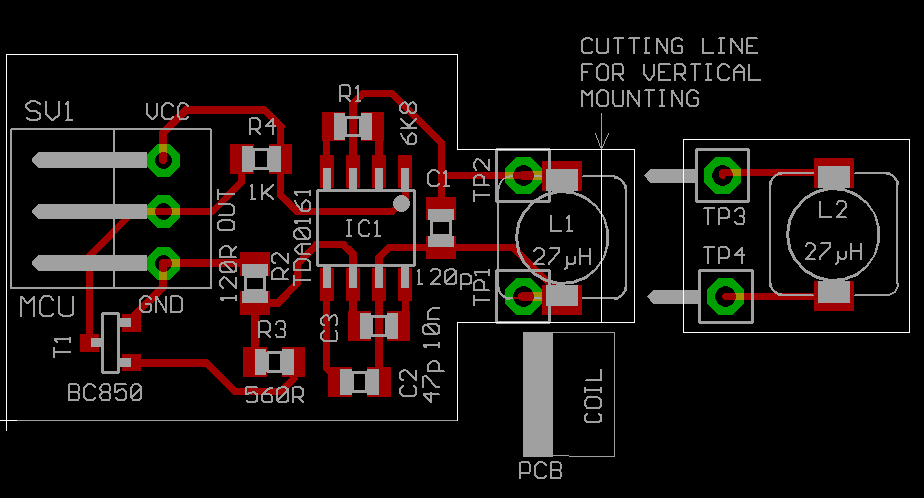

Hi Tim,
that design won't require a microcomputer. It more or less requires one XOR-gate to determine a short nail. It even ignores missing nails completely.
(mis load).

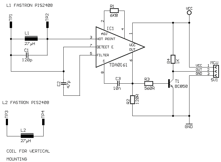

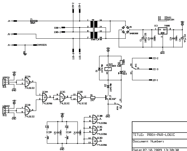

In the meanwhile I designed two cirucuits, one containing the sensor circuit around the TDA0161 with the option of horizontal and vertical mounting of the sensor coil.
The second board contains the power supply (selectable 115 or 230V) and the logic circuitry. The input uses a NAND Schmitt-Trigger for signal conditioning, being followed by the XOR-gate. The truth-table for XOR:
A-0, B-0, Q-0
A-1, B-0, Q-1
A-0, B-1, Q-1
A-1, B-1, Q-0
applied for the nails that means sensor A (top of nail) generates a logic 1. If the nail is long enough sensor B (bottom of nail) also generates a logic 1, leading to an output of logic 0. (Nail length within determined tolerance). If the passing nail is too short sensor B will generate a logic 0, causing the output to shift to logic 1. The following NAND gates are not necessary, but they must be connected anyway and are used as double inverter. The output controls T1 which energizes the self latching relay and putting out all three terminals (potential free) for further action.
If a nail is completely missing both sensors generate the same output (logic 0), meaning the (absent) nail is being ignored.
If the machine has been shut down due to a procuction failure the circuit must be completely disconnected from mains to reset it.

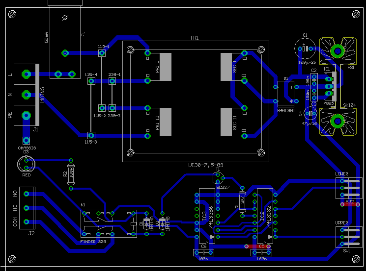

The sensor board is completely made with SMD components (except for three pin connector) for maxium freedom at the machine.
The PCB outline shows the cutting line if the sensor coil is mounted vertically, assuming a board thickness of 1.5mm and a coil height of 3mm.
The power and control board is single sided and contains two wire jumps + the jumps for mains power selection.
The circuit is designed for a gap of 2mm between nail and coil.
If you want to build the circuit as shown please PM me for the Eagle files.
