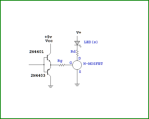

Is a totem pole driver suitable to drive mosfets in push pull configuration which will inturn drive a centre tap transformer as i do not want to drive the mosfets directly from the logic IC it self.
Are there any other better drive circuits for push pull config apart from using a real mosfet driver IC's.
I do not see a schematic of your circuit in this thread so I do not know what needs to drive the Mosfets. The comparators? Do the comparators have a +12V supply?
How much gate voltage do your Mosfets need to fully turn on?
"a real mosfet driver IC" would provide dead-time control to prevent shoot-through, i.e high-side and low-side FETs on simultaneously for an instant. Depending on switching speed and FET spec a simple totem-pole might not allow gate charge to change rapidly enough to prevent some shoot-through.

Here is a quick driver schematic. This is only to drive the logic level MOSFET. Any required delays would have to be built into the code.
so this circuit wont drive a power mosfet like the IRFP260N since logic level mosfets require only abut 5V to fully turn on
Well it depends on the circuit that actually drives this two transistor circuit. If it is driven directly from a microcontroller pin that only can reach up to +5v then yes, but if you have a drive that is as high as +12v then it can do it. Or alternately if you add a common emitter inverter using another transistor and collector resistor then you can drive this circuit with that, and drive the single transistor with the microcontroller pin, as long as you have a power supply source voltage that goes up to the required level to drive the MOSFET in question (such as +12v available).

The CD4047 has output current that is too low to drive the high capacitance gate of a Mosfet quickly. Its outputs have no "dead time" so both the upper and lower Mosfets are turned on for a moment shorting the power supply.

you said it depends on the circuit that actually drives this two transistor circuit.
well i just saw an SG3524 IC which they say is popular so can this IC drive this two transistor circuit and then inturn drive the irfp260n power fet which is not a logic FET assuming the power source is 12V.
Hello again,
I'm pretty sure the SG chip you talk about can drive the two transistor circuit. It must be able to put out around +12v and it should be able to do that. You just have to check the data sheet to see how to get it to do that. That chip also has dead time adjustment i think.
If you're using the SG chip why do you need the 2-transistor circuit?
Hi alec,
That's a good question, and i believe the answer is because the SG chip is not that good at driving a MOSFET only bipolars. Thus the SG drives the external bipolars and they in turn drive the MOSFET. Been a while since i looked at this chip though so i'll check again now.
It looks like it can be done but it wont be as good as using a two transistor driver. The SG chip only has two bipolar outputs, and i dont think we can use them as a totem pole driver. You could look at this in more detail though and see if you can find a way to do it.
Using one of the two transistors as the output drive, we'd have to use a pullup or pulldown resistor, which is not as good as an active low and active high which is what we get with the two bipolar driver.
You're right, there's no active pull-ups on the individual output bjts of the SG3524, but the two bjts can be configured as one push-pull (totem-pole) driver. From the datasheet:-
The outputs may be applied in a push-pull configuration in which their frequency is one-half that of the base oscillator, or paralleled for single-ended applications in which the frequency is equal to that of the oscillator.
So ok for a half bridge without external transistors.
The SG3525A has two totem-pole output stages rated at 400mA peak source and sink for driving mosfets directly.
Hello again alec,
Yes that looks very promising. It looks like the output can drive up to 400ma so it wont be exactly as good as external transistors, but it's not bad really. I'd go for it. The other little catch is that the output active pullup is not just one transistor follower, it's one feeding the other, so there's more voltage drop. So with a +12v power supply we might only be able to count on +10v or maybe +10.5, but that's still not bad and if that's not enough just up the positive rail to +15 or whatever is required. I think that should be a very workable design for frequencies say 100kHz and below, maybe even up to 200kHz except in the most demanding applications.
