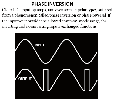

I deleted my discussion about using a TL082 as a comparator because it was in another thread. You are using an LM393 REAL dual comparator that does not have "Opamp Phase Inversion".
Your software oscilloscope "samples" and has "Hanning Smoothing" that messes up the PWM waveform.

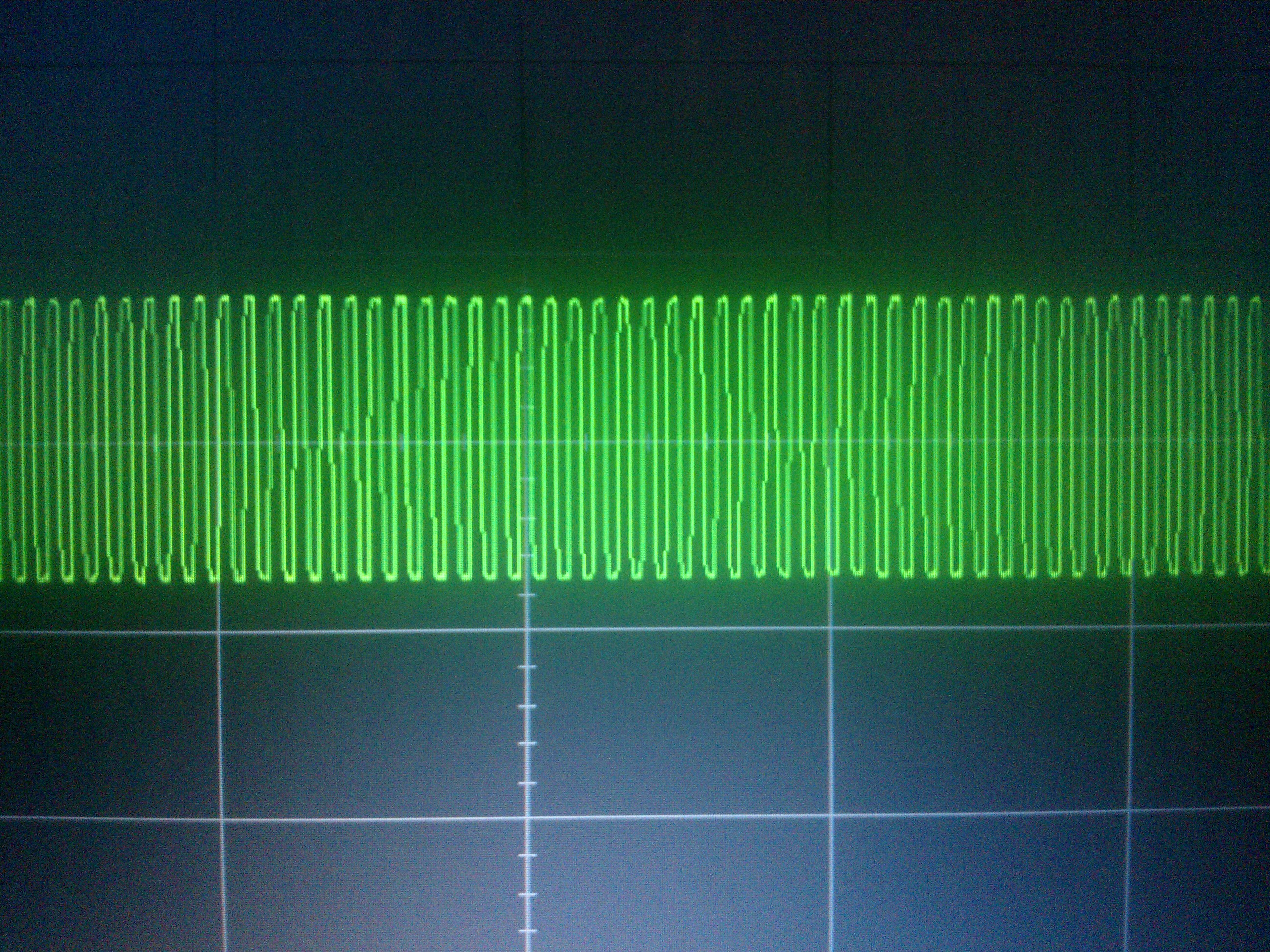

hello sir,i have been testing again the triangle wave with a DC reference voltage as you said and i noticed that instead of getting a square wave the triangle wave seems to grow in amplitude up to a point and shrink away as i adjust the dc voltage up or down and i have checked the pins for bad connection but evrything is allright as the comparator recieves the triangle wave at the input and the compartor is powered fully at the pin 8 but for some reason square waves are not coming out.i am beginning to think that what audioguru said before about the pc software scope messing up the PWM signals especially when i input both sine and triangle waves into the comparator because everything seems allright to me.you can check out the picture of the triangle wave at about 4500hz going into the comparator and unless my eyes are not good i can pretty much say that that is a triangle wave form.
guess i will never know what is really happening until i get a real scope.thanks for everything so far.
A 4500Hz triangle wave has harmonics up to at least 90kHz and is very clear when its bandwidth is almost 1MHz. Your sound card scope filters it into a 4500Hz sinewave that is modulated by the sampling frequency of the scope.
Your soundcard probably cuts frequencies above 20kHz so it is useless at these high frequencies.
Try using 200Hz for the triangle and use 10Hz for the sinewave. Then the output from the comparator will be a squarewave if a sine or triangle is inputted and will be a PWM waveform if both are inputted.

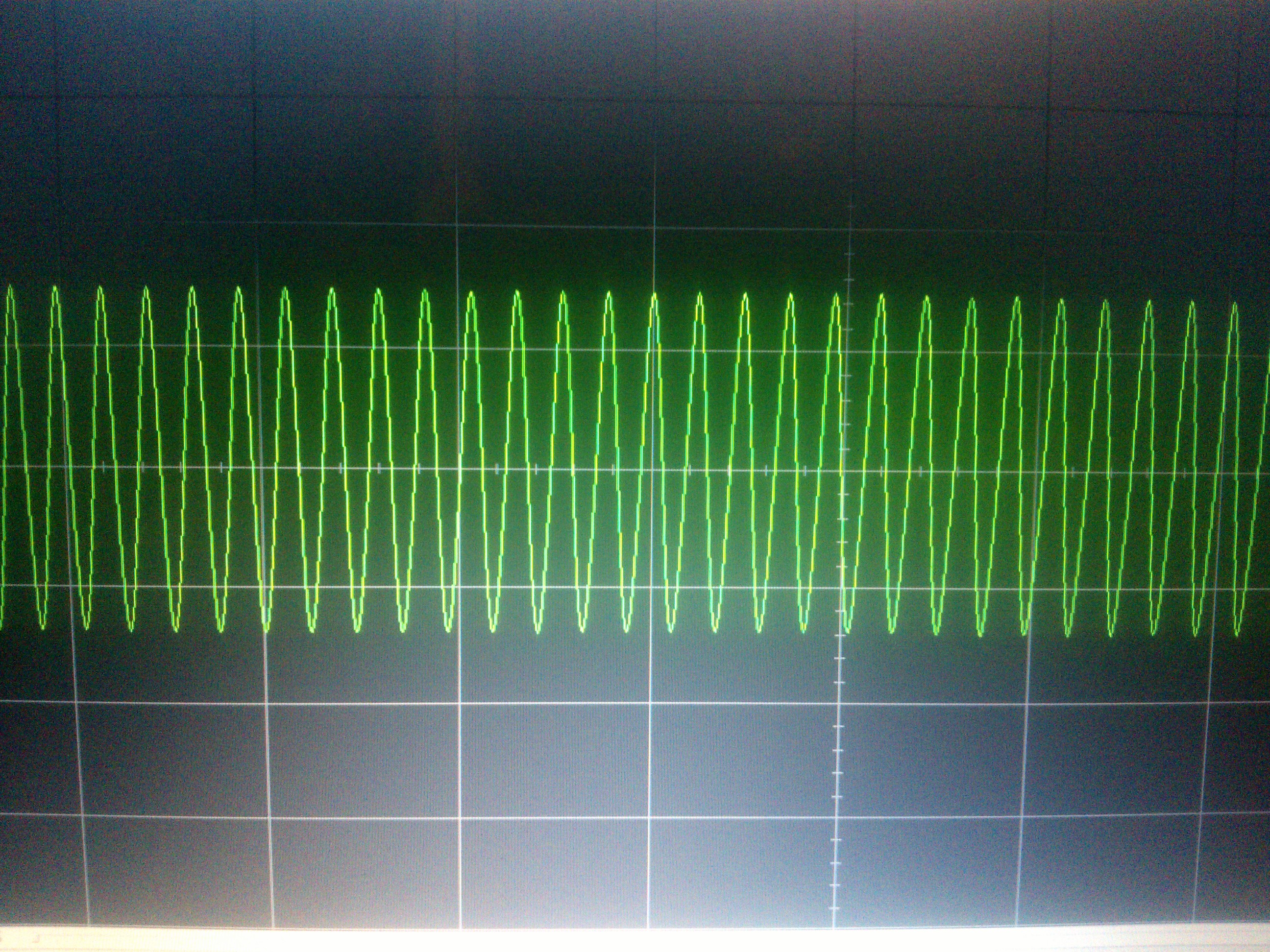

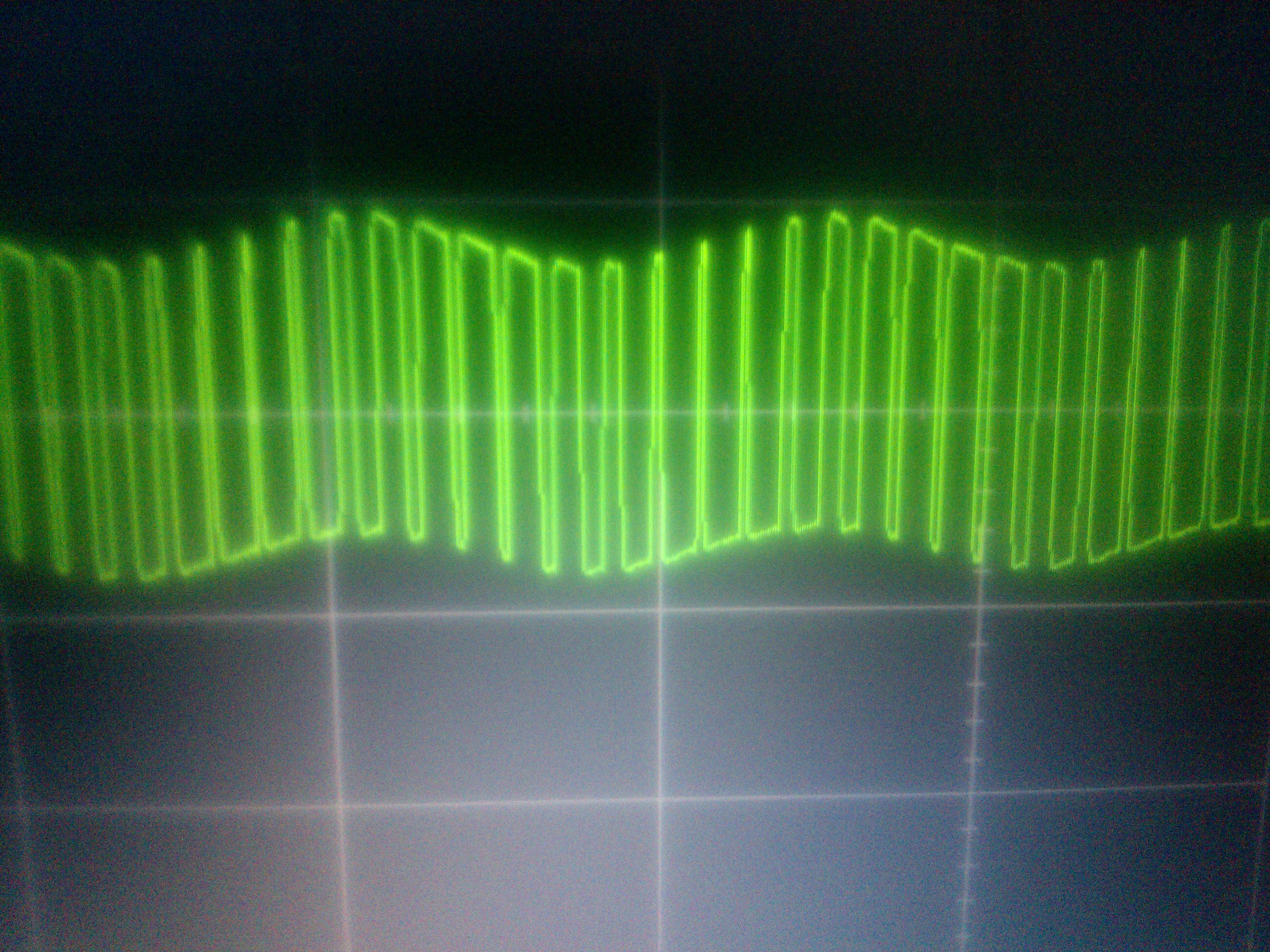

hello sir,you and audio guru were right i lowered the triangle wave to about 1000Hz and when i compared it to a DC refrence voltage i got PWM wave form at same 1000Hz.
i then further reduced the triangle to 500Hz and then compared it to a sine wave and low and behold i got PWM at about 500Hz out an when i varied the amplitude of the sine wave i saw what you meant when you said the triangle amplitude has to be higher than the sine wave so that the sine i chopped accordingly and we dont miss a pulse.it turns out that the pc scope has issues going higher than 1000Hz so it messes up the PWM.
would have to get a real scope.wow thats going to cost me but would like you to recommend the type of scope i should get should i ever attempt to get one interms of bandwith and stuff like that.
i am grateful for the help you and audioguru has given me so far in figuring this out.i now have a sense of relief knowing that my connections were right in the first place.

Where does your scope connect to when it shows "trianglesine.jpg"? I ask because it shows an amplitude-modulated PWM (the up and down waves) when PWM should not have any amplitude modulation. I guess it is caused because the pc scope is AC-coupled instead of DC-coupled.
lets assume the pc scope is DC-coupled,i have a some questions
what do you mean by where does scope connect t0 i dont quite get it?
also when you say it should not have amplitude modulation what does it mean and why so?
Right from the first post, it looks like the ground of the scope has AC content, as if the triangle wave has been modulated with a lesser frequency, This happens with crappy power supplies... or your scope ground coupling isn't right...
