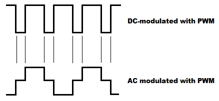

Hello again,
The best bet is to use 50 percent and 50 percent because the input requirement is to maintain equal and opposite volt seconds, and that is easiest to get at least close to by using a 50 percent duty cycle where the positive half cycle is +Vcc for 50 percent of the time and the negative half cycle is -Vcc for the other 50 percent of the time. But for reduced output the duty cycle can drop lower, like say 40 percent, and then it would be +Vcc for 40 percent of the time followed by 10 percent dead time followed by 40 percent -Vcc followed by another 10 percent dead time. That's the usual method. For a DC output the two half cycles are simply full wave rectified and filtered and that gives close to 100 percent duty cycle overall. For an AC output the PWM can be made equal and opposite over the period of one AC cycle.
A Transformer passes AC, not DC. A squarewave is AC. The positive pulse widths are the same as the negative pulse widths in PWM so it symmetrical and is also AC.
Here are my sketches of PWM. The top trace is DC PWM for a DC motor speed or for a light bulb brightness.The bottom trace can be passed through a transformer because it is symmetrical and also controls the speed of an AC motor or the brightness of a light bulb.
Hello again,
thanks guys for the explanation.i guess it is safe to use a max of 50% but permit me to ask what could happen if the volts seconds are not equal and opposite like using say 60% instead of the best bet of 50%?
i am guessing the transformer will suffer for it.
The primary ends up with a net DC current which makes it more likely that the transformer core saturates and ruins everything.
Even with 50 percent positive and 50 percent negative it is not guaranteed that it will work perfectly, as some net DC may still be present due to a slight difference in the positive and negative half cycle times and/or voltage levels. It then depends on the primary series resistance.
For a quick example, say we have exact 50 percent positive and 50 percent negative time periods, but the voltage during the positive half cycle is 1 volt higher than the negative half cycle. The average voltage over the entire cycle is then 1/2 volt, which doesnt seem like much, but if the primary resistance is only 1/2 ohm, that means we have a net DC current of 0.5 volts divided by 0.5 Ohms which equals 1 amp of current in the primary. Depending on the construction this may be ok or it may cause saturation.
