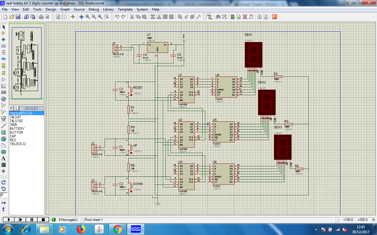

the problem of my circuit is jumping counts. I checked several times already . The stimulation is good . It will start as 0 and increase digit 1 by 1 . it has same result as down counter which is decreasing 1 by 1. However, it is totally different when coming to pcb board and breadboard. After i done the circuit, i tried at breadboard and found out there are few problems occurred . First, it will start with 999 after power supply is connected. Come to the counter up and down , it will keep jumping . I tried switch debouncer too and it is the same result. Currently , i am still check the problem and found out Q0 from 74ls192 will keep on no matter button for up or down. Below there shows the general design and detailed image for connections from proteus . This design on pcb already cost me for 2 weeks and still cant get the solution.

I am a long way from being any kind of expert, however I do recognise that circuit as very similar to one I built a while ago. I think your problem may be the 'floating' pins on U1, U2 & U3 .. .. .. .. I think D0 - D3 on each chip should be grounded.
If I'm wrong, someone with a better understanding will leap in and correct me, for sure ..
S
If you're not using the parallel load then I don't think the value on D0-D3 matters. However, it is good practice to ground unused inputs.
I suspect your problem is with contact bounce. I've never seen a switch arrangement where the button discharges a capacitor. Try changing to a more conventional debounce circuit.
Old fashioned TTL ICs needed a supply bypass capacitor at each IC.
Your new circuit has its diodes connected to numbers instead of some circuitry. There is no debouncing.
All this can be done with one microcontroller and you can add debounce and all sorts of other things without having to add a single new component.
I have not used chips for 20 years. They are all in the rubbish bin.
Having a switch discharge directly a debouncing capacitor is common. You could stick with it, but the circuit has other problems.
Yes, ground the unused data inputs. Even though they are not used internally, they still have active input stages that do *not* like to float.

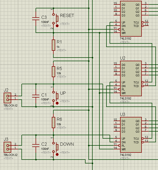

Bounce: In the original circuit, the debounce R and C are too small. The debounce period is only about 700 microseconds. Increasing both the R and C values should fix this. BUT -
These counters act on a positive edge, which is the trailing (slow) edge of your inputs. You need to reverse the input components so there is a positive edge when the button is pressed, not when it is released. BUT - you are using TTL chips, which require a fairly low impedance path to GND to be seen as a logic low. Try this:
Connect the switch between the count input and Vcc. Connect both the resistor and capacitor to GND. The switch now will make a rapid rising edge to the count input, what it wants to see, and the capacitor will filter out the bounce. The resistor must be small, like 1K for LSTTL and 470 ohms for standard TTL (330 preferred). And the transition level is around 1.8 V, significantly below Vcc/2. These combine to make the debounce capacitor much larger. Start with R=1K and C=100uF for a debounce period of around 50 milliseconds.
This also will have the capacitors hold the count inputs low during power-up, which will help with the 999 problem.
999: The counter increments on a positive-going edge. When power is applied, R5 and R6 apply count edges to both the up and down inputs *after* the power-on reset input has ended. It looks like the down count is coming in last. Increase C3 to 10 uF and increase R1 to 100 K.
I think the real solution to the 999 problem is reversing the input logic polarity explained above. If everything works, try decreasing C3 to 1 uF and then 100 nF and see if everything still works.

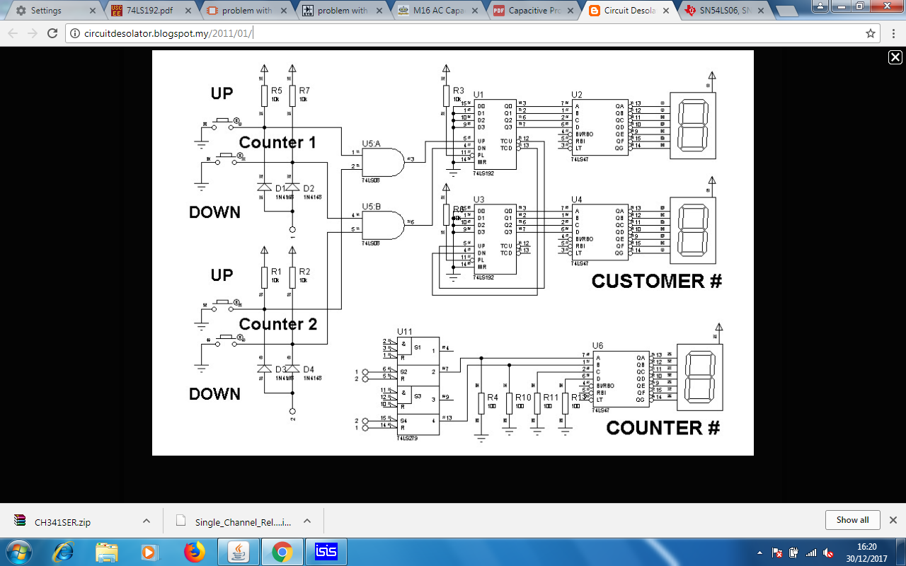

guys , i tried to use my circuit just shown above , now left bit more then success , i will post a complete circuit after i done . thanks for giving such many info and i really try them .
Does that mean it worked?
yesterday it worked( by using and gate, my counters can be increased 1 by 1 from 0 to 9 but another function cant , u just can succeed either up or down) , but now it is spoiled again T_T . no idea which part making wrong again .
