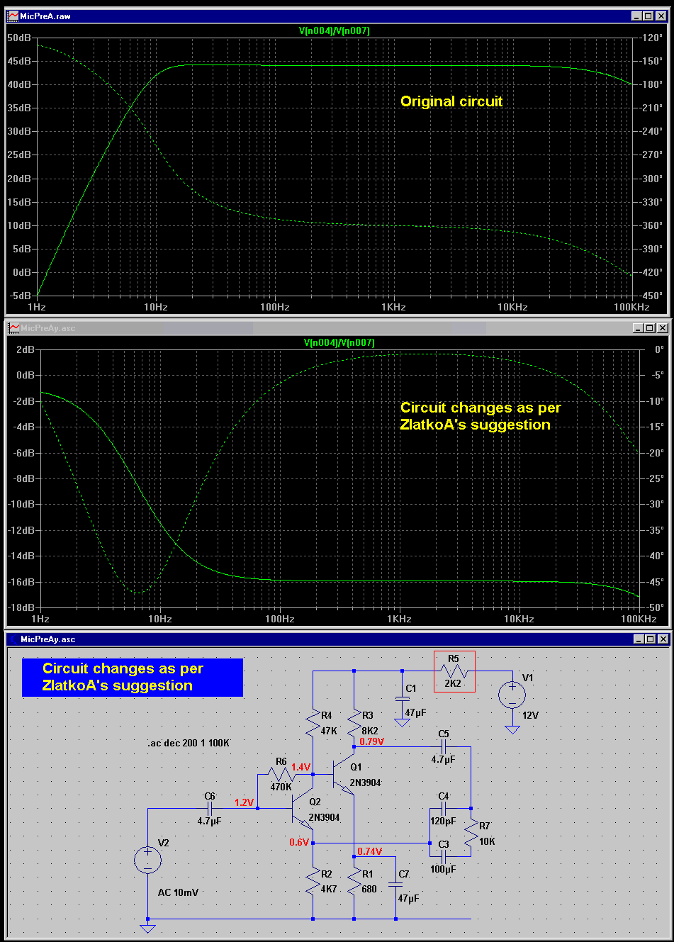

remove R9
remove R4
remove C6 then in this place put resistor with 470k
remove R7
change R5 to 680 ohms
change C3 to 47 uF
change R1 to 2k2
use voltage 6 to 12 volts max 15Volts
Who will draw this completely new schematic of the changes suggested by ZlatkoA?
With this mod the performance would suffer I fear. Same collector feeding both bases.
However the modded schematic is attached.
The suggested changes failed to work as one transistor is now fully saturated.
  • MicPreAy.asc
Even if the transistors are re-biased correctly the circuit changes by ZlatkoA wouldn't have anywhere near enough gain to be a mic preamp.
