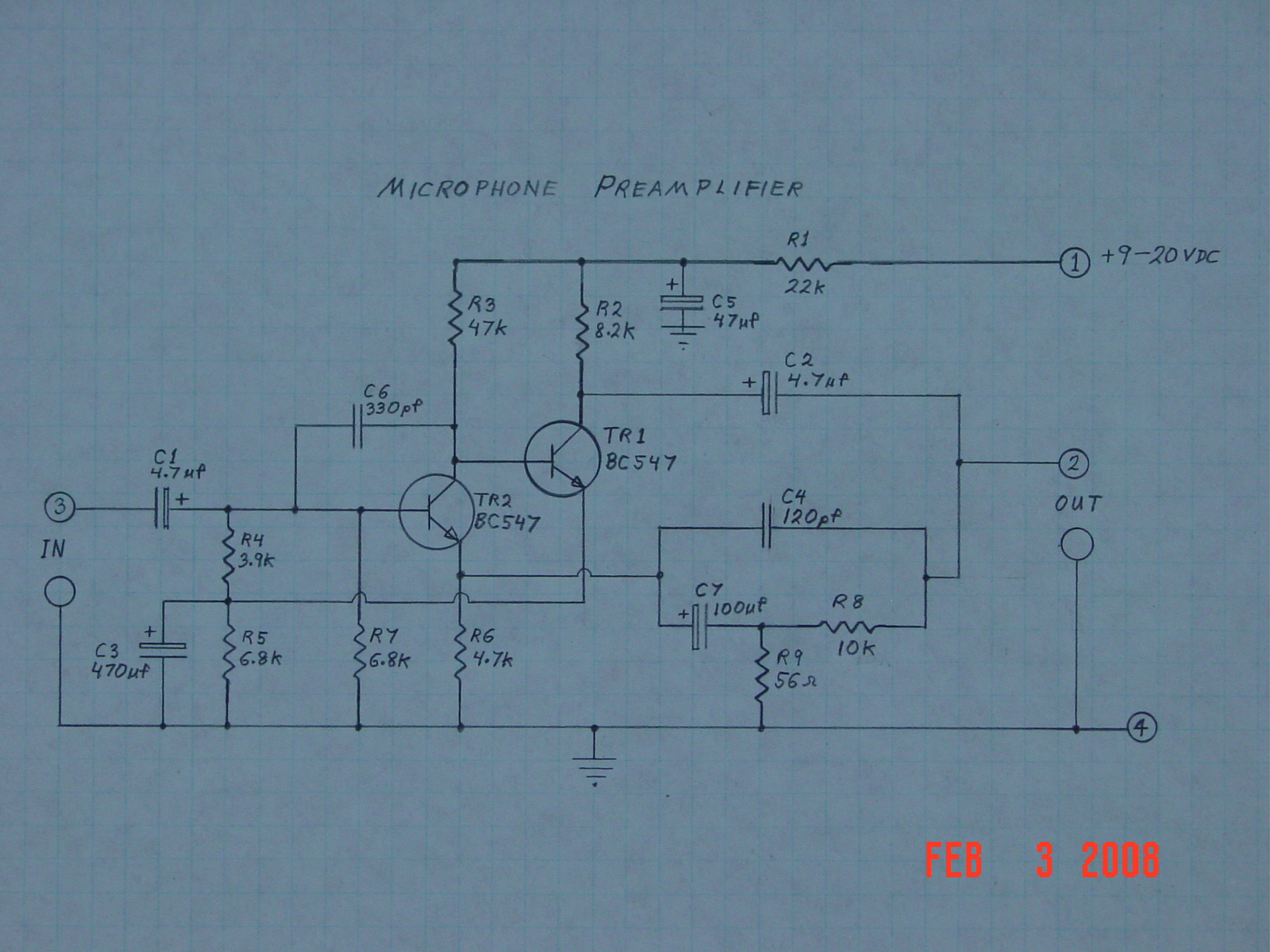

The attached preamp circuit is a reproduction of what came with the “Smart Kit No. 1024” microphone preamplifier kit that. It’s purported to be suitable for dynamic and condenser mics. I carefully soldered it together and put it in an enclosure with appropriate jacks. It didn’t work.
An oscilloscope (that I built from a kit) shows my dynamic mic putting out a signal, but the preamp’s output is nearly flat-line.
The outfit in New Hampshire that sold me the kit has been, frankly, a bit rude, but they eventually, grudgingly agreed to take a look at the silly thing. They said it will be low priority (nice folks, eh?), so I don’t expect a response for some time. In the meantime, I bought all new components from DigiKey, including good quality metal film resistors, and built another preamp from scratch, on perfboard, following the same circuit. It doesn’t work either.
I’m no electronics wiz, but I’ve put together a number of projects over the years, some from scratch. They all work. I can’t figure out what’s going on with this little beast. Do you guys see anything odd about this preamp? Does it look like it should work?

It looks like it should work. Take some DC voltage readings at the emitter, base, and collector of the transistors and post the results here. Also post the exact supply voltage that you are using and the DC voltage at C5.

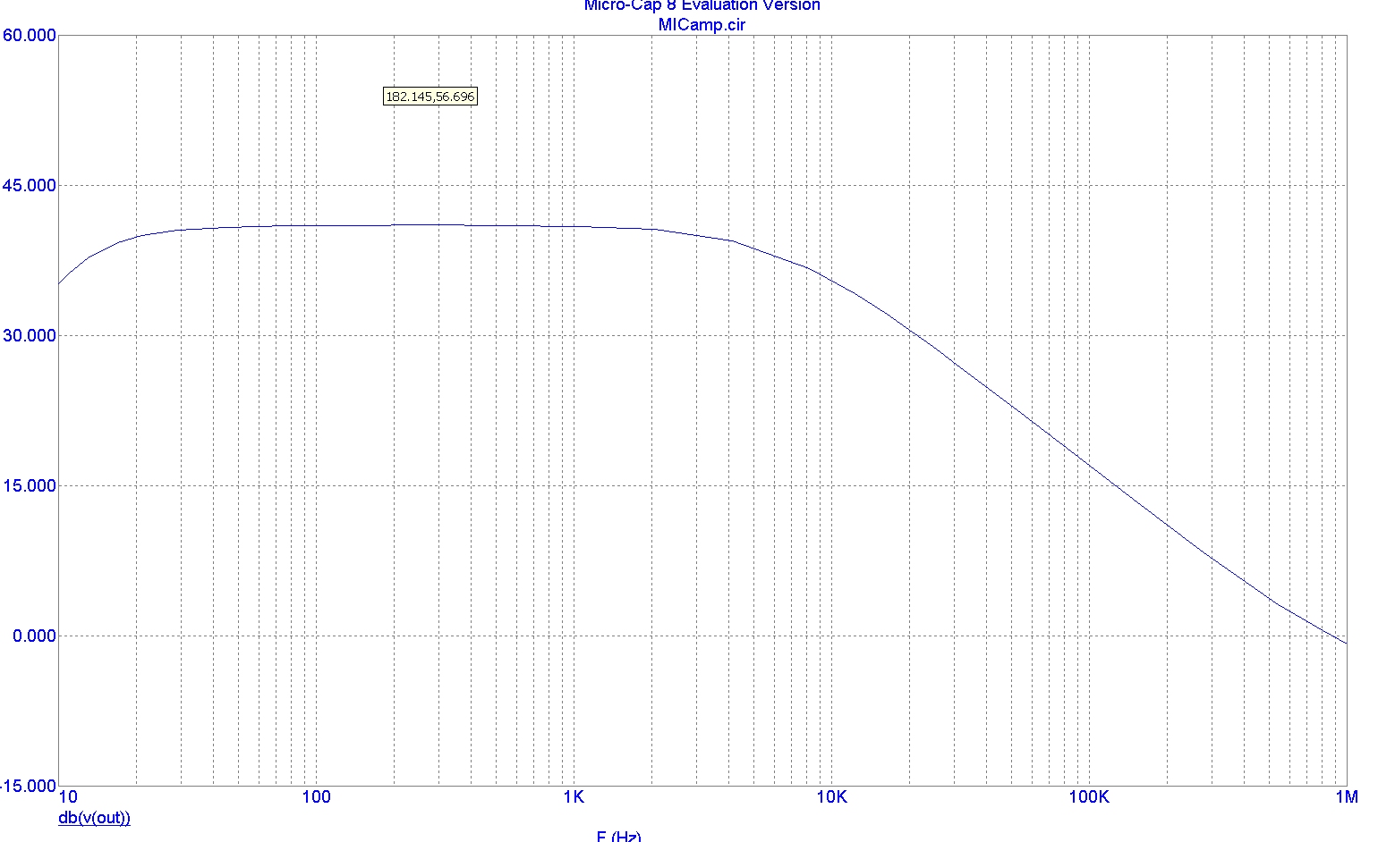

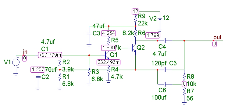

For a quick check I ran a DC test on your amplifier using a 12 volt supply. I used 2N2222A transistors so things will be a little different. The numbers in pink boxes are the DC voltage.
The AC frequency response shows that it has an “audio” frequency response.

The collector voltage of the second transistor is lower than its base voltage and both transistors are almost saturated.
The frequency response is not for audio because it rolls off the high audio frequencies like an old telephone or old AM radio. Listen, it doesn't have hisssss!
If you change R1 to a 2.2K, the bias voltages will look a bit better.

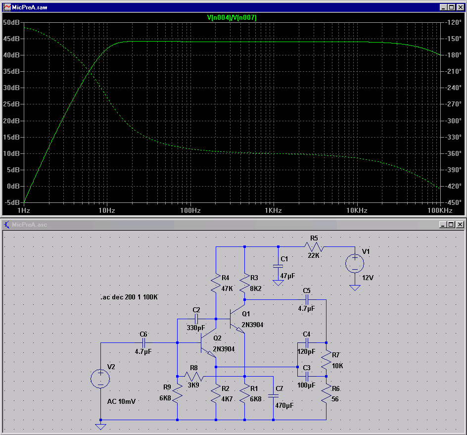

My simulation result shows a "flatter" frequency drop off response at frequency >10KHz.
Maybe it is the different transistors being used. Anyone wants to try this the .asc file is attached.

Thanks kchriste and all for the replies. As requested, I’ve listed some voltage readings. These are all between the noted lead and ground. Is that what was needed?
Supply: Exactly 12VDC, regulated;
TR1: Collector: 1.84
Base: 1.84
Emitter: 1.24
TR2: Collector: 1.84
Base: 0.79
Emitter: 0.23
C5: 4.28

TR1: Collector: 1.84 (1.73)
Base: 1.84 (1.89)
Emitter: 1.24 (1.27)
TR2: Collector: 1.84 (1.89)
Base: 0.79 (0.80)
Emitter: 0.23 (0.23)
C5: 4.28 (4.20)
The DC voltage of my simulation is shown next to yours in red. It is a very close match to your measurement and that of ronsimpson's.
I have no idea why your finished circuit won't work but it must be a very simple reason.
Edited: Also check that your dynamic mic does not put out a steady DC voltage higher than 0.8V. If there is a steady voltage higher than that, then the polarity of the input capacitor C1 is not correct. The leakage current of the capacitor will easily mess up the biasing of the circuit. If that is the case, you have to use two capacitors connected back-to-back in order to block the DC voltage from the dynamic mic, but the capacitance value need to be doubled to 10uF each. i.e. positive of 10uF cap1 joins to positive of 10uF cap2. Negative of cap1 to Tr2 base and the negative of cap2 terminal for signal input.
My first thought is to change R3 to 22k. The voltage on Q2-C went up to 3.9volts.
Thought 2. Change R1 from 6.8k to 10k. Q2-C=2.8 volts.
We need to get Q2C up to around 3 volts which is 1/2 the voltage on the 47uf cap (supply= 5 to 6 volts).

@ronsimpson,
I have figured out why the high frequency response of the Preamp circuit is flatter in my case.
Your simulated circuit is a little different from that of Ventura's regarding the 120pF output feedback capacitor connection. You have connected it to the other emitter instead.
