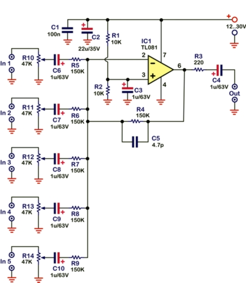

Modified Karaoke circuit, microphone input bass/treble input stage for removing microphonic effect on original PCB.
Issue was around Bass Treble and Echo mixer circuit. removed op-amp and related components for bass treble, replaced with circuit made on Stripboard/Veroboard
Schematic based on jrc4558 pre-amplifier circuit published in componentsinfo (Not posting URL)
posting original schematic and modified one. (water mark is there in image).
Modified values (based on articles online) marked in red.
Tried both Inverting and on-inverting circuit, Inverting op-amp circuit has more distortion , hum noise when connected, this does not happen with Non-Inverted op-amp circuit.
Input 1 and 2 is from another op-amp from microhphone UHF receiver circuit.
Modification removed microphonic effect.
Issue faced: when one of the mic (single mic) is used it works good, turned up Mic-A or Mic-B (one of the mic) volume pot to full, no distortion.
Switched on scond mic-B, turn volume up, when pot position reaching around half way howling starts, increases in volume by itself, when one of the mic volume is turned down howling stops, when both mic volume pots are at less than half no howling, but mic volume is too low.
accidentally touched pre-amp resistor on pin 2 / 6 reduced/stopped howling sound (touching causes other distortion but stops howling)
will it help if 33pf capacitor is connected in parallel across 100K resistor (feedback) ?
Requesting help to make circuit stable.

Worked on drawing schematic from component layout on PCB.

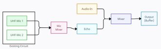

Attached schematic is first stage, this circuit gets input from UHF Microphone IC KT0651.
I will make next stage using mixer circuit from danadak , mix input from two microphones mixed output connects to PT2399 (echo circuit).
Mic input Schematic on PCB (reverse enginneered from PCB traces).
I have DSO, connected channel 1 probe, Auto measure output of capacitor C1, microphone preamp schematic below
some one help in interpreting DSO readings , advice me steps for checking further ?
The opamps have a gain of only 1 but the output is massive 50Hz of mains hum.
Poor shielding of the input cables, the entire circuit and the output cables?

I will make preamplifier PCB, use only UHF microphone receiver from existing PCB.
All AC to DC power supplies have a large filter capacitor on their output. But in your circuit it is only 100uF with C2 which is too small for a filter but is good if a battery is used.
R10 feeds all power supply noise directly into the input of the first opamp.

Yesterday discovered source of 50Hz, connected DSO probe on GND plane on board, showed 50Hz waveform, then saw board was not powered on, I had removed adapter forgot to plug it back, did not suspect speaker because its from IKEA, disconnected speaker cable, placed probe on GND tab of RCA, showed 50Hz waveform. Finally found source of 50Hz noise.
Another accidental discovery microphone howling stopped, it occurred only when microphone faced speaker or very close to speaker, mic volume is ok, usable.
Upon checking pre-amp observed I had mixed up capacitor resistor values.
Used 10k and 10k resistors instead of 10k and 1k, connected 2.2uf capacitor at output.
did not understand purpose of R6 and C1, as most articles explained (R1 is feedback) calculations, and for me math formulas are less interesting.
some circuits has only resistor or capacitor connected to ground from inverting pin,
my understating is capacitor C1 changes frequency response, higher capacitance can handle lowest frequency?

The opamp circuit in post #31 has a voltage gain of (1 + R1/R6)= only 2 times.
If you filter out 50Hz then you also filter out many bass sounds. Prevent 50Hz at the input instead.

I am working on re-designing PCB, will use only UHF receiver portion from existing PCB, in new (customized PCB) will use low gain op-amp circuit to filter at input level,
I am looking at possible passive circuit like inductor at input GND or use op-amp filter circuit at input.
