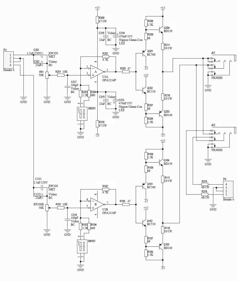

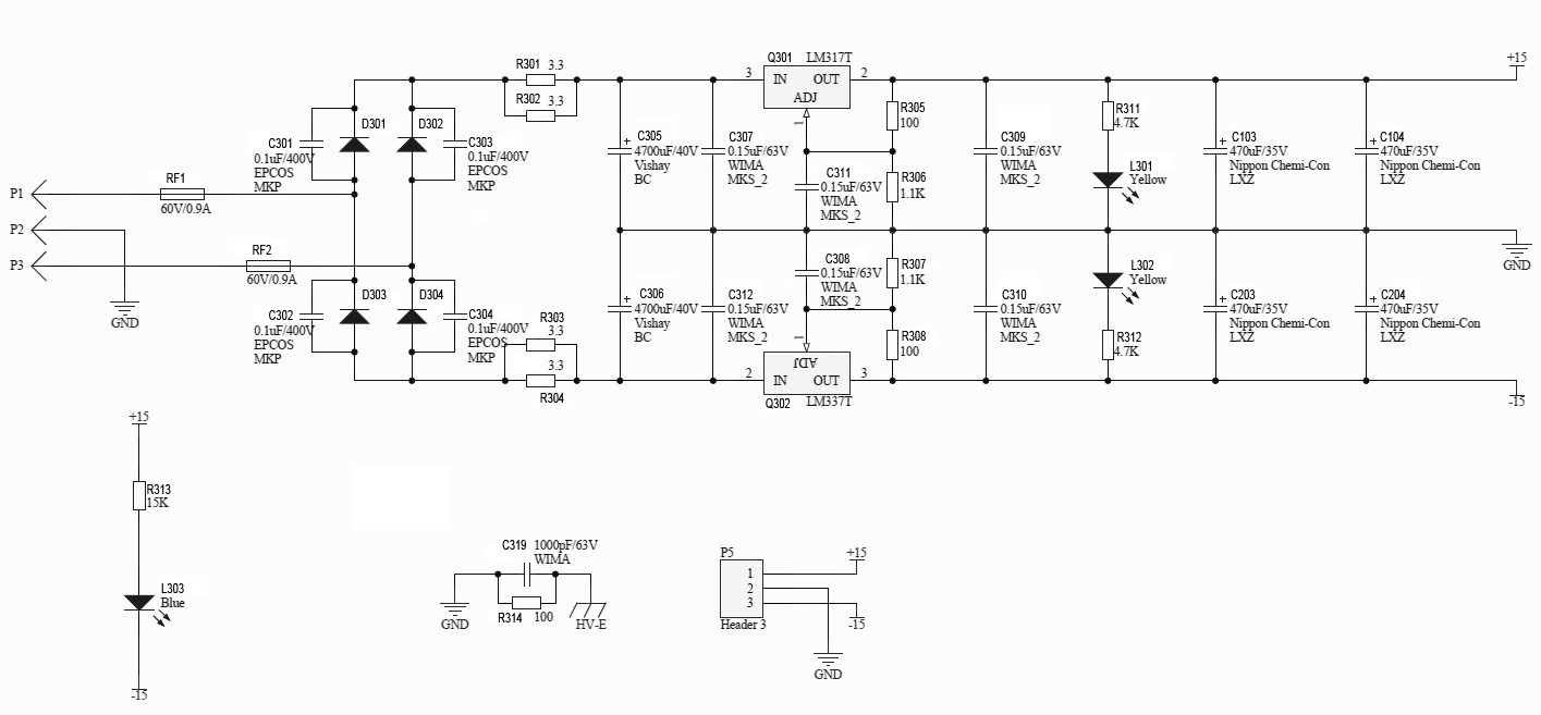

I´m testing several discrete OpAmp´s for my DIY portable headphone amplifier (with first generation NiMh 16VDC/2Ah battery pack), all with good results. And the batteries are drained to about 7VDC, then the volume will be a lot lower and if going below the OpAmp´s working voltage, it will also be distorted. Now, I wonder about some things (please see attached schematics):
1. As the input power is directly connected to the +/-15VDC output at the voltage regulators LM317/LM337 to minimize the power draining from the battery, so also the voltage reg´s and the two big power power filter cap´s and of course also the rectifier diodes, will not be used - may the voltage reg´s draw any mAh current backwards, altough there are no draining component at this direction other than the unused power stage. Maybe it´s best to remove the whole power section (by removing the voltage reg´s or cut the PCB´s copper conductor´s for the output pin´s)?
2. Should the two big filter cap´s (with original value 4700uF swapped to 10000uF) be used altough the amp is running by batteries, or will the OpAmp be satisfied without them powered in realtime directly from the batteries?
3. Can I safely remove all the three (or any of them) LED´s for the amp, to minimize the battery draining?
4. As those discrete OpAmp´s will accept 24VDC, will it be fine if raising the batteries voltage to something between 18 and 24VDC?
5. With above in mind, should the amp be better if replacing the NiMh with Lithium, such as dynamic and transient speed etc?

Of course, they don't do anything - they also don't waste a great deal of power either.
For a battery operated device you don't need all the complicated mains power supply, and do you really need such a high power amplifier just to feed headphones?.
No different - battery type should have no effect, but Li-Ion are vastly superior to NiMh as a battery (and far easier to charge).
The supply to the amplifier needs to be approximately symmetrical and not significantly exceed + and - 15V to 0V
(The absolute limit for the opamp, at which it may be damaged, is +/- 18V so 36V across the power connections - try to stick to no more than 30).
You do not need the rectifier, regulators and all the extra input smoothing.
You need either two batteries to give + and - supplies, or add an extra circuit to create an artificial "zero volts" at half the battery voltage.

I notice that the amplifier design uses NO Negative Feedback from the output. Then the driver and output transistors will produce uncontrolled distortion if the headphones have a fairly low impedance and the loudness level is high. Also the damping factor will be low.

I assume you are using the opamp & cap to produce a virtual ground for the input side.
Do you have the outputs capacitively coupled to that, or to negative? Coupling to the input ground could cause distortion, it would be giving some positive feedback at low frequencies.
Otherwise, as long as the single supply is adequate for the output you need, it should work OK - though you will have to adjust some resistor values in the transistor buffer sections to allow for the lower overall voltage.
The 1.5K resistors will need reducing to restore a similar bias leves between the output transistor bases, to what would have been present with 30V total supply. Possibly 680 ohms is worth a try.

Every audio power amplifier and opamp have seen has the output stages included in the overall negative feedback to reduce distortion. Not this one.

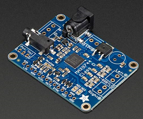

I think this amplifier will produce more signal with less power from the battery. "Stereo 20W Class D Audio Amplifier - MAX9744 "
120676
  • Power from 4.5V-14V DC voltage
  • Up to 93% efficient (88-93% typical)
  • 20mA quiescent current (or put into shutdown for 1uA quiescent)
  • Up to 29.5dB max gain
  • Use DC or AC coupled line-level input, up to 3Vpp
  • Filterless Spread-Spectrum Modulation Lowers
    Radiated RF Emissions from Speaker Cables
  • 20W Stereo Output (4Ω, VDD = 12V, THD+N = 10%)
  • Low 0.04% THD+N
  • Integrated Click-and-Pop Suppression
  • Short-Circuit and Thermal-Overload Protection
  • Link

Not everyone, as I've already mentioned there was a spate of low feedback and local feedback only audio amplifier over the last 20 years or so.
Any thoughts how to get negative feedback for this amp; should i solder some resistors or caps between the output and input pins of the OpAmp? Remember I´m using discrete OpAmp with pure Class A.
The opamp has feedback - that's what the 4k7 resistor between output and negative in does.
Only the output buffer is not included in the feedback loop, but as it is just emitter followers with high bias, that should be reasonably linear over a moderate range of output voltages, more than enough for headphones.
That is very dependent on the bias resistors being matched to the supply voltage, as I said previously.
Note that the original operates on 30V with a centre ground.
You supply is not plus and minus 16V, it is 16V total - with the extra circuit to produce a mid supply zero, the supply relative to that (which is the critical bit) is +/-8V
The bias resistors need to be changed appropriately.
As it's also unregulated you have to allow for the full range of battery voltage, from 1.5V per cell the instant they are taken off charge down to 1V per cell, which is when they are considered totally flat. Most of the time it will be working at around 1.2V per cell & downward from that.

But unless you're posted circuits are completely wrong, you're NOT using discrete opamps anyway, as is obvious by the opamps in the circuit. It's just an opamp with a current buffer on the output.
Should it be best to raise the battery voltage to about 30Volt? Then it should be 15VDC to the OpAmp!?
I´m also worried about the rail splitter TLE2426 for virtual ground, as it may not be able to deliver the current needed as it can deliver up to 20mA! Is that maybe enough for this purpose? The OpAmp themselves will drab between 14 and 20mAh. Replacing it with two resistors from + and - are maybe not ideally, but what if I remove the virtual ground generator completely? But as I told before, the sound are remarkably good.

The driver and output transistors will probably add some phase shift which will cause the opamp to oscillate at a high frequency requiring careful compensation if negative feedback from the driver and output transistors is added.
Does anybody have detailed spec's for this amplifier so we can see its distortion levels? Since its output power is not much then the massive driver and output transistors might be linear enough.
64 ohm headphones with a very loud output of 100mW use an RMS current of only 40mA. Then the buffer transistors do not do much more than make heat.
With 600 ohm headphones then 100mW needs a peak voltage of 11V and an RMS current of only 13mA which the OPA2134 opamps can easily provide without the output buffer transistors.
