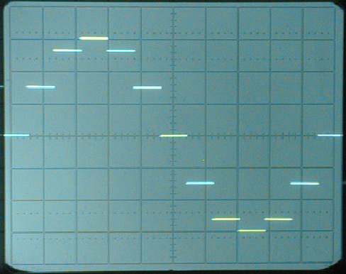

You can create sin "ish" waves with micro controllers using the built in Hardware PWM outputs. It's a digital wave, so your output signal would be stepped.
Using a simply RC filter, the pulses will appear as a steady voltage.
Keep in mind that your maximum resulution with this method (using Proton) would be 256 steps between 0 to 5 Volts (0.019V per step)
Proton HPWM command;
HPWM Channel , Dutycycle(0-255) , Frequency(0-32767)
HPWM 1, 63, 32767
The output;
But as exlained earlier, not sure of your overall requirments, this is just a thought
