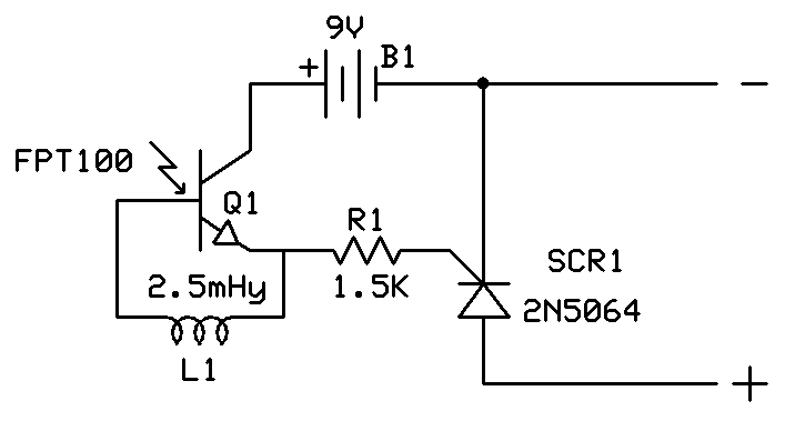

I looked at that circuit, and while it might work correctly with some flashes the problem is that many modern flashes have a continuous current between the trigger and the common. If this current stays above the SCR continous on current, then this circuit won't reset. But you could always try it and if it has trouble, add the diode, phototransistor, and try again.
I know what you are referring to, the Canon EX are an example of flashes that doesn't do well with SCR triggers.
I have successfully used HV transistors to trigger these EX units but then the trigger doesn't reliably trigger all models of the more common Vivitar's.
So it seems like you have a compatibility problem no matter what you do, at least I have not come up with a universal solution.
I don't have a EX to test but I would like to know if a resistor in series with the SCR could help. My three different model Vivitars will trigger when shorted with a 25k resistor.

Here's a homebrew slave trigger that I used for several years. Similar to the one crutschaw posted. The standby current draw was about 0.5µA...I never had to replace the batteries. :) Because of the choke in the base-emitter circuit it was immune to ambient light levels. I suppose you might replace battery with his(?) resistive-divider/capacitor power supply. I had experimented with a L14F2 photo darlington, with better sensitivity...but never went ahead and changed it.
Ken
