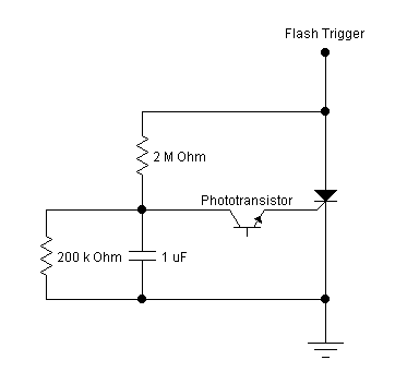

As a keen amateur photographer, I used to have a studio setup using slave flash triggers. However some dirty mongrel burgled my house and stole all my camera gear.
I've replaced most of it but the flash triggers are now about $70 each so I want to build a few.
Searching the net, all I can find are silly PIC contolled units and others that require batteries.
The originals, used on cheap small flash units, used the 200-400 volts of the flash capacitors for power, this appears on the flash trigger lead; no extra wiring was involved, you just plugged the flash into the trigger unit and the main flash would set them all off.
Anyone out there have a circuit for such a beast?

I build a trigger for my old flash unit a couple years ago that has a couple hundred volts on the trigger. I wanted to fire it from my digital camera which couldn't tolerate the voltage thus I built the trigger. It consisted of a photodiode, an SCR, and a couple resistors and a cap. As I recall, the circuit was about as attached. I'll look further to see if I can find the exact circuit I used.
The high voltage charges the cap to about 20V. When the primary flash fires it causes the phototransistor to conduct which triggers the SCR which, in turn fires the slave flash.
I have the phototransistor looking through a small hole in a small light tight box, which contains the circuit, to minimize ambient light. You may have to experiment somewhat to get the desired sensitivity.

Crutschow's cct is exactly the thing I need, all we want now is the type numbers of the devices.
