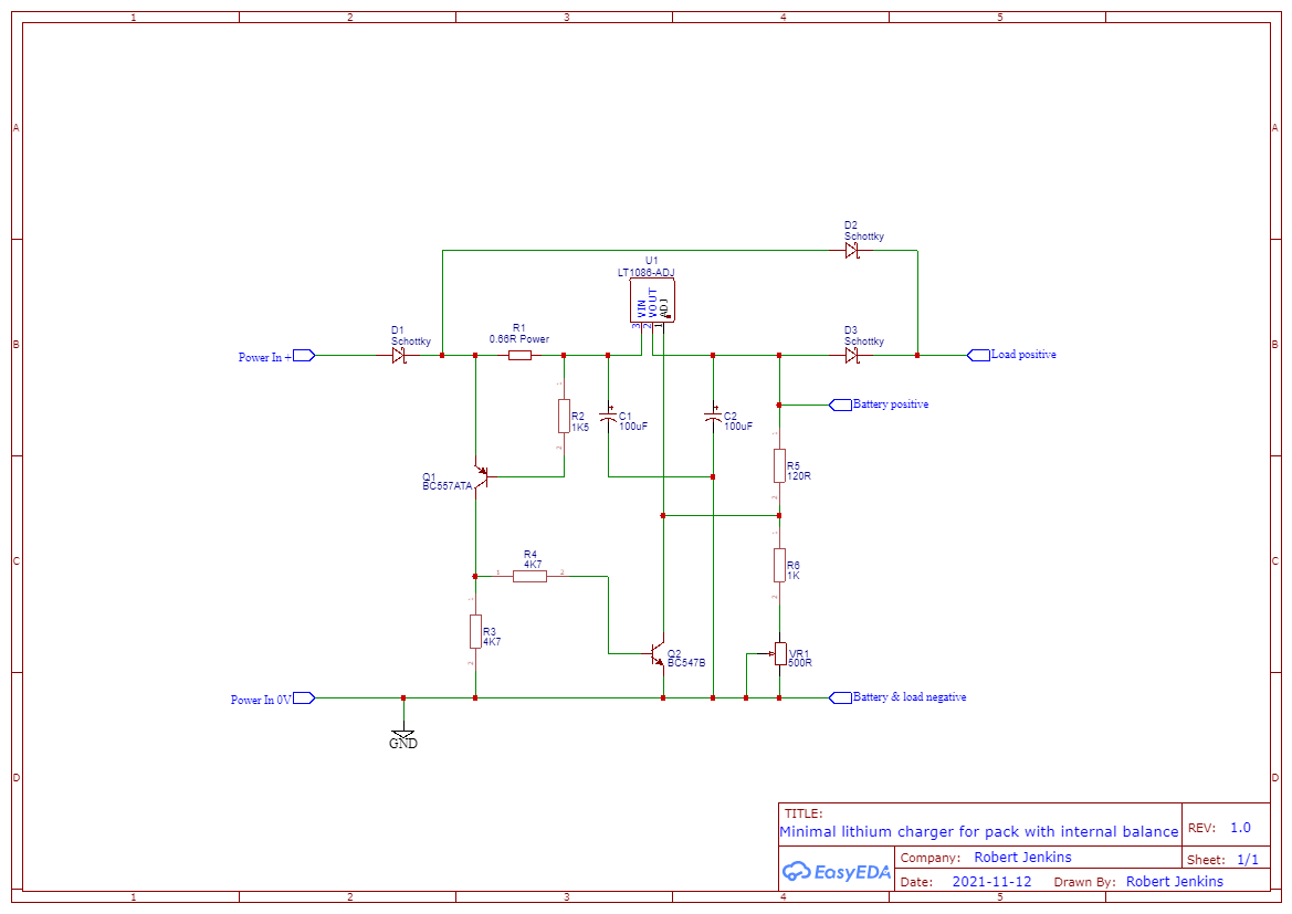

This is how I do it:
The power feed is routed around the charge control and battery using appropriately rated diodes, whilst external power is connected.
As that voltage is higher than the battery voltage, the output diode from the battery is reverse biased and does not conduct.
This diagram includes the charge circuit, which is only about 1A in my case. D1, D2 & D3 are the power routing diodes, you can use an appropriate charge controller for your battery pack.
Note that any pack using series connected lithium cells must use a balance controller, otherwise cells may burst or catch fire. I have a combined balance and protection board as part of the pack I use with this.
The overall charge voltage and current limit must also be precisely controlled.

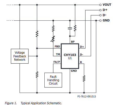

If you want to charge Lithium Ion batteries, do it safely. I did not evaluate rjenkinsgb 's circuit in post #3, and it might be perfectly safe.
Because batteries that are prone to problems (like catching fire or exploding) if not charged correctly I would consider an integrated charge controller from a company I trust, this Power Integrations controller, for example.

Thank you, I'm only capable of assembling ready made consumer boards but I will look out for one with the CHY103 chip.
