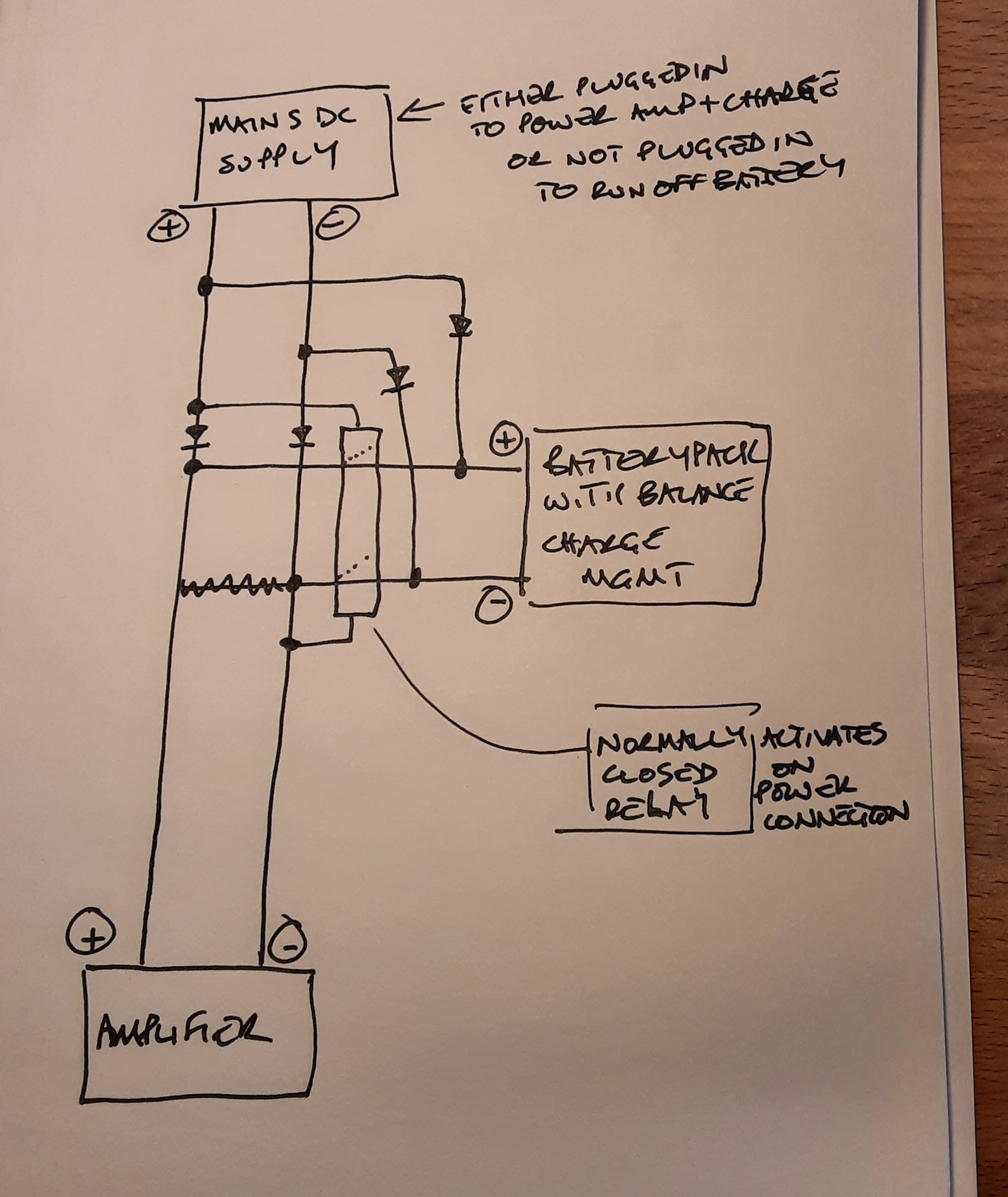

Passthrough charging-simple but impossible to achieve?
I have seen parties at a park with a loud sound system powered from a car's lead-acid battery carried in a wagon.
I have seen dead-battery cars started with a small portable Lithium battery. The small Lithium battery can do both.

Please don't laugh but would this work?
No, sorry.
It needs a charge controller as well as the balance/protection board.
The charge circuit has to exactly set the voltage applied to the battery, and limit the current to a safe level when the battery is not at full voltage.
It's only fully charged when at the correct voltage and the current has dropped right down.
