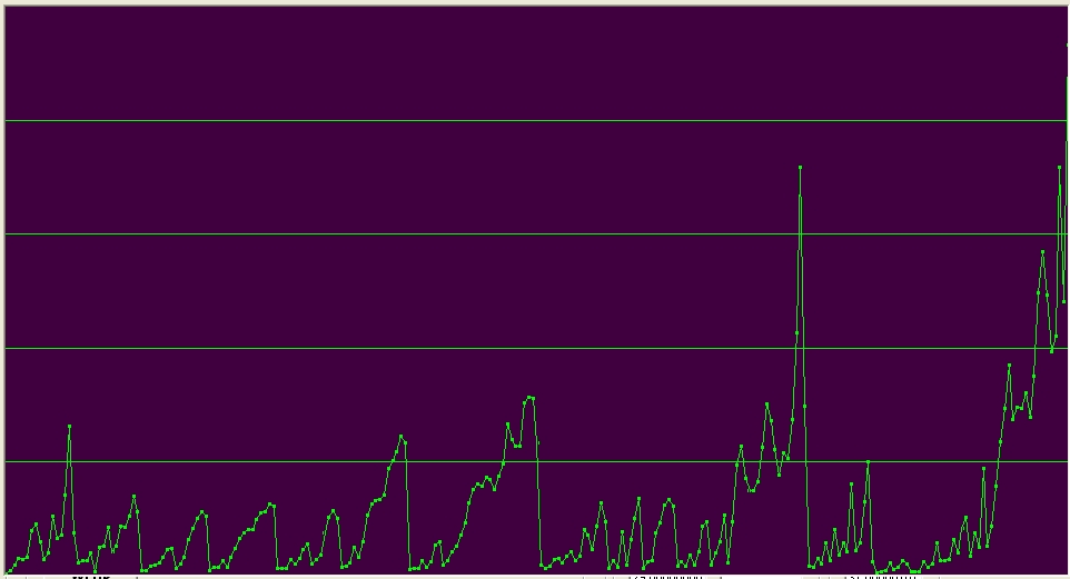

Thanks for sticking with it, much appreciated! Your programs confirm the readings I'm getting, for an input of 0V the readings are clearly around this value, the same for an input of 5V. For each voltage input the results are actually not totally random but form part of a set of values. I did some graphing of the readings as you suggested and some interesting results were thrown up. I've combined the results into a single graph ( see attached ). For each voltage input ranging from 0V to 5V in steps of 0.25V, I took 100 readings and plotted them on their own graph along the x-axis. There is some sort of transition around an input of 2.5V. I don't know what these results are an indication of. I've searched the internet for example circuits utilising the 2543 and it seems to be a popular IC for ADC conversion, but I haven't as yet come across any mention of this particular problem. There are suggestions as to how to wire the 2543 up in terms of seperate grounding of the analogue, digital and power supplies in order to minimise errors, but I gather that this is to ensure full potential accuracy as opposed to overcoming seriously bad readings. I'm going to re-arrange the grounding and see if this makes any difference...

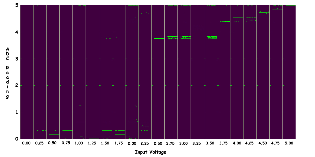

Yes, that is an error or rather an omission, I have pin 25 as the ground. I've done some further analysis. I've used the DAC to supply a range of input voltages to the ADC from 0V to 5V in steps of 20mV. For each voltage input I took 100 sample readings and averaged them. I plotted these average readings on a graph, with input voltages along the x-axis and averaged ADC readings along the y-axis ( see attached graph ). The results are very consistent from run to run. I've changed the grounding but the result are the same.

Hi Salvatore,
Have looked thru your results graph.
Is it possible that you could post a copy of your latest program?
On your original program in the first address sequence, where you had the copy/paste error, are you still switching Dta2 CS line, on the D9 clock cycle??
If so, you are resetting the ADC's internal counters and all your sampling will be out of sequence. This could account for the 'repeatable error' in the results.

Guess what? I found out what the problem was... the DB25 printer cable I was using..! Doh! In order to test if the software worked on another machine, I downloaded the software to a laptop, connected the printer cable as normal and I got exactly the same rubbish results. But because I could get the laptop very close to the circuit I decided to remove the cable and plugged the circuit's DB25 male connecter straight onto the laptops parallel port, and hey presto, a straight line graph..! Analysing individual ADC reads, the 5 LSB's are a tad random meaning a 32/4096=0.0078% error at full scale. This is still pretty good for my purposes but I know the ADC is capable of better. This is more than likely the inputs and/or the way the circuit is laid out so a bit of work to do there. This also begs the question about the cable itself. Clearly it is only the DATAOUT line that is getting corrupted because the other lines are working well enough to drive the DAC with no problems. As an experiment I'm going to change the DATAOUT line for use with another status pin and see what result I get. It may be that he cable itself is at fault I'll have to see. Any how, after all that banging my head against a brick wall the mystery is finally solved..phew..! Thanks for all of your help, it certainly kept me going!
