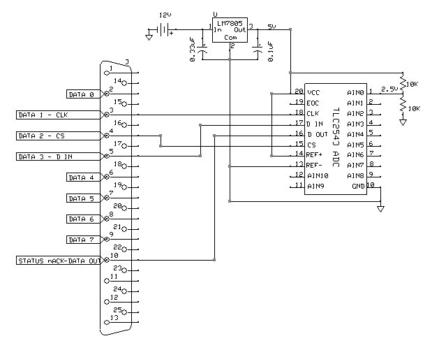

Hi All,
I posted a while back on the use of the PC parallel port to drive a DAC and ADC as an interface to a variety of sensors/PWM's. I breadboarded a circuit and have written the software in VB6. The DAC chip performed perfectly first time out ( not what I was expecting! ), I can specify a voltage by moving a slider in the software and instantly get a corresponding voltage output. :D The ADC uses the same SPI interface and is driven in a similar way to the DAC. Although I can get the ADC to respond and return a voltage, all I get back are random spurious readings even when trying to read the internal test reference voltage. I've been through the datasheet with a fine toothcomb but cannot find anything that could be causing the problem, at least from an electronics perspective. I've checked the software thoroughly, slowing the timings right down to tenths of a second, making sure that everything is synchronised in terms of input clock pulses and data and the converted output data, but it's got me stumped. :confused: If anyone has experience of the TLC2543 ADC or even of driving this IC through the parallel port I'd be greatful for any input! :) I've attached a schematic showing the breadboard setup.
Thanks!

hi salvatore,
Looked thru your VB code fragment, unable to run it as its not complete.
Perhaps a simple question, are using Windows XP, if so you will require a *.dll
in your Windows/System directory. I use 'inpout32.dll'.
I have written a parallel port test program using VB5, if it would help let me know and I will post it.

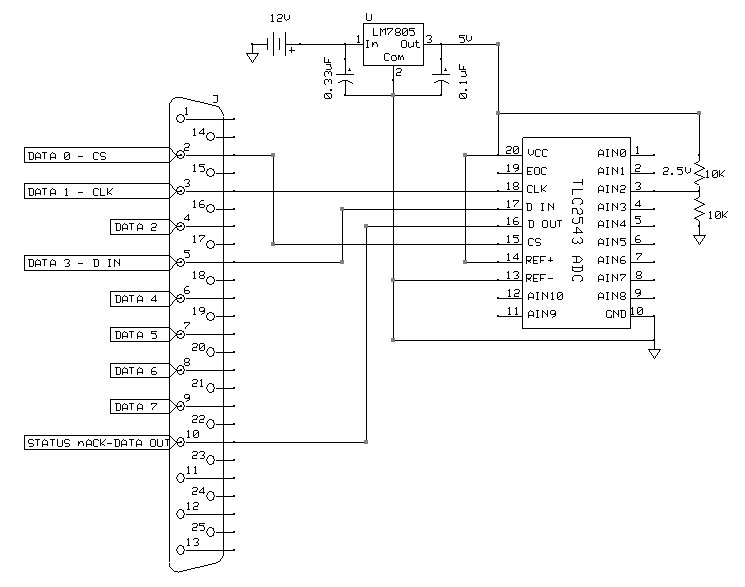

I'm using XP Pro and the same inpout32.dll. I've amended the code ( attached ) to include the declarations for the input/output functions so it should now work as is. Incidentally, I had changed the DB25 pin assignments slightly to accomodate the test code and as such I attach the resulting revised schematic. I can drive the TLC5628 DAC in a similar fashion and it works sweet, it's the TLC2543 ADC that's giving me headaches.! :( I can certainly get results back from the ADC but they are totally spurious readings! I thought at first it might be an input/ouput synchronisation issue, but I've revisted the code many times and can't see any problem. I also suspected that I might not be driving the ADC according to the datasheet, but again can't find anything that suggests I'm doing something wrong. If you've got some software to test I'd certainly appreciate trying it out!
Thanks,
Salvatore.

Looking at the ADC setup routine in 'ReadVoltage', if I am reading page #14 of the datasheet correctly, the setup is addressing AIN3. You appear to be using AIN0 as a 2.5Vref test value?.
Page #14 also states its an 8 bit function select byte, you are adding, 4 padout bits?
On page #12 of the datasheet, 'Principles of Operation' it again states its an 8 bit control data stream.
On page #9 it states that the data I/O is simultaneous, you are addressing and reading sequentially?
You appreciate that unless I have a device to test with your program, I have to take all my information from the datasheet.
The way I read the datasheet, you are not controlling it in the way it describes.
Regards.
Hi Eric,
Thank you for your patience! You are right in pointing out the mistake in the code I posted. In actual fact the code itself does not contain this error, it was introduced after cutting and pasting the code into Notepad and making a few adjustments to pretty it up..! Sorry! :rolleyes: To keep things as simple as possible, I have attached a shorter, clearer version of the code that uses AIN0 on which I have 2.5V. This equates to an actual instruction sequence of all 0's, so all I am effectively doing is sending CLK pulses to the ADC. On every call to ReadVoltage(), I have also added a bit of code to initialise the ADC according to the datasheet by taking CS temporarily HI and then LO again and then waiting a bit for the ADC to settle down.
In answer to your query about the 8-bit function select byte, the ADC allows 3 choices in terms of length of the instruction sent to it depending on the type of serial communications mechanism you are using, 8-bit, 12-bit( recommended as the ADC has a 12-bit resolution), and 16-bit ( see page #15 - Principles of Operation - data output length). The function select byte is 8 bits which in my case has to be padded to 12 bits. There is a timing diagram on page #9, figure 9 which is the control scenario I am trying to implement.
In answer to your other query about the ADC being simultaneous, yes it has been designed this way for fast operation. As you are sending an instruction, the result of the previous conversion is shifted out, so the desired result lags behind by one instruction sequence. In my code, I send the instruction twice, the first is the 'real' instruction, the second as a 'dummy' to get access to the result. Although not in the datasheet, the method I'm using is actually recommended in the manufacturers application notes if all you are interested in is 'one-shot' conversions. If you are trying to convert a fast continuously varying signal then the simultaneous method is obviously recommended for speed.
I've tested the attached code and am still getting spurious results as before.:( Not entirely sure where to go from here...
Thanks,
Salvatore.

Hi Eric,
Neat bit of code! :D I tried it and it does give me more stable results, either 0V or a value around 4.9V, but not the value of the input to AIN0 which is still 2.5V. I amended my own code to make it more streamline and I get the same results. What I did find interesting is that if I place any piece of code anywhere in the For..Next loop I start to get completely random results again! E.g.
For Rd = 0 To 11
' Add any code here.. e.g. Wait 0.001
V = Inp(STATUS) And 64
If V = 0 Then GoTo skip1
iADCValue = iADCValue + Ary(Rd)
skip1:
' ..or here.. e.g. DoEvents
Out DATA, 0 'ck=lo, cs=lo, dta=lo
Out DATA, 2 'ck=hi, cs=lo, dta=lo
' .. or here with this bit of code..
For n=0 to 100
Next
Next Rd
What's even more interesting is that if I reduce the extra loop to n=0 to 10 for example, I get back the more stable results as mentioned above...! :confused: This implies some sort of timing issue problem but I was under the impression that the ADC can be driven asychronously, as there is no mention in the datasheet of the need for any independent clock. I did come across this little snippet though, near the bottom of page #12 - Principles of Operation - Conversion Cycle:
"..The conversion cycle is transparent to the user, and it is controlled by an internal clock synchronized to I/O CLOCK..". How any internal clock can synchronise with an externally applied clock of indeterminate frequency I don't know.. Maybe it has no bearing on the problem... Hmmm..
Thanks again,
Salvatore.
