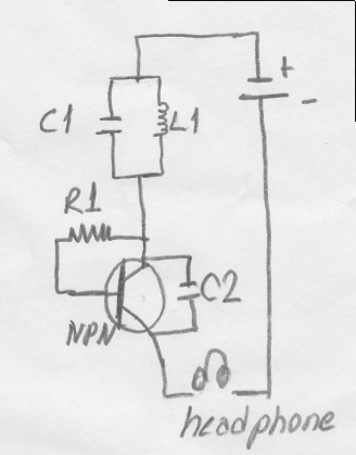

Hi everybody I'm new one
Firstly you must know that i don't know enough english
I'm trying build a simple oscillator and every time i'm fail.I'm very stubborn about this situation.
For example below oscillator circuit is very popular in simple rf tranmitters but i couldn't work it i don't know why
C1=1 uF
L1=3 mH
Transistor is NPN
R1=100 KΩ
C2= doesn't matter?only for feedback, isn't it?
Acording to my calculation oscillation must be about 3 KHz and if i add a headphone between emiter and negative side of power source i must hear the sound but no sound.Where is the wrong?

The circuit you're looking at is a VHF oscillator, I've never seen one used at audio frequencies, in fact you don't normally use inductors at all, as they are MUCH too large. If you need sinewaves, try phase-shift or wein bridge oscillators.
Thanks already my purpose is creating high frequency but firstly i must sure that is it working? for this reason i'm making my calculation acording to can hear frequency if it works i will change capacitor value so frequency will rise but anymore i know that
Well , Does my circuit design work???
I wouldn't have thought so, it's fine at VHF, but as I said I've never seen one attempted at audio.

Hmm.. thanks i changed my opinion but i'm still undecided.I exemined many circuit but i couldn't see any different between they and my design.for example i rised the frequency to 290 Khz and there is no sound in am radio.
I've already told you TWICE, such designs are used in VHF oscillators, NOT in audio, and NOT in LF oscillators.
It 'may' be possible to get it to work, by very careful design of the tuned circuit, the feedback capacitor, and the resistor values - but presumably there's good reason you never see it used at low frequencies? - for VHF use it's dead simple to get working.
Perhaps you would care to tell us what you're trying to do?, and we could suggest suitable oscillator types?.

Two potential problems with the circuit. First is resistance in a 3 mH coil along with associated low Q resonating it with a 1 uF may result is not enough loop gain for oscillation.
Second, is headset resistance may also reduce loop gain below point needed for oscillation.
A multi-section R-C phase shift oscillator is easiest for sinewave output. It is important for a sinewave oscillator that transistor does not go into large signal swing saturation.
If you are doing this for proof of concept for a higher frequency RF oscillator you won't be proving much since the component Q's, and transistor gain will be so different.
I'm trying listen it in LW band.It is 150-340 KHz.This time i understood i want to make a simple transmitter (amplitude modulation).Many simple transmitters includes only oscillator and mic. input isn't it?Can you tell me what must be the values of components to work it?
By the way i'm using this for calculation.
Use the values in the designs you've seen - which ALL work at VHF - you can't just use it down at longwave, where FM would be useless anyway, and the AM modulation provided is only a tiny amount.
